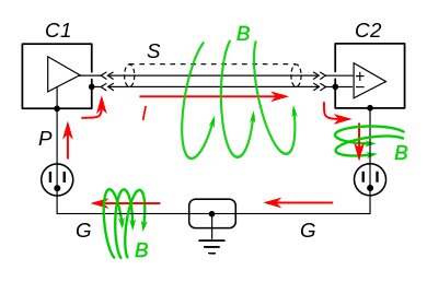

It's Douglas Self's schematic. After that:
Consider, if you will, the points circled in red. These are mechanically different points, but electrically the same point (disregarding conductor resistance).
Making these connections forms the chassis and cable shield (screen) into a continuous shield around the audio circuit and all associated conductors. No gaps, no breaks, a continuous shield, all electrically the same point.
Consider next the circuits that precede and/or follow the shown circuit. Assume (or hope) that these are similarly connected, and therefore similarly shielded.
The result is an unbroken shield around all circuits and all conductors, all electrically the same point.
Now consider the small green triangle. This is the building's grounding system, which really is ground. It's ultimately a ten-foot rod driven into the earth (planet earth) near the building's electric meter.
If you'll imagine this, perhaps you'll see that every audio chassis in a building, and every audio cable shield, is ultimately connected to the same mechanical point--the grounding rod--and that all are electrically the same point (still disregarding conductor resistance).
These are some real-world facts that I thought might be of interest.
(Just to mention it, the building next door has a similar grounding system connected to a grounding rod, and so does the one after that, and the one after that. In fact, all the buildings in the world have a similar grounding rod. This is mandated by all electrical codes, there's an international committee.)

Bentsnake I like your up scaling of the problem. What would happen if you measure the voltage between your ground and your neighbours ground, to add a little reality to the problem we will do the measuring up in the attics of each house.
I've actually done this, and observed voltage differences up to 15 volts. The reason it was so high is because there was a defective (but still operational) old refrigerator plugged in down in one of the basements.
Try it, and you will almost certainly observe at least a small voltage drop between two residences.

You're correct, there might well be a voltage difference between different points on mother earth. Just to mention it for fun, this especially applies to islands, due to the conductivity of salt water. People who live in Key West, for instance, are literally living on a battery.
