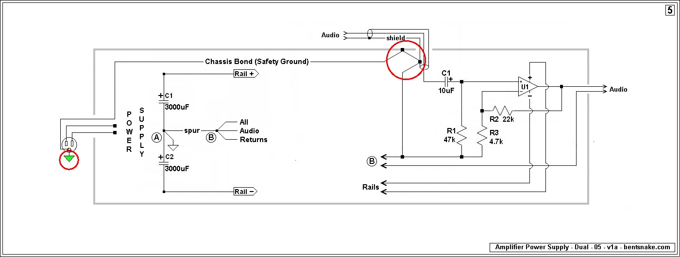

Confused over various grounding methods and designs
<< I should connect ground between A and B, not at A. >>
Then what, if anything, would you connect to point A? If you don't connect anything, then the new connection just becomes a new point A, and everything remains the same.
The schematics you show is fig 25.1 of Douglas Self's book on power amplifier design. I do not see a connection to ground near the star point.
I would have liked the metal box to be drawn.

The grounding method I offer is based heavily on one recommended by Douglas Self (with others). I post Mr. Self's method for the 10,000th time around here, on the off chance that somebody might look at it this time.
I know Self's articles on amps since day one and I may say this is an area where he is not very precise.
Anyway, I do not see a plain similarity between his ground scheme and yours.
I wonder whether you're offering your method as an alternative to mine, or insisting that yours is the only correct method of grounding?
No, it is not a competition. What I try to express is that a kind of "philosophy" should precede the exposition of the methods.

The green highlighting is intended to show that the two plans are essentially the same. I'm very interested that you don't see this.
Would you please actually state where you see that the plans differ? Just "I don't see it" is not tremendously helpful.
This is, after all, a help forum. It's not a competition.

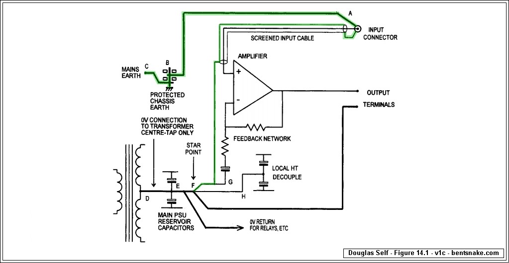

BTW I figured out the feedback problem I had. My own stupidity forgot to wire the filter capacitor directly to the chip pin and star ground. Instead I had it taking a longer path.
So that is one bug down. All feedback is gone now along with major hum issues but I am still learning which method is best to go by for mounting inputs/output to chassis either bonding the jacks or not, and so on.
Lot of reading up to do.
So far so good!
468609d1425064555-confused-over-various-grounding-methods-designs-douglas-self-figure-14-1-v1c.jpg
Sorry if I am not following along that well at the moment but am I correct in assuming this is close to, if not the proper way, to ground as bentsnake posted?...
I tested this method earlier today and it did indeed work well and reduced all hum, but just double checking.
If this is the correct way, then I am assuming the input jack can be bonded electrically right to the chassis so that then chassis gets its ground right where the input jack and the input ac ground wire are correct?
If this is proper, then this will work out nicely since the jacks I want to use for guitar inputs happen to have metal outside sleeves so they can be grounded/bonded right to the chassis.

The grounding scheme shown in post #32 of this thread (and other posts) is from Douglas Self's "Audio Amplifier Design Handbook," illustration 14.1 on page 402.
The green highlighting is added by me simply for clarity--or anyway I hoped to achieve that. Green is used because electricians say, "Green is ground the world around." But I made no changes to Mr. Self's scheme, not one, none.
That same section discusses grounding and shielding in some detail. Very informative, I think, for those who are willing to learn.
One of the problems with bentsnake's schematic is that it does not work well when you have two or more channels. When you are trying to build a low distortion audio amp it is not the way to go.
the screen is actually the signal return of a TWO wire connection.
As such that screen MUST connect to the Signal Return pad provided on the amplifier PCB.
Now the safety problem.
As shown by D.Self the screen and the two ends where it connects to the chassis and where it to the Main Audio Ground (MAG) will have to pass Fault Current to the Protective Earth if there is a catastrophic failure inside the amplifier.
Can the screen and the two pigtails pass that Fault Current?
But it gets worse. When the two channel amplifier invokes the correct screen connection to the two PCB signal return pads and the traces to reference those pads to MAG, will the soldered connection and the trace pass Fault Current?
Leach has an option to use the Signal input terminal as the local connection to Chassis. He then places on the PCB a Disconnecting Network in the reference trace to MAG (if I remember correctly he suggests a 10r resistor between Signal Return and Power Ground as the low impedance reference connection). Leach then connects MAG to Chassis so that Fault Current can pass to the Protective Earth safely.
Bent can't see this because he does not understand what he is looking at.
He does not understand that EVERY Circuit must have a Route through which current from the Source, arrives at the device and leaves to Return to the Source.
There are no exceptions. EVERY circuit MUST be connected with a TWO WIRE assembly of a size and type appropriate to the signals that need to pass around that connection.
It's Douglas Self's schematic. After that:
Consider, if you will, the points circled in red. These are mechanically different points, but electrically the same point (disregarding conductor resistance).
Making these connections forms the chassis and cable shield (screen) into a continuous shield around the audio circuit and all associated conductors. No gaps, no breaks, a continuous shield, all electrically the same point.
Consider next the circuits that precede and/or follow the shown circuit. Assume (or hope) that these are similarly connected, and therefore similarly shielded.
The result is an unbroken shield around all circuits and all conductors, all electrically the same point.
Now consider the small green triangle. This is the building's grounding system, which really is ground. It's ultimately a ten-foot rod driven into the earth (planet earth) near the building's electric meter.
If you'll imagine this, perhaps you'll see that every audio chassis in a building, and every audio cable shield, is ultimately connected to the same mechanical point--the grounding rod--and that all are electrically the same point (still disregarding conductor resistance).
These are some real-world facts that I thought might be of interest.
