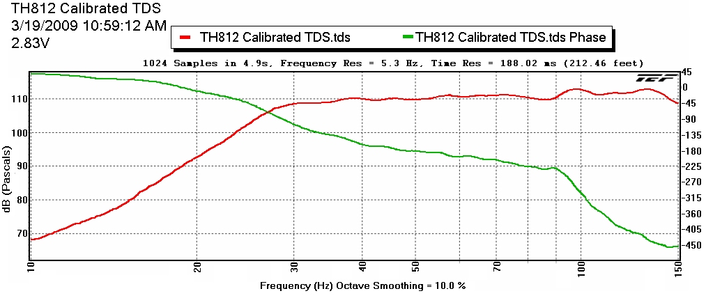

...and here's the response of Danley's TH812, which looks even smoother than that. So I'm not seeing the point you're trying to make with your sweeping generalization about his THs.
Yeah, it says right on it 10 percent smoothing, it's a wide and short graph (very unlike Hornresp's tall and narrow graph) with 10 db between the lines (crunched down to look smooth) and it may have stuffing in it too. Sim the cab and it won't look nearly that smooth.

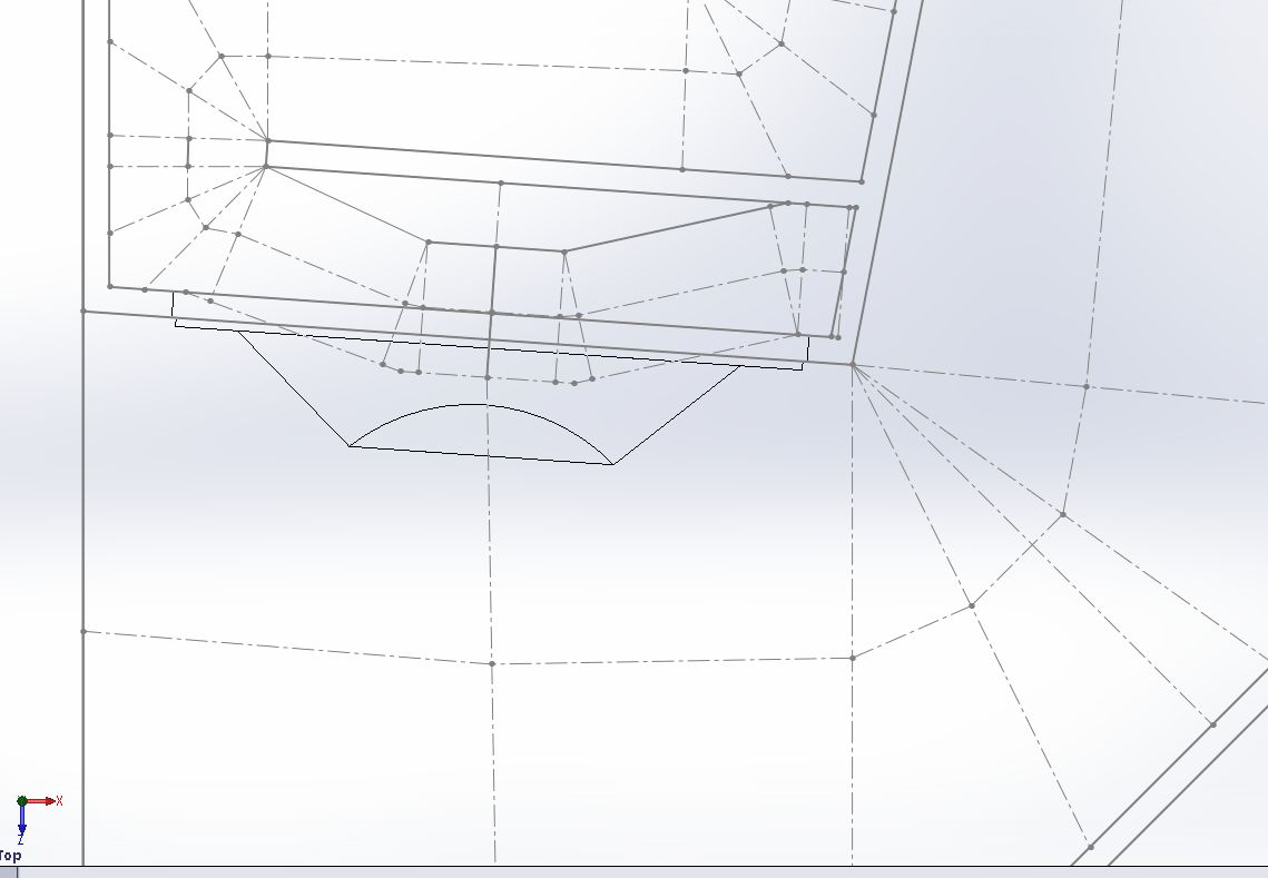

When developing this concept, I modelled a speaker cone volume in 3D CAD and added the volume of the baffle cut out. I then took incremental cross sections of this volume to find the cross sectional area at differing points along the speaker path.

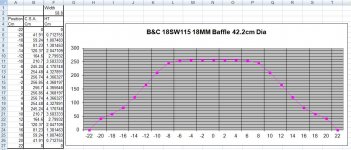

The data was entered into a spreadsheet. It was immediately apparent that over the centre section of the speaker that this cross sectional area does not vary by much - the curve has a virtually flat bottom.
The cross sectional areas were then divided by the internal width of the speaker to derive the final heights for the 'Cone Correction'
This cone correction curve is finally simplified and plotted along the line of the speaker baffle edge. The cone correction curve is then assumed to be the line of the speaker throat path, replacing the inner edge of the speaker mounting baffle.
The internal baffle is then modified to accommodate the cone correction curve taking account of the required horn shape. As such there is no attempt made to mimic the shape of the speaker cone, but just to account for the varying cross sectional area along the speaker path.

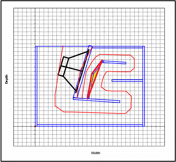

The layout of the TH115/8 suggests however that there's a lot more than "cone compensation" going on. The amount of "compensation" seems to be 2 to 3 times the amount actually required. This suggests that there's another purpose to it.
I tried to include cone compensation in my POC4 design, splitting that section of the horn into two, rather than three parts as in the TH115 and TH118. I ended up with good results, but went around the wrong way of doing it, LOL. I just looked at the CSA through the center of the driver and decreased the CSA @ S2 to compensate. What I should have really looked at was the volume of air in the cone and decreased the volume across S2 accordingly. Oh well, I'll adjust the design spreadsheet accordingly to look at the volume and use that to calculate the corresponding change in CSA @ S2.

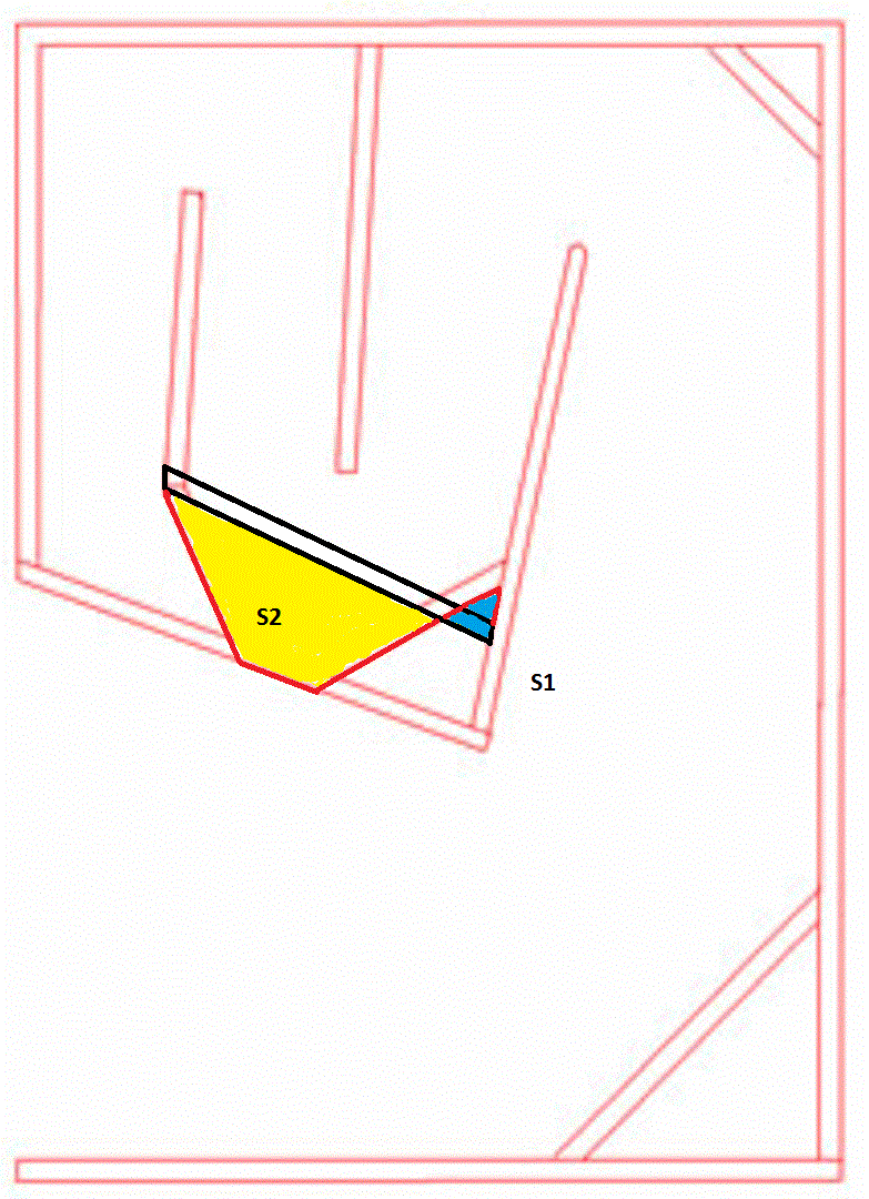

To illustrate this, see diagram below, where I've compared what's known about the TH115's layout to a TH with no "cone compensation". The yellow section is where the volume @S2 has been decreased. There's also a small *increase* in volume @S1, which I suspect is was just done to avoid having to add an additional panel.
I estimate the decrease @ S2 at around 12 liters, which is over double what I'd expect if it was just for "cone compensation" for a 15" driver. And I don't believe it can be emulated in HornResp, as HornResp does not allow you to "pinch" the horn like that in a sim. If you try to decrease S2 in HornResp in an attempt to emulate the pinch, you'll affect the expansion of the horn all the way up to S3, which significantly changes its layout.
Again, my suggestion is that "cone compensation" was not even on his mind when he drew this up. There are SIGNIFICANT benefits to this layout, it allows for a LOT more path length in the same box volume, so with clear advantages that have nothing to do with "cone correction" there's no need to jump to the assumption that "cone correction" was a factor in this layout at all. And again, there's no "cone correction" in any of his other designs, so assuming that he consciously intended to do it in this design is a bit of a leap.
Sure, Hornresp can do this just fine. Shove the driver all the way right so S1 is at the edge of the driver, then S2 is at the middle of the driver and put S3 right at the end of the driver. That uses up most of your segments in the first few inches of the horn, but Hornresp can do it.
If you need more segments export to Akabak and continue. It's a pain but it isn't difficult and unfortunately I have to do it quite a bit to get high degrees of accuracy in sims.
If you do it that way, it looks like there's a change in expansion between S3 and S4 in the TH115 that won't be reflected in the sim. Have another look at the layout in the diagram.
