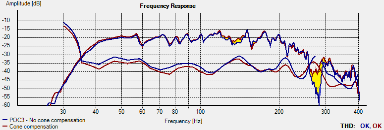

I took a lot of steps to ensure the measurement conditions were exactly the same before and after inserting the cone correction, including all measurement levels and the position of both the TH and the microphone. The only thing out of my control was temperature - the first measurement was done just after mid-day, the last one in the afternoon, when it might have been a bit cooler.

I don't. I performed the second measurement a few times, because the decrease in distortion did take my by surprise. The question really is what is contributing to the difference? Maybe the extra stiffness at S1 caused by the "cone correction" triangle being screwed into the panel opposite the speaker?
The thing here is that the decrease in distortion is broadband, which has piqued my curiosity. I've seen differences in my distortion measurements before, but they've usually been over small bandwidths and turned out to be caused by simple things, like standing the TH on an uneven floor for example (the bottom panel seems to contribute a bit - I'll be addressing that with a minor "upgrade" to the design in the future - extra bracing to the bottom panel at its point of maximum flex to increase its stiffness).

Nope, and in any case the measurement process I used is actually pretty impervious to background ambient noise. When I was measuring POC4 for example, it was in the club while I was doing so and there were salsa dancing lessons going on nearby. The measurements I took during that time were quite repeatable, quite likely because it's a close-miked measurement.
Strengthening the panel is one, as you pointed out, noise floor is another. Are you sure you did a fairly major surgury on the sub and put the sub and mic back in EXACTLY the same spot? Are you suggesting that you measurements (including the environment you measured in) are infallible?
Yes 🙂. The room is tiled, and it was pretty simple to line up the front of the sub with a specific tile so it was in exactly the same spot for both measurements. The mic was left in place during the "surgery", so it didn't move either. And all of the electronics were left on and running for some time before the first measurement and until the second one was completed.
In any case, I'm just going to treat it as a curiosity for the moment. I don't have another TH around to check to see if the decrease in distortion happens with it as well when cone compensation is added at S2.

The only thing that changed during the tests was (1) the inclusion of the "cone compensation" and (2) the temperature. I did have to unscrew the driver to insert the cone compensation, so maybe it's screwed in slightly differently too. Everything else was basically identical for both tests.
I understand the minimal changes to DUT but was asking about the accuracy and repeatability of the measurements itself.

I did the second measurement a few times (HolmImpulse allows the comparison of three measurements at a time). There was little or no noticeable difference. The method I use for FR measurements usually results in very repeatable results, once the position of the DUT does not change.
Yes, even screwing the driver in differently (maybe a bit tighter) can cause these changes, along with a few dozen other things. If you didn't measure the noise floor you can't rule that out by just saying it didn't change.
Listen, this is a good experiment, but realistically it's only a single data point. If you can repeat these results a couple dozen times then maybe there's something to this. But I seriously doubt it, not distortion reduction at 30 hz.

For you to draw a conclusion that the "noise floor" could affect my measurements, you'd have to know the details about how I performed those measurements. As you don't have this information, I think I'll take my own counsel on whether or not the "noise floor" had any significance ;-).
FWIW, here are the relevant details:
1. HolmImpulse configured to use a swept sine wave as the test signal.
2. Mic placed 18" from the sub (basically the width of one tile).
3. Amp's DSP engaged to remove any significant response peaks from 40 Hz to 200 Hz.
3. Volume increased on the sub until HolmImpulse indicated clipping during measurements, then volume was backed off a few dB.
With that setup, you could be banging away on drums in the same room and it wouldn't register in the measurements. It certainly wouldn't produce a broadband decrease in measured distortion between tests.

I'd say I've confirmed HornResp can approximate cone compensation, and I may have discovered a "possible improvement" as a side issue. Can't draw that sort of latter conclusion based on just one test.
I think I'm going to try a full-on "pinch" at S2 for my next test, i.e. perhaps double-up on the cone compensation. Unfortunately the results of that can't be predicted by HornResp.

Im not seeing this confirmation in post 8, I need more magnification on my monitor
you said the new improved model predicts slightly less output at the low end and 2-3 dB more at the upper end ~120-150 Hz
but your test results shows improvement at both ends? +/-1 or 2 dB is tough territory on accuracy of most any measurements esp acoustics
Im not seeing this confirmation in post 8, I need more magnification on my monitor![]()
LOL - it's the scale that's the issue. The improvement is around 2~3dB around 120-150 Hz, and a significantly greater impact around 280 Hz, both of which show up in the HornResp approximation. I've highlighted the areas in question in the attached image.
There's a minor change at the lower end. I wouldn't jump the conclusion yet that it's an improvement. It might be as a result of screwing in the driver more tightly, or even a change in temperature, for example 🙂
