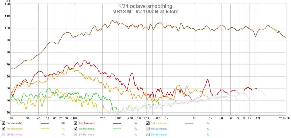

The H3 that peaks at roughly -25 dB (probably worse at the output level in the SoundStage measurements) is at 3 kHz and already sufficiently attenuated by the filter slope, but this is just distortion that is happening outside of the passband. Of course if you don't feed signal to a driver where it performs poorly, it won't perform poorly. But what we're talking about is the sub-multiple (fractional?) distortion amplification that takes place in the passband, which is 9 kHz / 2 = 4.5 kHz H2 (outside passband and therefore irrelevant to our conversation), 9/3 = 3 kHz H3 (similarly out of band), 9/4 = 2.25 kHz (in-band), and 9/5 = 1.8 kHz (in-band).1) That's 45db down relative to 95db/2m anechoic, which is different than the typical 90db/1m. I'm sure you understand that. The higher the fundamental, the higher the hd is relative to that fundamental.
2) That driver has a 3rd order peak that's only down 26 db from the fundamental at 3khz. If what your saying is true, wouldn't it be very pronounced in the soundstage measurements if the dsp crossover had no effect on hd peaks?
As a counter-point, if you look at the H5 peak around -50 dB around 1.8 kHz, I would expect it to be present at the same level (unless there actually is a passive parallel notch in the speaker) since it's within the passband but pretty hard to tell since it's just below the cutoff. There is a bit of a rise in visible THD starting around 2 kHz in the SoundStage measurements but I'm guessing that's from the H3 right before the low-pass filter kicks in.

This h5 1k hz and h4 1.4k hz peaks don't also show poor IMD there as Zaph seems to suggest in the reading methodology of his measurements ?
Which suggests to cut-off below 1k hz with something stiff, LR4 for instance ? (LR2 ?)
I also don't understand why he says to cut as high the W17 little brother as well ?

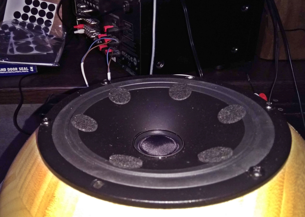

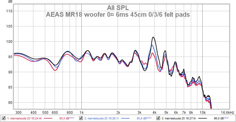

In a project I used felt pads to tame polycone's resonance. Sorry I didn't save these measurements, so distortion profile change is a mystery...

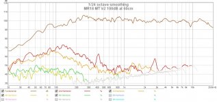

https://www.diyaudio.com/forums/multi-way/322839-seas-mr18-3-a-3.html#post5612476
