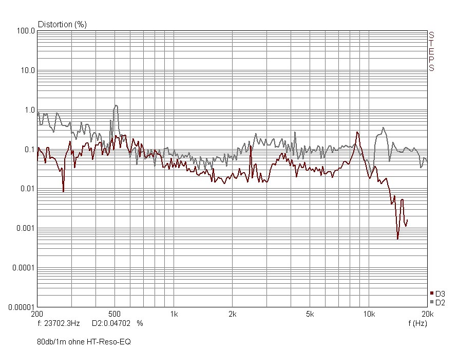

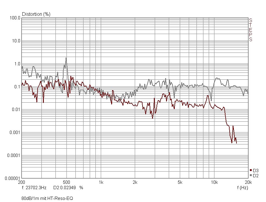

For the sake of interest, here's an example of the effect of filtering (aka attenuating) stopband modes on HD lower down. This is the measured HD of the Tafal standmount speaker design, before and after the tweeter's ultrasonic breakup mode (about 26.5KHz) is suppressed in the filter.

I would conjecture that the reduction in HD on the filtered system is because the distortion measurement was done with a broad-spectrum signal as opposed to a sine sweep. Note that the peaks still appear in the filtered graph (which is strange since you would expect the ringing to be fully botched out) which I suspect is the “actual” distortion you would see with a sine sweep, whereas the worse distortion in the unfiltered graph could be a result of some synergistic effect from the already-breaking-up diaphragmFor the sake of interest, here's an example of the effect of filtering (aka attenuating) stopband modes on HD lower down. This is the measured HD of the Tafal standmount speaker design, before and after the tweeter's ultrasonic breakup mode (about 26.5KHz) is suppressed in the filter.

I wouldn't 'expect' that: it depends exactly what is being done. Either way, you have data there, giving one example of what can happen; meanwhile Accuton (to give one example) have been known to present HD data with & without filters, so there is nothing here that is news or hasn't been discussed on this forum & elsewhere on many occasions.
