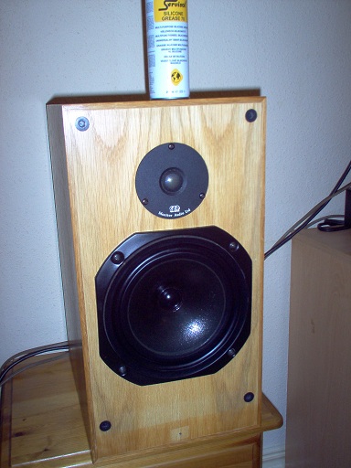

I have a few ideas about cone breakup and tweeters.
8" cones tend to go to Hell around 3kHz. 5" cones around 7kHz. Do the Maths.

So was it unusually benign cone characteristics or sufficient filters that let some classic British designs cross at 4k and 4.5K?
Combination of ignorance, budget constraints and lack of tools/engineering.So was it unusually benign cone characteristics or sufficient filters that let some classic British designs cross at 4k and 4.5K?
