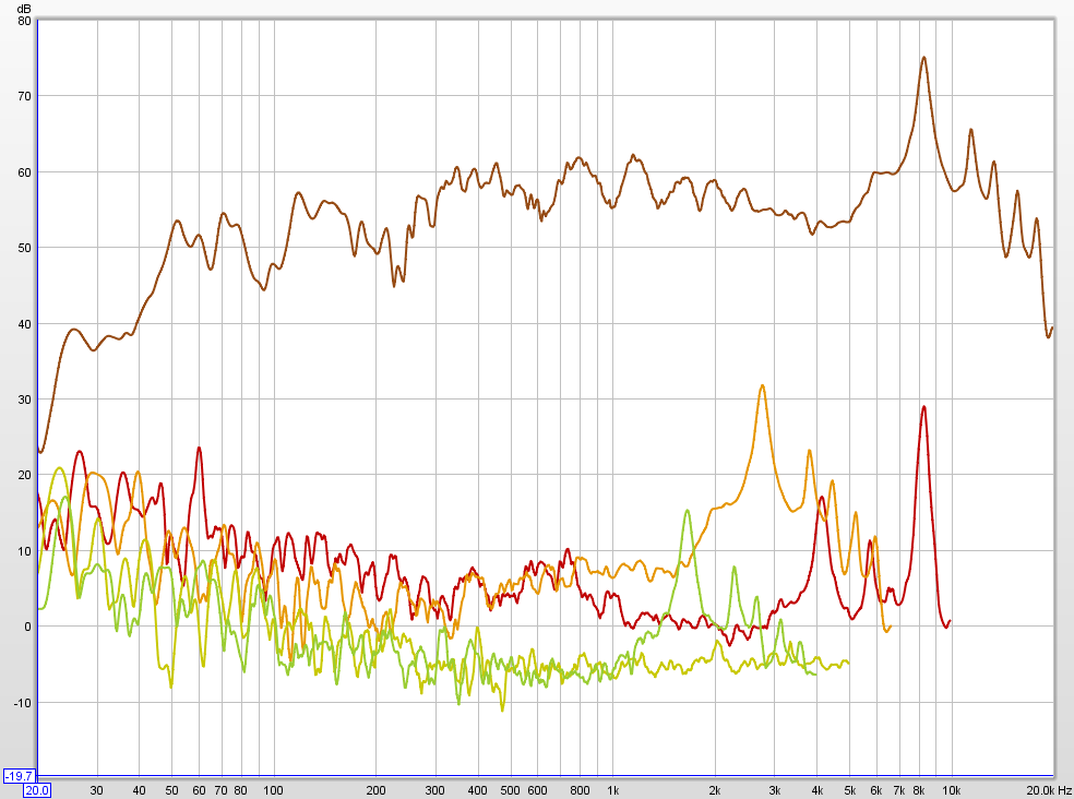

No rocket science contained in this post 🙂 First image is a raw Seas L15 aluminium cone driver with primary breakup ~ 8100Hz.

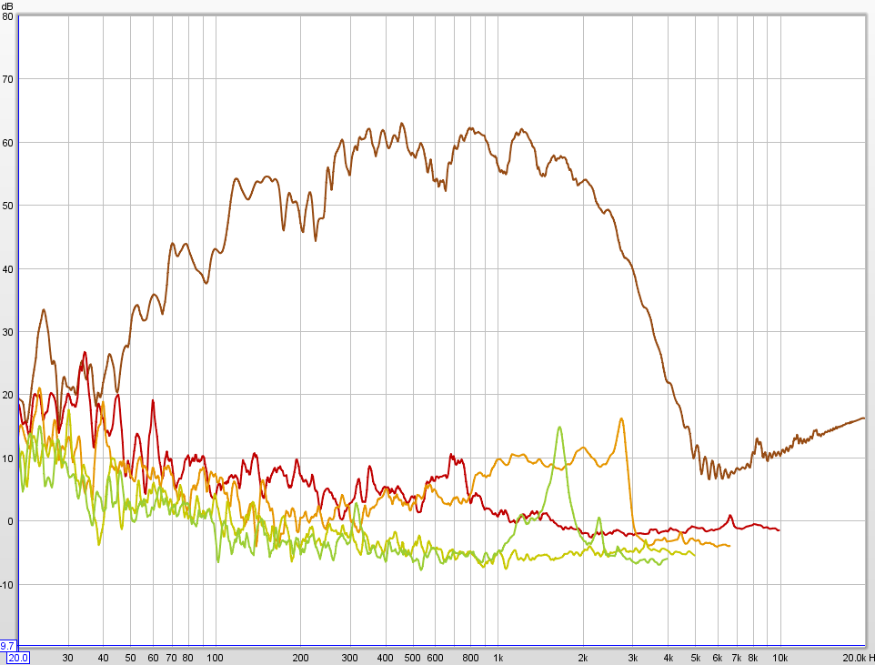

2nd image is with a steep order XO @ 2,300Hz with a notch filter on the breakup. You can see the 3rd order is somewhat attenuated, but there is little / no change on 5th order HD since the XO cuts above the 5th order distortion

Thank you. A notch, a steep slope, and still no attenuation of the 5th. Wow, I learned something new today🙂

Thanks for the data!No rocket science contained in this post 🙂 First image is a raw Seas L15 aluminium cone driver with primary breakup ~ 8100Hz.
Out of curiosity, without the XO, how much would the notch have cut down from the response peak and how broad is the notch (dB/Q)?
The notch was series and was bottomless (no resistor) - so very narrow / high Q. I think I might have the transfer function somewhere. If I can find it, I'll post it. I did not do a "notch only" measurement to see how much effect a notch has alone. This would be interesting. Sadly - the speaker is complete and everything soldered up, so I don't feel like a deconstruction to find out.
All measurements were done in box with "lazy REW" use - i.e. no fancy impulse gating or anything.
