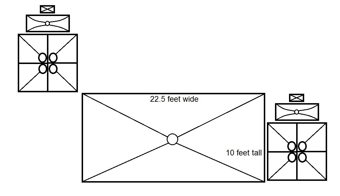

Can you please elaborate (provide your two cents) on post 588, 592, and 593? The half-space plane is parallel to my horn (aka the ground), and specifically not perpendicular to it. If hornresp assumes my bass horn is shooting directly into the sky, then this will not work for me. The only part of my horn that is perpendicular with a half-space plane, is the relatively small wall that the horn’s built into. Should I be building a full-space horn?

As for the drawing in post 588, I can't see it in 3d and since it's not to scale I can't tell if you have parallel walls of if all 4 (or all 3 in the second case) walls are expanding. Assuming there are no parallel walls, I don't see any practical difference, the slight bend in the second example isn't going to do anything at all at subwoofer frequencies and these two examples should be pretty much functionally identical. I would think the second one (the one with the flat bottom) would be a whole lot easier to build though.
So I'm picturing myself building some kick horns (80 Hz cutoff), built around (qty 4) 15" drivers.
As I've stated a few times before, I'm not convinced separate kick horns are necessary.
