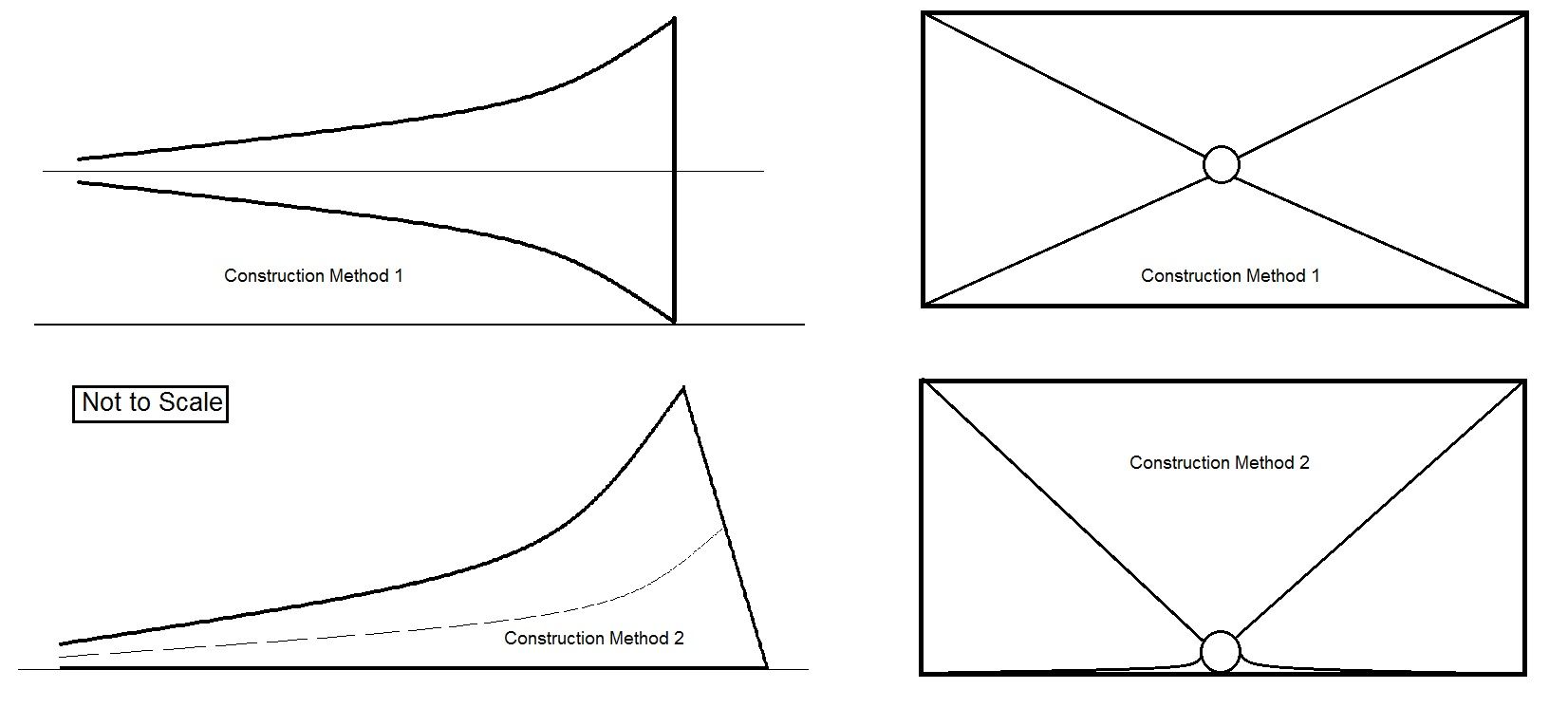

Can you please elaborate (provide your two cents) on post 588, 592, and 593? The half-space plane is parallel to my horn (aka the ground), and specifically not perpendicular to it. If hornresp assumes my bass horn is shooting directly into the sky, then this will not work for me. The only part of my horn that is perpendicular with a half-space plane, is the relatively small wall that the horn’s built into. Should I be building a full-space horn?

If you use construction method 2 you should still have a vertical horn mouth. Just model accordingly, Hornresp takes care of the "horn bubble" and the radiation angle consideration for you.
How many drivers enter at a common throat will determine the throat geometry. If each driver couples to, e.g.: an 8ft long conical initial section (wood?), there is no reason to make the subwoofer horn throat anything but square. The overall horn shape should be hypex, it can be composed of individual conical (straight sided pyramids) segments. Obviously, you need to design for optimum throat chamber volume, and take cancellations into consideration. Things change a bit when you are talking about the mid-bass horn, here a phase plug will be necessary.
Hornresp assumes the sound source(s) are flush mounted with the Ang boundaries. The Ang boundaries in Hornresp are also assumed to be infinitely sized, so it's a perfect reflection at all frequencies.
So for full space there's no reflective boundaries anywhere near the speaker. In 2 pi the sound source (horn mouth) is flush mount with the single boundary (buried in the ground pointing up). In 1 pi the horn mouth would be directly at the junction of the floor and wall boundary (which isn't actually even possible, as the horn mouth surface area is flat and that wall/floor junction is a 90 degree angle). With 0.5 pi the sound source is located at the junction of the two walls and the floor (which also isn't possible for the same reason).
This doesn't mean the sim is useless, it's usually more than enough information to work with. But it doesn't accurately reflect cases where the sound source is placed a significant distance away from the boundary. If you want to get a good handle on the particular situation where the sound source is NOT flushed mounted in the boundary, or if the boundary is less than infinitely large, you need to use different software to get a picture of that, like I showed.
As the boundary sim shows, if the wavelength is long compared to the boundary then the boundary doesn't provide a reflection, the wave wraps around the boundary and a good portion of it goes backwards. When the boundary is sufficiently large compared to the wavelength, the wave can't wrap around it and all of it gets reflected forward, so you get +6db in the forward axis and nothing wraps around and goes backward. That's the boundary size issue summed up.
Then there's Allison effect. This is effect you get when you put a sound source in front of a boundary instead of flush mounting it on the boundary. When the wavelength is long compared to the distance from the center of the sound source to the boundary the reflection is pure and you get +6db. Remember, sound sources that are within a 1/4 wavelength of each other sum perfectly for +6db, and a reflection is a sound source. But when the distance from center of the sound source to the boundary is shorter you get a notch in response, notches are usually a 1/2 wave phenomenon. This is because of wavelengths and distances. (It's always wavelengths and distances.) With the shorter wavelengths in relation to reflection distance (higher frequencies) the sound that comes direct from the sound source arrives before the reflection because the reflection has to travel farther than the direct wave. When the direct and reflected sound sources meet at the listening position they are out of phase so you get a notch at certain frequencies.
So Hornresp is assuming that the Ang boundaries are infinitely large and Hornresp doesn't bother with Allison effect because it always assumes the sound source(s) are flush mounted, in which case there is no Allison effect. That doesn't make the Hornresp sims useless, just not complete when these two conditions are different than what Hornresp assumes.
In the case of the big sub horn, the ground is infinitely large, so no problem there, a 2 pi sim is good to go, at least at the lower frequencies. But the sim won't show Allison effect notches because Hornresp assumes the horn mouth is flush mounted into the ground and it won't show the effect of barn doors unless you simulate them as baffle diffraction. If the barn doors were infinitely large you could just change the sim to 1 pi, but they are not that big (and you still wouldn't see the Allison effect notches due to the center of the horn mouth to floor distance).
To answer your question specifically, no you should not be building a full space sub horn (unless you want to, it won't hurt, it will actually be a bit better because bigger is almost always better but way past the point of diminishing returns).
If you design a 2 pi horn and use it in a 2 pi environment the sim will be accurate as far as the simulator's assumptions go. But the sim won't include Allison effect notches and it won't include the effect of shifting from 2 pi to full space as frequency increases because the sim assumes it's flush mounted and your physical horn is not.
As for the mid horns, I forgot about the barn door. This is a boundary for the midbass horn (in addition to the ground boundary), and size of the barn door and whether the midbass horn is flush mounted into the barn door or not will affect the Allison effect notches and the transition from 1 pi to 2 pi.
As for the drawing in post 588, I can't see it in 3d and since it's not to scale I can't tell if you have parallel walls of if all 4 (or all 3 in the second case) walls are expanding. Assuming there are no parallel walls, I don't see any practical difference, the slight bend in the second example isn't going to do anything at all at subwoofer frequencies and these two examples should be pretty much functionally identical. I would think the second one (the one with the flat bottom) would be a whole lot easier to build though.
Question - does a half-space horn have to be physically coupled to the half-space plane, to achieve ideal performance? My bass horn's mouth will specifically NOT be flush with the ground (i.e. earth joined around the whole circumference of the mouth - with the horn perpendicular & pointing into the sky)
Here's a problem: only one rectangular mouth edge will be flush with the half-space plane, and my horn is going to be parallel with the plane (90 degrees from optimum). Will this negatively impact the impedance coupling with the ground?
What if my horn had a round mouth, and were only touching the half-space plane via tangent point? Would the impedance coupling with the half-space plane be further degraded. One would think the coupling would be less than ideal, right? Or are bass horns in half-space a bit like horseshoes, hand grenades, and nuclear weapons - - - where close counts?

DISTANCES AND WAVELENGTHS. I just got done giving a very in depth answer. TB46 essentially said exactly the same thing.
When the wavelength is long compared to the distance to the boundary they will couple fully (+6db). This is because sound sources within 1/4 wavelength of each other act as a single sound source.
When the wavelength is shorter problems happen. This is because of the triangulated distance between the sound source, the reflection and the listener. If the listener is equidistant to both sound sources all is fine. When the listener is not equidistant to both sound sources one source arrives before the other and they will be somewhat or completely out of phase. Completely out of phase usually happens at 1/2 wavelength and provides a deep notch.
Maybe you've heard of floor bounce and maybe you've heard people talking about placing absorbtion in their rooms at the primary reflection points. This is because of the Allison effect and it's what the Bagby spreadsheet shows very clearly.
Because your horn mouth is so large, it can't be within a 1/4 wavelength of the primary boundary (the ground) at frequencies at the top of it's passband. So you can pretty much count on a little floor bounce. There's not a whole lot you can do about that.
This is not a deal breaker, if it was horns like this would not exist.
https://mniec.files.wordpress.com/2012/11/320x.jpg?w=320&h=239[/quote]
Forget the horn mouth shape. Ideally you would make it as close to a perfect hemisphere as possible and the ground would mirror image the other half (as well as it can, you still have Allison effect) but the difference between half round, round, square or rectangular comes down to distances and wavelengths. (There's also differences in other things too, like directivity and frequency response if you aspect ratio gets really high but let's ignore that for now.)

Eric,1) My bass horn could do surprisingly well up to 300 Hz (I don't know - I've never heard one before.)
2)The reason I want kick horns, is because I will lose all stereo separation in the business end of my music (80 to 300 Hz), if I cross my bass horn at 300 Hz. Even if I cross at 160 Hz, I'll still lose an entire octave of "kick" stereo separation. Is this really a problem?
3) I don't know. I am a little disappointed that my "no-compromise" horn system will ultimately be loaded with compromise.
4)My thought was that I'd build my mono bass horn out of concrete, then I'd build some 80 Hz stereo mid-bass horns out of wood, and simply listen to it. Adjusting the crossover frequency is a simple electronic adjustment. Believe me - if a crossover point of 300 Hz sounds best, that is absolutely where I will set the system.
5)I fully anticipate having to construct several iterations of mid-bass horns before I find the sound I'm happy with. If I only need 160 Hz mid-bass horns, that's all the larger I'm going to build them. . .
This "tread" continues to amuse me.
1)Yes it could. Do you want to hear the low end of vocals and instruments "walk" with their pitch (frequency/note) around your bass horn and upper reproducers located in different L/R directions? I certainly would not, but just one opinion, just like a-holes, we all have one.
2) Christ on a Stick, you are just not listening, and have not listened to the problems associated with large scale audio reproduction.
3) Welcome to the real world 🙂 .
4) "Sounds Best" for what genre? See response #2, for the real sh#t.
5) Good for you, if you construct several iterations of mid-bass horns before you find the sound you are happy with, and do it at the rate of folks that actually get paid for what they do, you could achieve your goals in another decade or so, if you are able to separate the wheat from the chaff 🙂.

I don't think I am. A straight full size 20 Hz horn, or half of one on the ground, is one of the holy grails of audio possession. Fortunately this system will not have to deal with indoor boundaries or substantial reflected energy.
For rock the LF energy level / hump will have to extend to about 250Hz and that will require substantial attention to properly ballance and sound right as well.
I get that this is DIY but, a single DSL TH812 box will best an eight stack of Labs (which are a pain in the balls to build anyway so you can have em!) and a single TH221 or pair of BC218's would likely be all that is needed to fully satisfy the 20Hz desires but, again I get that anyone can just go buy it.
