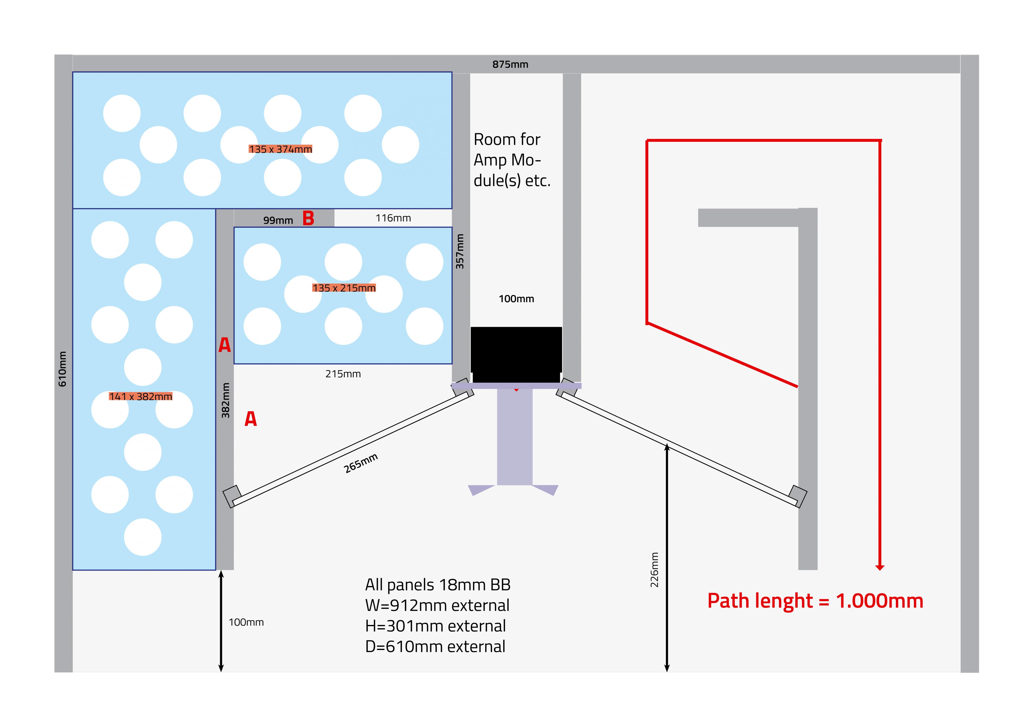

In my design, the 15cm don't go to the front of the enclosure, but to the front end of the panel forming the horn mouth.

If you have the mic and software for measuring it would be really interesting to see how the waveguide recess depth affects the general response of the cabinet ....... Three measurements would be awesome, 1=All the way recessed , 2=Halfway recessed as shown in your sketch, and 3=all the way forward having the waveguide's mouth flush with the front of the cabinet. .... If it is not too much trouble .... You may find that the experiment is well worth the time , for the sake of optimization..
Keep in mind that Mr Vansickle chose to add a small flare to the HF waveguide's exit .... The flare may or may not be necessary for the purpose of controlled horizontal high frequency dispersion ... The HF waveguide seemed to be providing plenty of loading for the compression drivers within their working range (flare or not) ..
Gkh , yes , that is exactly the right idea 🙂 For your 80hz-ish tuned cab you will want at least 15cm from the center of driver frame to the end of the "H" panel ...
It looks like you have the end of "H" panel trimmed about 7.6cm from the front of the cabinet (226mm - 150mm = 76mm) .... and as you said 226mm or 8.9 inches total from driver frame center to cabinet front ........ LOOKS GOOD TO ME!
Hey MMJ,
there IS a small flare at the waveguide's exit - it just didn't move with the waveguide...
The distance is 100mm, actually, please see latest revision attached.
Oh , now i see it! 🙂

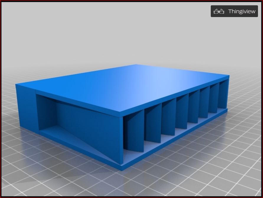

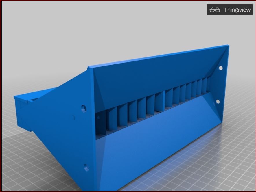

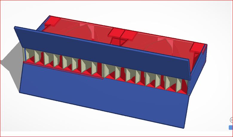

Some more tinkering with the waveguide. Now it's double plus a flare, angled 25° to match the toe-in of the bass speakers... One panel is transparent on purpose.

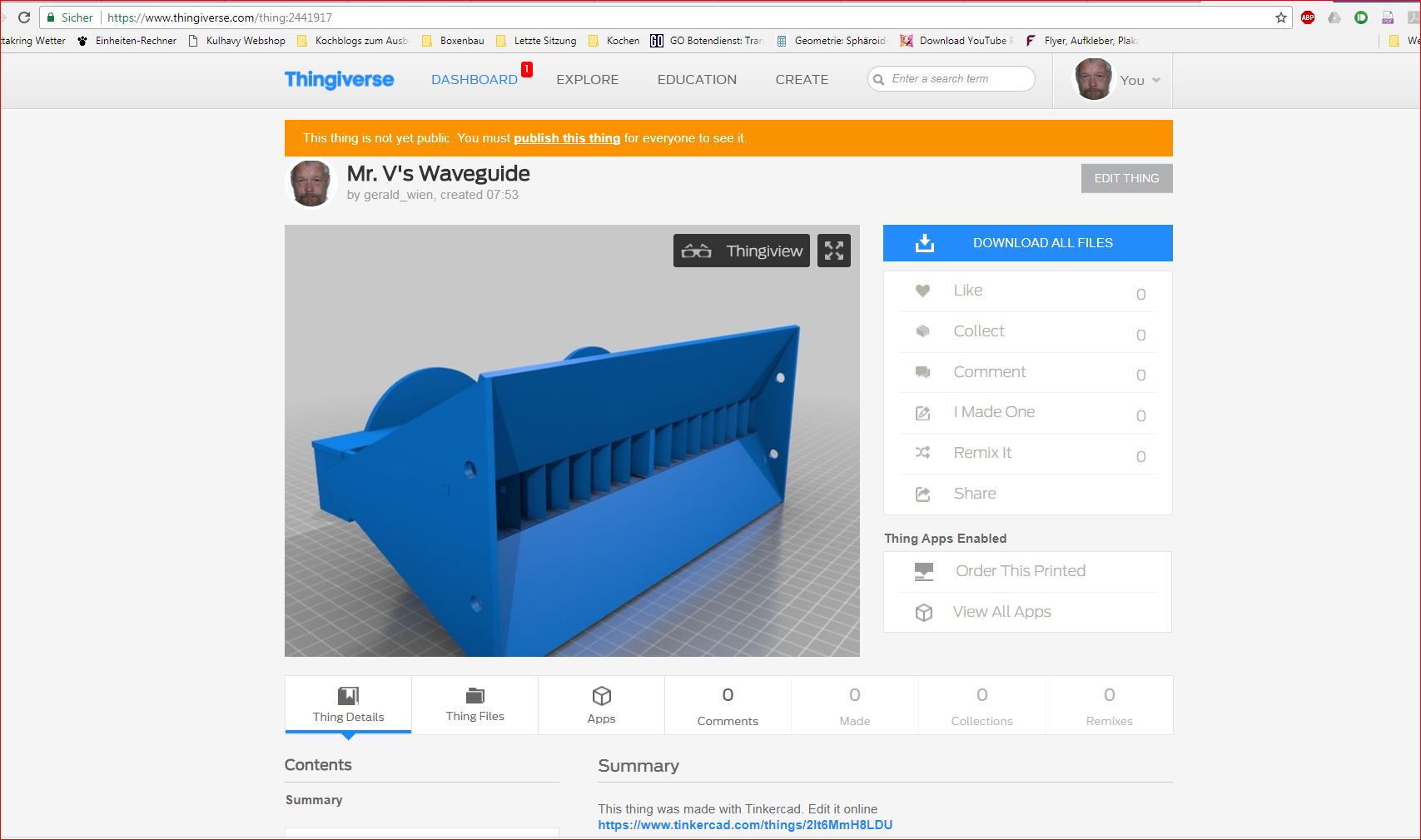

You can find it here.
To all the 3D pros: please bear with me - I'm a total noob at 3D design. Your comments and critics are highly welcome!
Gkh, for a noob 3d design i would say you are 10 times better than me!

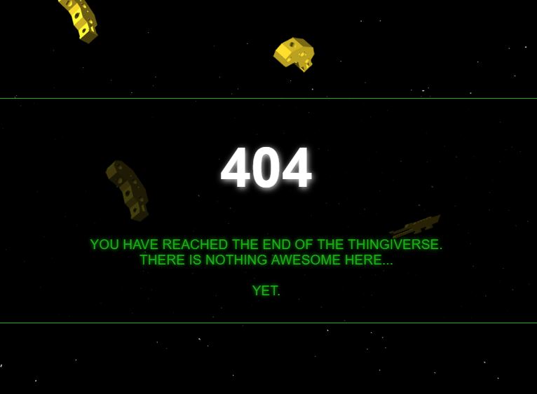

note for the link: i get the page is expired.
