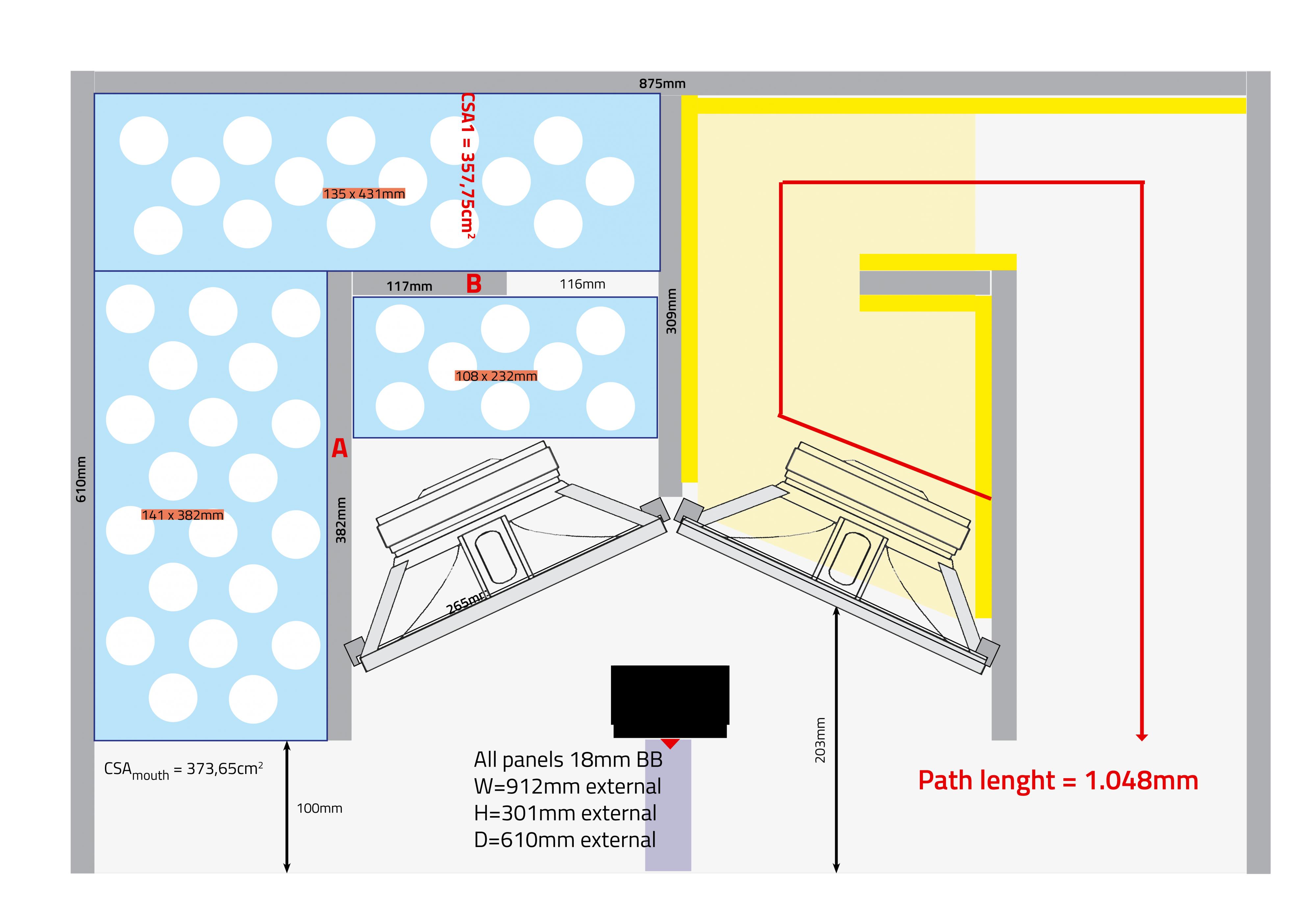

Have you tried calculating the new CSA for the LF path? The increase would improve performance down around 80hz 🙂
You may need to bring the "H"panel forward a little bit or sink the drivers further into the cabinet in order to get the proper driver recess depth..
Your arrangement in this sketch would even allow you to reduce the baffle's toe-in angle to 20 degrees if you wanted to . .
I've tried, but failed miserably in the first chamber 🙁
By "H" panel you mean the one between the two paths? It could be reduced by 48mm, thus regaining a path lenght of 1000mm. Will redraw subito and come back
Edit: drawing attached, added CSA where possible
We are hitting some good numbers in terms of SPL...

No big deal, that one can be closely guesstimated in sim (the speaker basket being in there doesn't throw us off too much)
Yessir , that is exactly what i mean by the "H" panel ..... With some juggling between that and the driver recessing it should be possible to get our path length right while still having the 150mm depth where it is needed from middle of speaker frame to the front of the "H" panel (as shown in the edited sketch below) ... If the depth of the cabinet itself needs to be reduced a little then that is fine ..
Take a look at the notes that i added and let me know what you think of that ..
Gkh,
By "H" panel you mean the one between the two paths? It could be reduced by 48mm, thus regaining a path lenght of 1000mm. Will redraw subito and come back![]()
