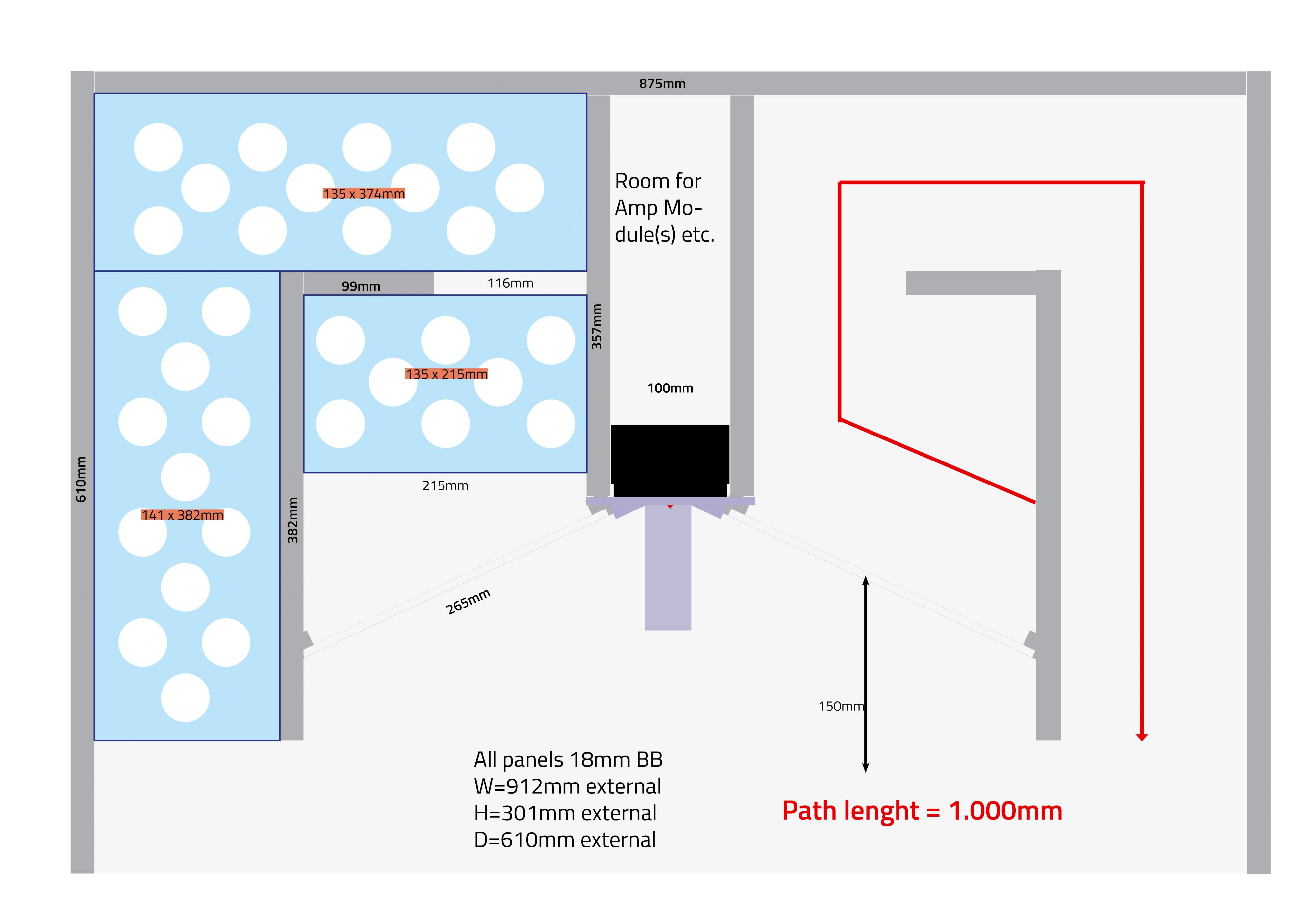

Yes , this is a very good point ... You certainly can open up the chamber around the compression driver , and you can do it with a taper , this is how Mr Vansickle built his .... He was able to fit some Dayton DT250P compression drivers which have a motor diameter of 4.7" ...... It will alter the LF path profile a bit , you just have to account for it in the sim to make sure that the performance is still acceptable (and in this case it was) ..
Another option is to put the HF waveguide out in front of the midbass/midrange drivers , this makes the design MUCH easier .......
You could even use a standard horn and compression driver combination mounted out front in the same way if you don't plan on arraying multiples of these cabinets vertically ...

may I suggest to make more room around the CD driver. not all CD drivers have 100mm perfect cross diameter. this limit the design. also what about a few degree from front to back, between 4 an 6 deg. tapper.

If I move the HF waveguide forward, doesn't it play havoc with low/mid directivity?

I see gkh, for non extreme pa use it makes sense. but then it makes more sense to just place some full ranges.
I wonder how 12" design will Sim with let's say two eminence Delta pro 12a.

That is an excellent question..... Oddly enough and as counterintuitive as it may seem the HF array being placed out in front of the LF/MF drivers doesn't really seem to cause any problems regarding low/mid directivity.... This is within reason of course, i mean surely we cannot block too much of the mouth's CSA , so as long as we don't go overboard we are fine here
Take a look at the Super Planar Club Tops (wideband kickbin horn) , the photo is below , it is the set with the golden looking horns ....... Surprisingly that cabinet produced a measured response curve that was more smooth than the Symmetrical Path style Super planar Line-Array cabinets when compared .... The reason the Super Planar Club Tops measured relatively well probably had to do with the fact that the front chamber was deeper and the two 12" drivers were "spanned" at different offsets while sharing the same path ...... The midrange and HF horns being placed out in front of the 12" drivers turned out to be a great strategy in this case 😀

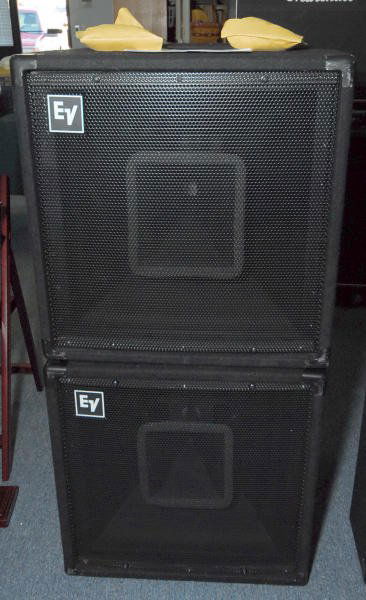

My Electrovoice SH-1810 midrange horns also use an arrangement with the HF array placed well out in front of the 10" midrange driver ..... They were originally arranged this way from the factory, and i just replaced their compression driver with a special piezo array and network ..... The crossover point is 2khz on these with very sharp curves (minimal overlap, which is important here) ..
Here is another example of an Electrovoice (EV) brand midrange horn with the HF compression driver and it's horn placed out in front of what is probably a 10" or 12" LF/MF driver in this cabinet...
This is just a convenient and practical way to do it, and performance can be great
