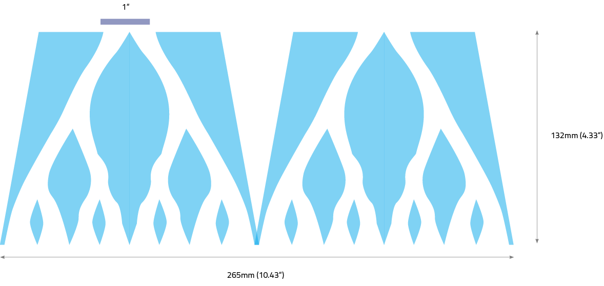

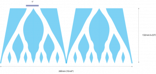

Meanwhile, I've adapted the waveguide to fit this enclosure, see PNG attached.
may I suggest to make more room around the CD driver. not all CD drivers have 100mm perfect cross diameter. this limit the design. also what about a few degree from front to back, between 4 an 6 deg. tapper.
Thanks for the suggestions!
The taper would have been my next question, makes beam steering much easier. Regarding space for the compression driver, I'd love to give it more room, but this depends on how wide the subs will be, as I want to have subs and tops exactly the same width.
