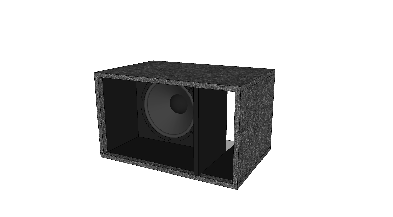

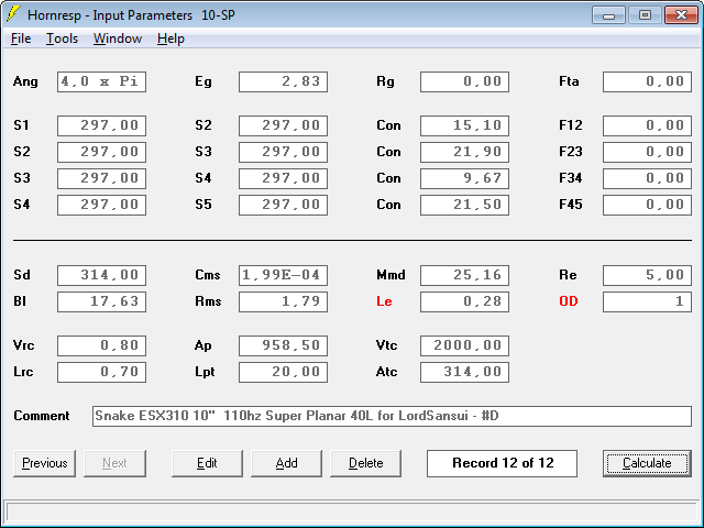

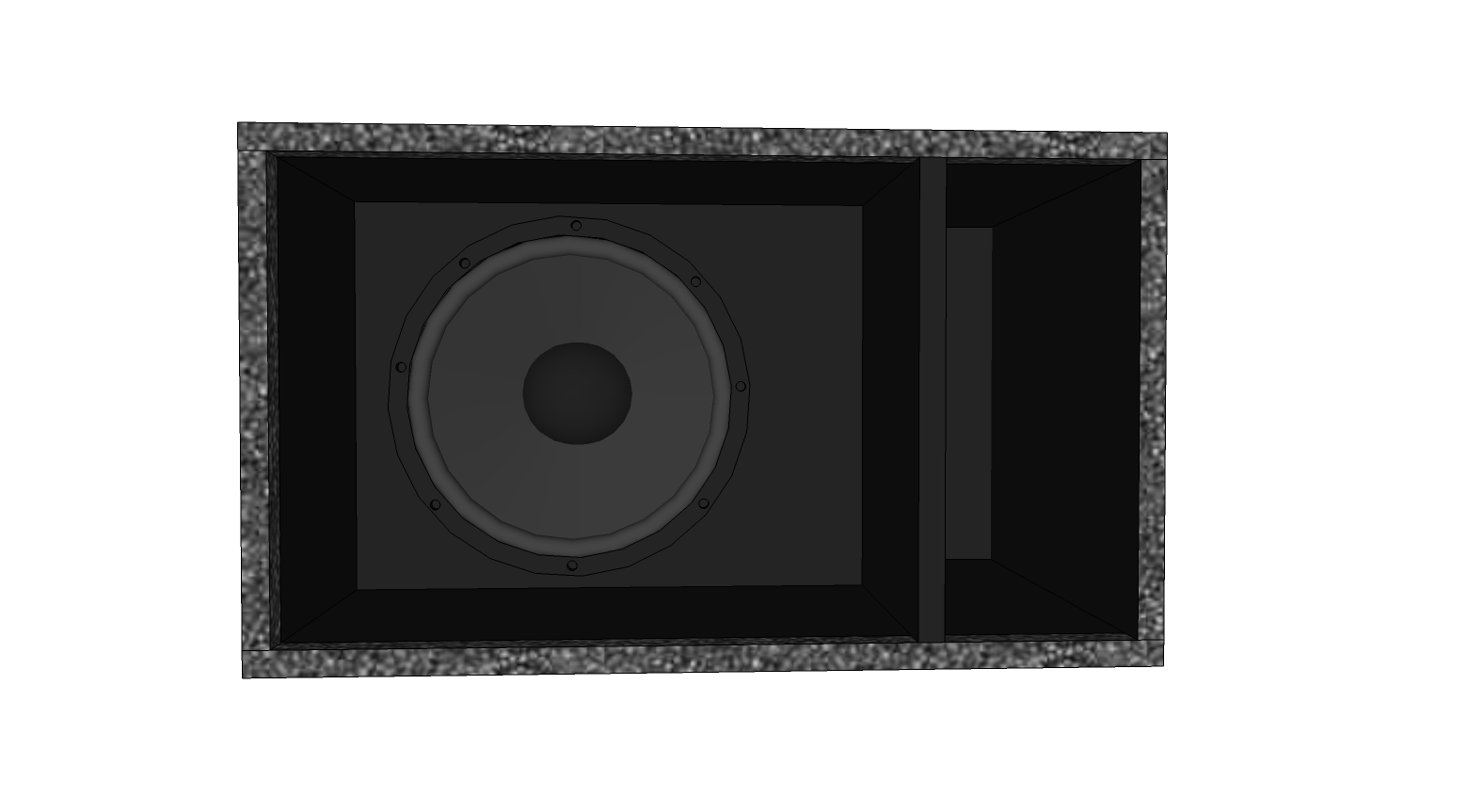

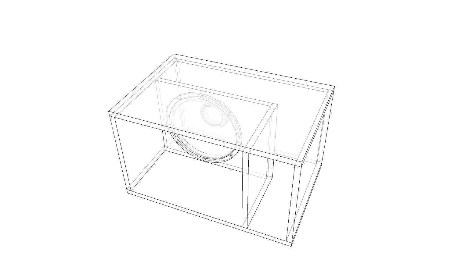

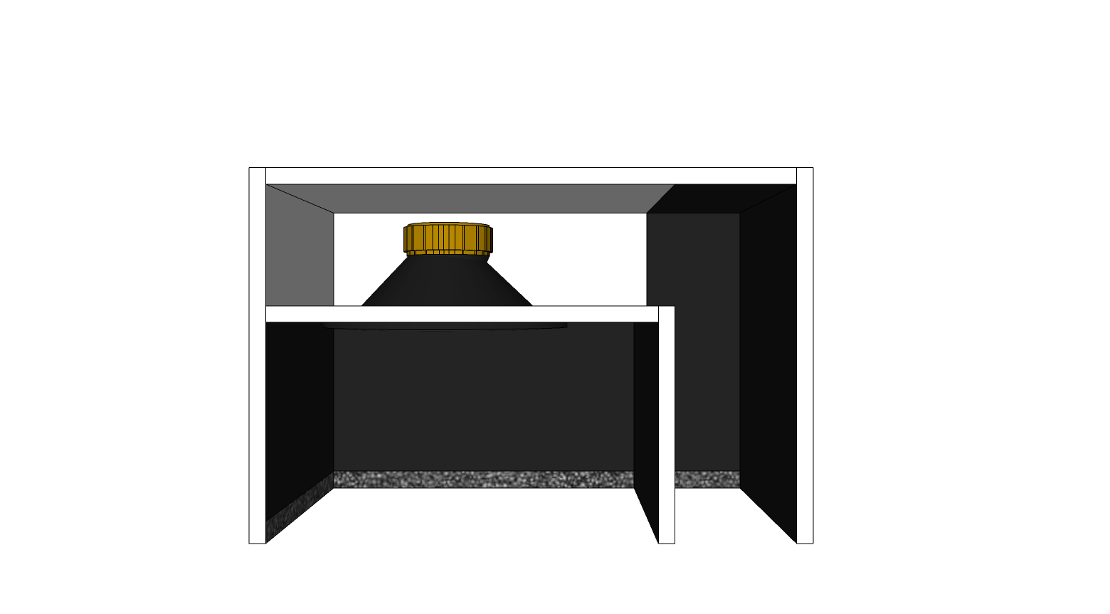

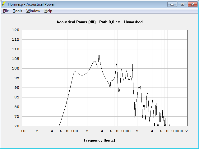

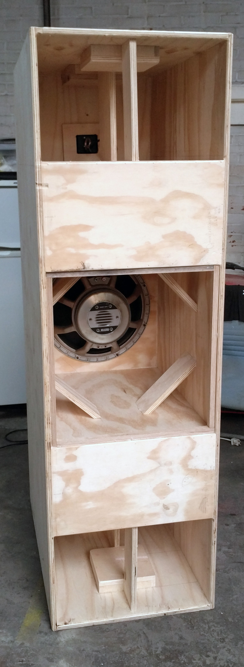

MMJ, below some data I was playing this weekend.
To respect all constrains with the layout below the resonate chamber can't be square, It must be slightly rectangular with the driver little off-set as well, it may produce additional inaccuracy once hornresp model as cylinder with driver centered.
The automated sketch is ready with advanced centerline, etc. Some hornresp parameters indicated in the sketch isn't the proper input to hornresp, it needs an excel sheet to proper calculate them.
I'm open to perform additional simulation if you have something in mind. Otherwise I will star to play with FLH like vintage Altec horn (coincidence you mention it) before I take a decision and probably will open specific thread to not disturb more this one once it's more related to subwoofer.
Note: Probably flared resonator will need to be modeled ad CH and not OD.

Nice simple build! However, MMJ's enclosure is a lot more efficient in the lower octave.
He made the simulation using 2pi and I prefer to use 4pi, if we align the space the efficiency is more or less the same ;)
Sansui , Good Job! Looks like you have it worked out well here Sansui , You definitely have the right idea:nod:
Since the beginning of this discussion (June of 2017) a lot of the posts here have been about Super Planar tops , so it is totally fine ...... The compound horn subs and tops are working on the same basic principles so it seems appropriate that we can discuss them both here:) ......
The Super Planar fashioned to look like an Altec would also fit right in .... The idea has been brought up here before but as far as i am aware nobody has followed up on it .... At least not yet ;) .... .
So your Super Planar related posts are always welcome here Sansui :DIt is up to you of course though .......If you do post about the Super Planar project elsewhere just be sure to leave a link for us here so we can follow ....
Correct, well, we can model a simple single step of expansion in the front chamber using "OD" mode but it is limited to that ....... "CH" mode allows us to contour the expansion of the front chamber in any way we desire but unfortunately we lose our ability to model the driver with any amount of offset in CH mode .... The model just assumes that the driver is absolutely at the end of the pipe without the option to shift it, and that of course is a drawback to our accuracy:grumpy: ....... We can work around this by going with a split-path symmetrical arrangement which CH mode is very well suited for (no driver-offset whatsoever is required with a split-path symmetrical setup) ..
