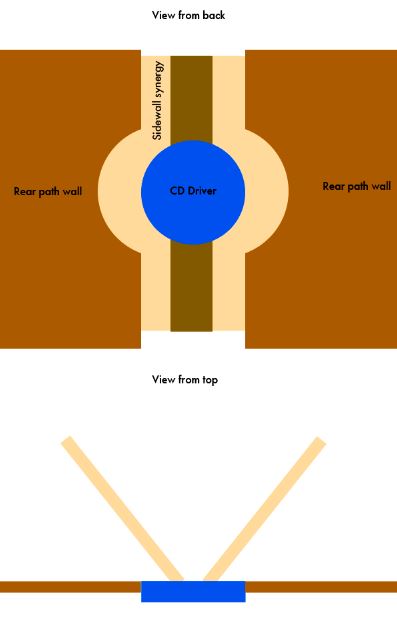

Could you post and sketch for Super Planar top?
I may initiate to prepare a solid work automated sketch, with proper constrains for advanced centerline, etc.

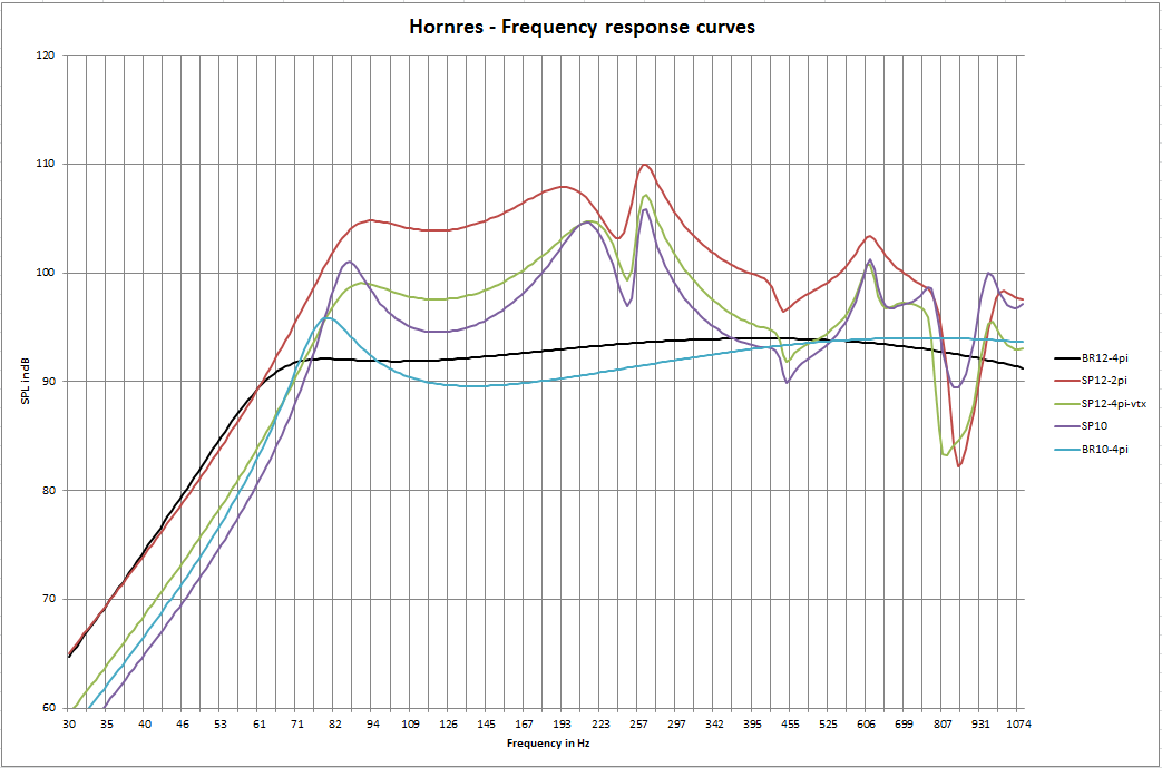

110dB peak around 260Hz and 82dB dip around 870Hz, wouldn't be too much for EQ?
filling dips used to be a concern.
MMJ, do you think:
1) the sketch on the attachment #1 represents the model you simulated?

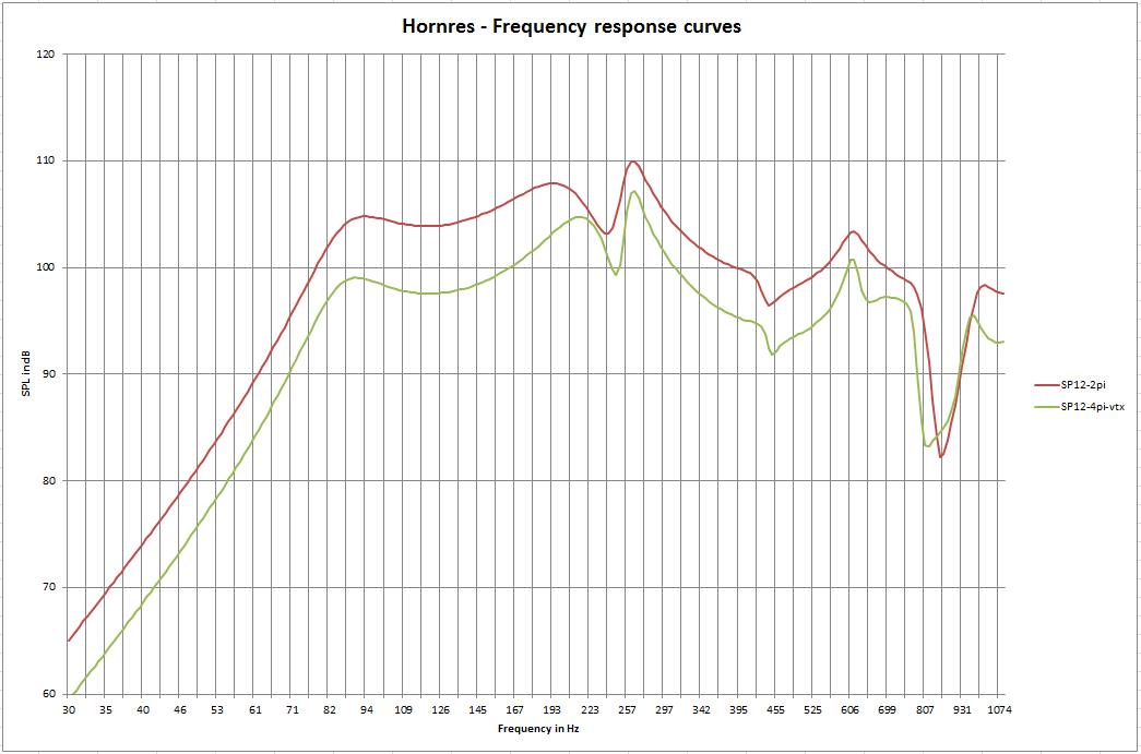

4) To make the simulation more accurate we should should consider 4pi space and add Vtc to proper consider cone volume, right? see a comparison at attachment #2

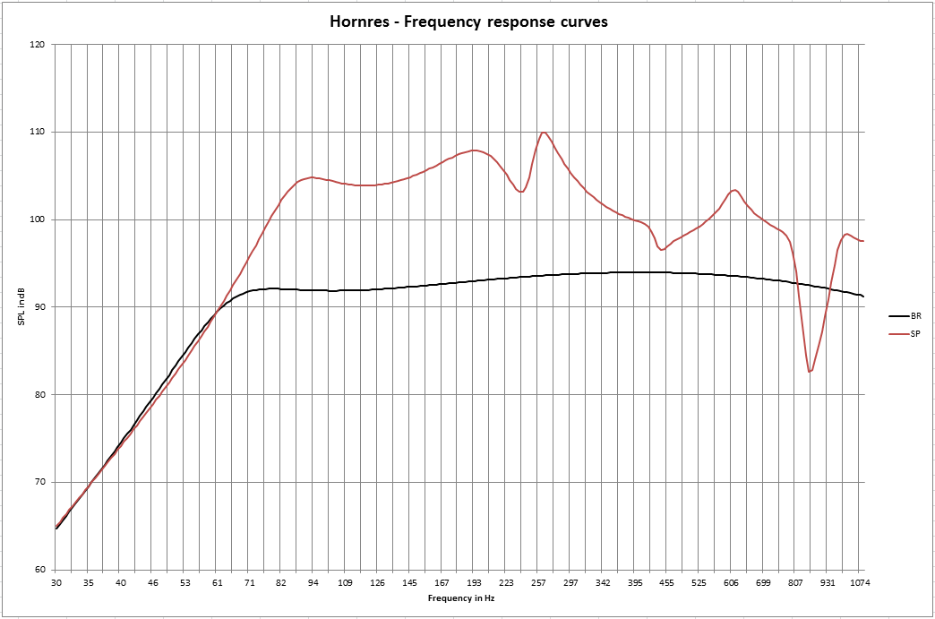

At attachment #3 I made a comparison with the simulations above and also comparison to a 10" version with the driver Snake ESX310 (not optimized)
Sansui, in order to make the sketch correct you need to make the front chamber much deeper than what we see there (our front chamber is Vrc , Lrc , Ap and Lpt in Hornresp) ... What you are showing (in green) only looks to be a few centimeters deep ... It needs to be around 30cm deep ...
NOTE: for the range that you are trying to cover you will want the driver to be forward facing like your sketch on the top left (just give it a much deeper chamber .... Lpt=30cm)
You can certainly add Vtc & Atc if you want to account for the volume of air contained within the cone ...... It shouldn't significantly alter the results ...
Some people may prefer to model tops in 4pi , and other folks may prefer to model in 2pi .... It can be done either way really ........ When making comparisons just remember to use the same standard for both models to be fair otherwise the comparison would be misleading ..
Your 10" model definitely needs adjustment .. . Try reducing the main path's Cross Sectional Area to see if that helps to alleviate the nasty peak at Fb & the saddle shaped response just above Fb.....Give it a try ... ... If the 10" refuses to behave well in your model then it is possible that it just isn't a suitable driver for this design (i could try optimizing it for you if you don't have any luck with it ) ... ...... Your 12" on the other hand appears to be highly suitable 🙂
Thanks for your feedbacks, I will start with automatad sketch soon.
