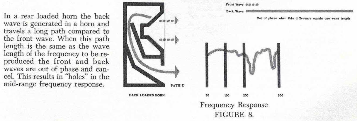

I guess some of the dips in the passband are cancellations of waves reflecting inside the horn.
You are right, I was also thinking the same but I decided to make some research to find the answer better explained.
So, looks like all Back Load Horn has the same issue, I mean, the combined wave from the driver's front + back will be out of phase and will create cancellations (dips). Probably FLH with vented rear chamber will have the same issue. once sealed chamber will break super planar proposal maybe the only way to improve the frequency response would be to adopt some improvements technique used at transmission lines like driver off-set (already included), the "stub", filling and tapering the path, at the end Super Planar could a TL with front resonator?

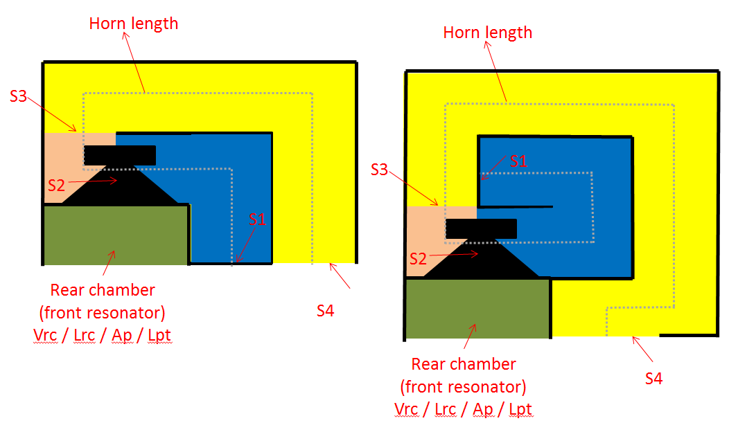

Attachment #2 there are 2 sketches considering the "stub".
Is the green area consider the "stub?"
Ok, it's the blue section. You extended the length of the line and tapped (S2) the offset further down the line. Stub = longer S1 to S2.
Correct 🙂 Although to address a problem at 870hz the stub would only need to be a quarter wavelength at 870hz in theory .... Not very long 😉

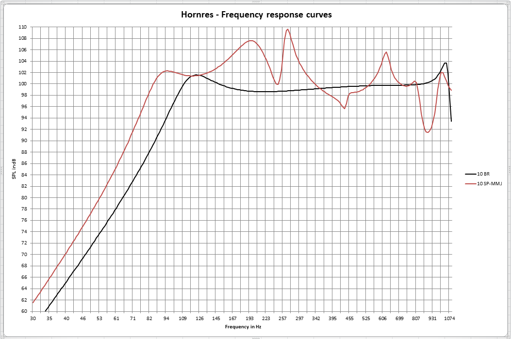

Hi MMJ,
I made some simulations yesterday taking into account what you said and I can confirm almost all you said and what you shared is basically the optimized result. The frequency response in all cases present the peaks and dips due to the phenomena linked to the cab design (front and back wave phase aligment). The doubt is if the real measurement will present the same response regarding the simulation and in this case I will take a safe place and assume that the dip will exist in real life based on the others cab design as "super scooper". The amount of output SPL Super Planar is able to deliver impressed me but there are some issues that I may should wait for some simualtions vs measurements comparison to make a conclusion.
In the mean time I also discovered that the BR 10" cab I built has a wrong volume, so it can be optimizes to gain +5dB arround 120Hz, more or less the same problem you saw at super planar 10", at BR it can be fixex reducing the internal volume from 20L to 10L, maybe at Super Planar I should increase the compression ratio in that case.
Note: I start to learn deeper after I built the 10", till that time I was just coping existant designs.

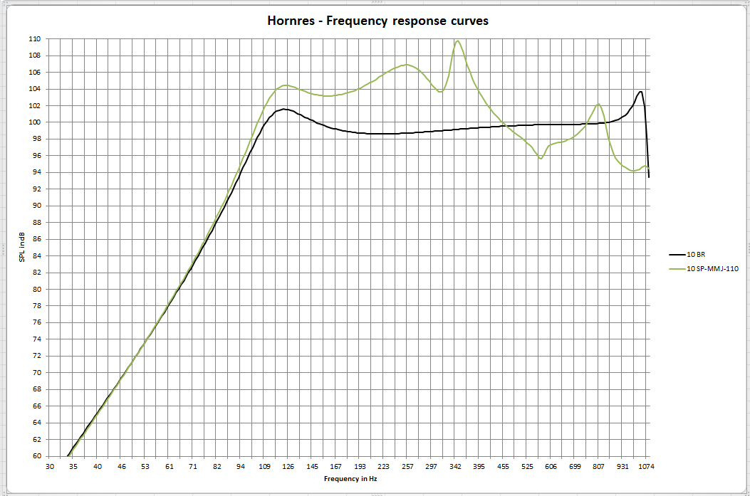

Thanks a lot MMJ, but check the comparison below vs a BR.
Mr Sansui ,
For a fair comparison lets match the fundamental tunings (Fb) more closely ..
Here it is tuned to 110hz with that same ESX310 driver .. .. It is now about 40 liters net ..... You will notice that both paths are shorter now (main path and front chamber .... They must scale down together..)

You are convincing me
104dB/1W/1m from 115Hz to 400Hz from a single 10"driver with a 40L cab is realy a very seductive proposal.
I will play around to see if it's possible to flat it a little more.
Accepting help![]()
Right ...tempting 😉.. . This is what i ended up with .. Very similar .. .. ..... Halfspace .... Fundamental tunings are matched here ...

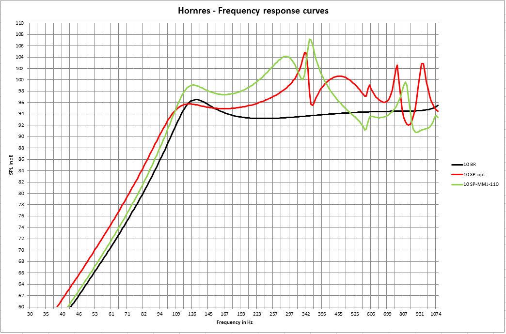

Below the maximum optimization I got to flat the response.
The hard part I see here is that the cab design bust more the middle of the bandwidth.
BR-opt = 10,5 L flat
SP-opt = 25,5 L
SP-MMJ = 40 L
4pi space
In trying to get the SP flat it also looks like you have given up much of the performance advantage .... Partially due to the fact that your 25 liter Super Planar is tuned lower .....Notice how the response "knee" on the reflex and large SP are located higher up than the 25 liter SP ..... Your reflex cabinet appears to be tuned highest of all .. .......
Match the tunings for fair comparisons....
The extra gain and headroom in the lower range is very valuable, it is gold, not worth sacrificing if these are to be used in an application that demands high SPL or very high effiiciency . .....
