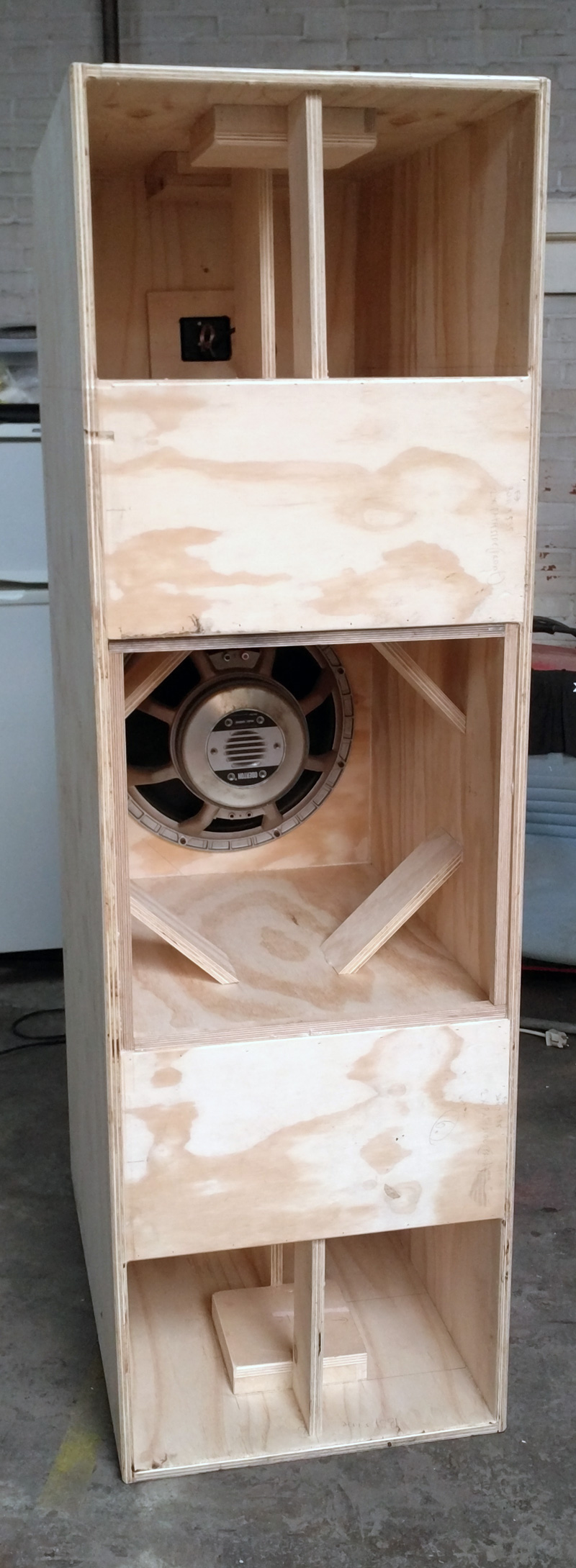

Build a Planar 8th for Oberton 18XB1500 driver. I Did some little sound testing yesterday evening.
First thing I noticed is that HR prediction of diaphragm displacement is a bit off. On the power rating about 80 volts @ 8 ohm I had given the woofer. The cone should have moved considerably, yet it barely moved a few millimeters.
I did some a/b testing compared to a xoc TH18. To my ears the planar had more punch, a little lower an louder. Some of it thanks to its huge size. 185x58x90cm (l x w x d). However... the xocTH18 sounds 'warmer'.

The exercise has already been done for us because 2x12" Super Planar top cabinets have already been built and they work well with sufficient dispersion in the horizontal plane, so it is safe to say that a 2x10" with the same layout should also work ....
If it is built with enough internal volume with proper path lengths and CSAs in the right range then the 2x10" Super Planar should be every bit as efficient as two 1x10" cabinets ..... I can model it if you like 🙂 The split-path symmetrical layout has been most popular ..

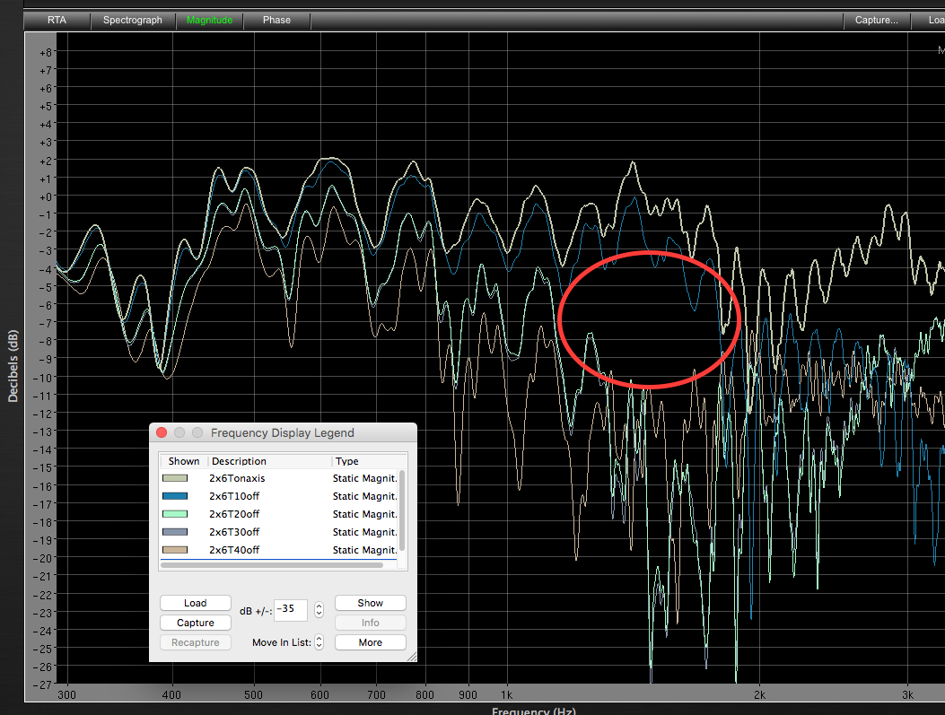

Unfortunately, the center to center distance of a dual driver set up on a toed-in cross-firing baffle will put a huge "suck-out" hole in the off axis upper response as you can see circled in the example below with a 2x6" with around a 20 degree cross-fire.I just thought i should ask because the dual driver set up on the toed-in crossfiring baffle would be an answer to some of the potential challenges we are seeing with the 1x10" Super Planar top .. ....
The off-axis path length difference between the two drivers causes the cancellation.
Doubling the driver size to 12" would drop the "suck-out" hole an octave, a 2x10" would have the deepest null centered around 1kHz.
