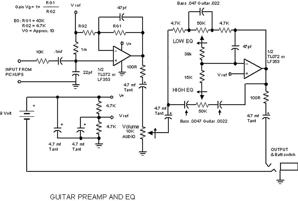

This is the schematic that i intend to use, several people made it and as they say it's pretty good. Any thoughts?

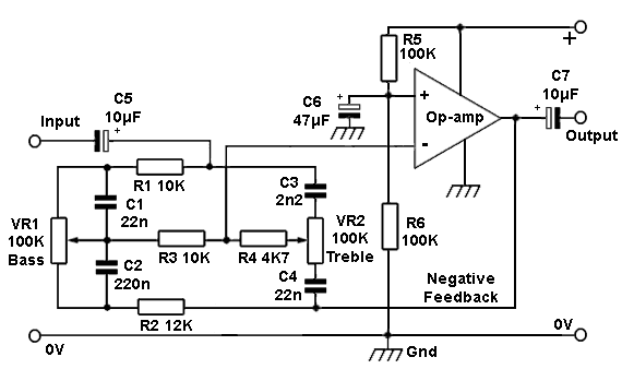

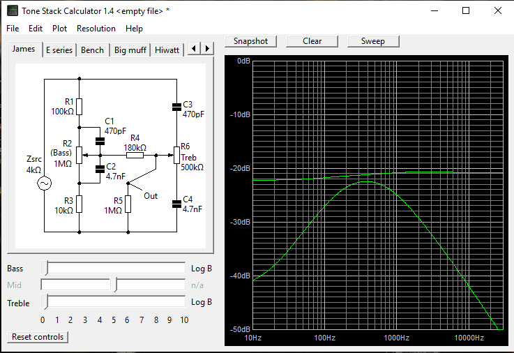

Also thinking of maybe substituting the frequency control section with the one from Tonestack, i can see it's response and looks good. Don't know what the current one is like.

If you use the first thumbnail, you might want to include an additional DC path for the second amp. Otherwise it depends entirely on the 'LOW EQ' pot, which will surely deteriorate over time. A 1 megohm resistor across the 47pF cap should do well enough without corrupting the tone function too much.
I'm glad you're planning the bi-polar power supply. Tantalum caps sound OK, but when they fail, it is usually leaky -- you could find it draining batteries faster without noticing the cause.

Ok, I'll try adding a resistor in parallel with 47p on the second amp. Tantalum are in the schematic already so i planned on using tantalum in the same spots, but i could use anything instead of that for audio. You think it's better to put the more audio focused like caps Silver Mica, MKP or MKS instead of tantalum?
Thanks for all the input Rick
Depends. Tantalum caps in the audio path DO have a sound (Neve consoles). You may like that coloring, or not. For reliability, tantalum caps are perhaps the worst ever made. Polypropylene are the most transparent, but only practical up to ~ 1µF; above that, bipolar Nichicon MUSE are the best.
Technically tantalum caps have a relatively high distortion, not nearly as bad as class 2 ceramic capacitors, but much worse than any of the other types including aluminium electrolytics. Besides, tantalum is a conflict mineral, but there are manufacturers who claim that they only use tantalum from legitimate sources and have some evidence to back that up.
If you stay with your plan to power it with dual 9V batteries, you can eliminate all 3 tantalum caps in the signal path!
If you stick with the schematic in post #22, delete the electrolytics before and after the volume pot. Then fit one from the CCW leg of the pot to ground.

For changing the central freq on the bands i guess i need to play with the caps just around the pots.. ?
I'm removing the Volume pot from the schematics thou, gonna put it between the pickup and the preamp (passive Volume control) cause i'm adding passive switch mode for emergency. So i can just bypass the two tantalums and the pot altogether so i can make the PCB eve smaller! Now is at 30x30mm

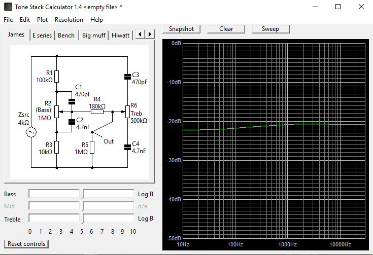

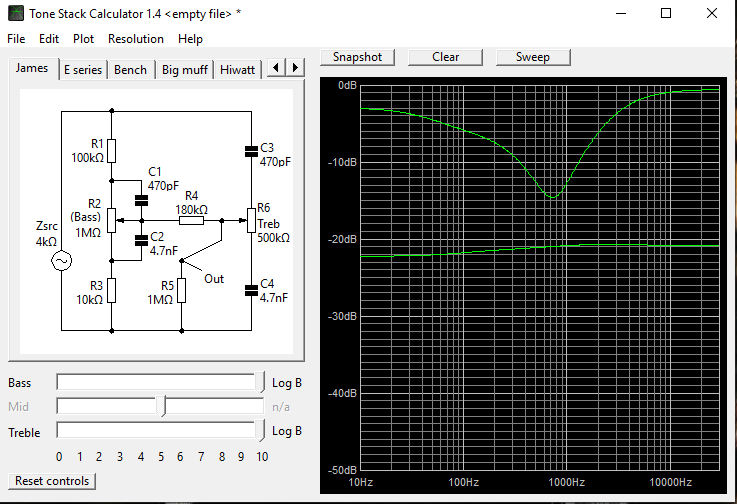

But definitely thinking of making a second version of the preamp with the tone control on the second thumbnail, i've seen the response and looks pretty good.

Yes. Don't fit them at all. If you're designing your own board, use that space for something else. If board is already made and the pots are to be hand wired, the CW-end of the volume control can have its wire go straight to the pad where the tantalum capacitor was.
Yes. There's a reciprocal relationship between those cap values and frequency -- double cap values, half the frequencies. If you get too creative, you may cause a gap, or an overlap in frequency response, or cause asymmetric boost/cuts.

You'll be defeating almost every advantage of an Onboard Preamp -- I wouldn't go to the effort of building it and cutting into a perfectly good bass to install it, for the minimal benefit. A switchable *passive emergency mode* might be a sound idea if you keep the tantalums .. OR: You could design conservatively, always have a fresh pair of 9V's in your back pocket going to the gig, revel in the night and day difference in the sound of your instrument, and not look back. A friend has a Gibson Ripper with a 3rd pickup, a 3-channel preamp, and phase switches that has yet to fail -- from 1977.
Your 3rd paragraph and thumbnails .. Umm -- that's a tube circuit, for starters. There's no reason to use those component values in a solid-state circuit, or to tolerate the resulting response asymmetries. And I don't mean this as harsh as it sounds, but, if those FR curves look good to you -- for a bass preamp -- I'm afraid that's about all the help I can give.😉

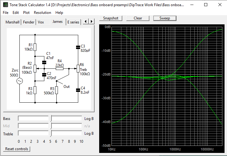

I will use the tone circuit,, actually i did some research and found that other tone circuit to be Baxandall. I implemented it in the schematic and did some component adjustment.
How does it look to you, any thoughts on the whole thing or changing something.. ? For me the visual output seems good, once i hear it i'll do additional component value adjustment if needed, but this one seems like a good candidate for the final design i think...?

I've actually used the values from the same tone control that is using an opamp that i've found that explains how the Baxandall tone control works... i've attached photo of that.
you DO understand that the 'B' op-amp section is an inverting, virtual-ground implementation, do you not?
I see that but I don't understand it... I just modified the tone control circuit a little. Sorry if you're saying something very obvious and i don't see it, it may be frustrating to you sorry, but i don't understand everything in the schematic and probably don't see some of the bits you're refereng to. So i don't know the purpose of "inverting" and "virtual ground" here...
