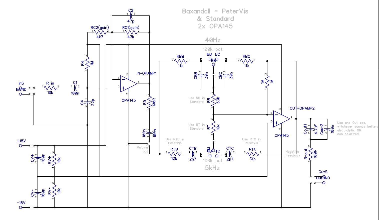

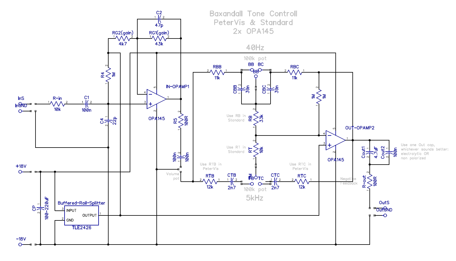

A question about the voltage divider in this circuit. Can I increase the value of the two 4k7 resistors (increasing the impedance of the power supply in other words) to get the divider to draw less current? If so, what is the maximum it can go without having any adverse effect?
Or is it better to use IC voltage divider for that purpose instead of the resistors and caps?
Also, I decided to use two OPA145, it has so far the best specs with very low power requirement and supports single power supply and it's a FET input which is better for an instrument.
So, considering all this what is the best way to deal with the power section now to have it draw as less current as possible? I know converting this to single supply will take some modification of the circuit, which I tend to avoid if the current can be lowered in symmetrical. But will convert to single with some help if it's a way better way for battery.
Yes. Buffer it with an op-amp. Not sure what you mean by 'IC voltage divider' , but a single op-amp channel will do very well. Since you'll probably want to use another JFET-input device, you can raise the resistor values a ton -- 100k would not be unreasonable. Just be sure to consider power-up/power-down when you design the capacitor AC bypassing. You'll probably want to have approximately matching values going to each rail -- ground and +9V -- both to reduce thumps, AND strain on the op-amp input.

I'm using 2 opamps (2 separate IC's) as the OPA145 is single amp only, the dual is not out yet, but in total 2 amps, no more.
For the IC voltage divider I meant TLE2426, sorry i should have stated that. Using it doesn't require any resistors, just one cap parallel to the batt and even than may not be necessary but not sure.
But I'm trying to avoid modifying the circuit again cause I already designed the PCB at 25x25mm, would rather just use 2x 47k resistors instead of the two 4k7, but if that would cause any problems I would do the redisign for the TLE2426.
I'll post the latest schematic later when I get back home, I'm not for every bit that you're referring to. I did some research to get familiar with some stuff but not everything yet related to this circuit.
By reading that article there seems to be more work to redesign the circuit from symmetrical to single power supply than to put the TLE2426 in place. Not sure what is the best way for OPA145, but says it can operate smoothly either way. I'm in pursuit of lowest power consumption, OPA145 seems great for that and in every other aspect for this purpose, just to work out the power supply. TLE is also very low on power, i think it was about 170uA.

I've added the buffered splitter instead of the resistor/cap network, so here are both circuits.
I've been playing around with the tone control so don't let the too many components and text confuse you. I found some guy that made it easier to calculate and adjust the freq you want with more standard component values so i incorporated that too. So all the mods are avaialbe on one PCB so i wouldn't have to redesign new PCB for every variation id' want to try, will just use the relevant components on one PCB when testing and whichever gets me closest to what i want.
Also i have left out proper connectors and have not attached them in the schematic. The pads for pots, in, out etc are scattered on the PCB to save space, i want this to be really small. But still the schematic should make sense without those connected.
  • Bass OP ALL SMD Baxandall PeterVis mod & standard + Volume - final symmetrical V.png
  • Bass OP ALL SMD Baxandall PeterVis mod & standard + Volume - final simple Rail Splitter symm V.png
