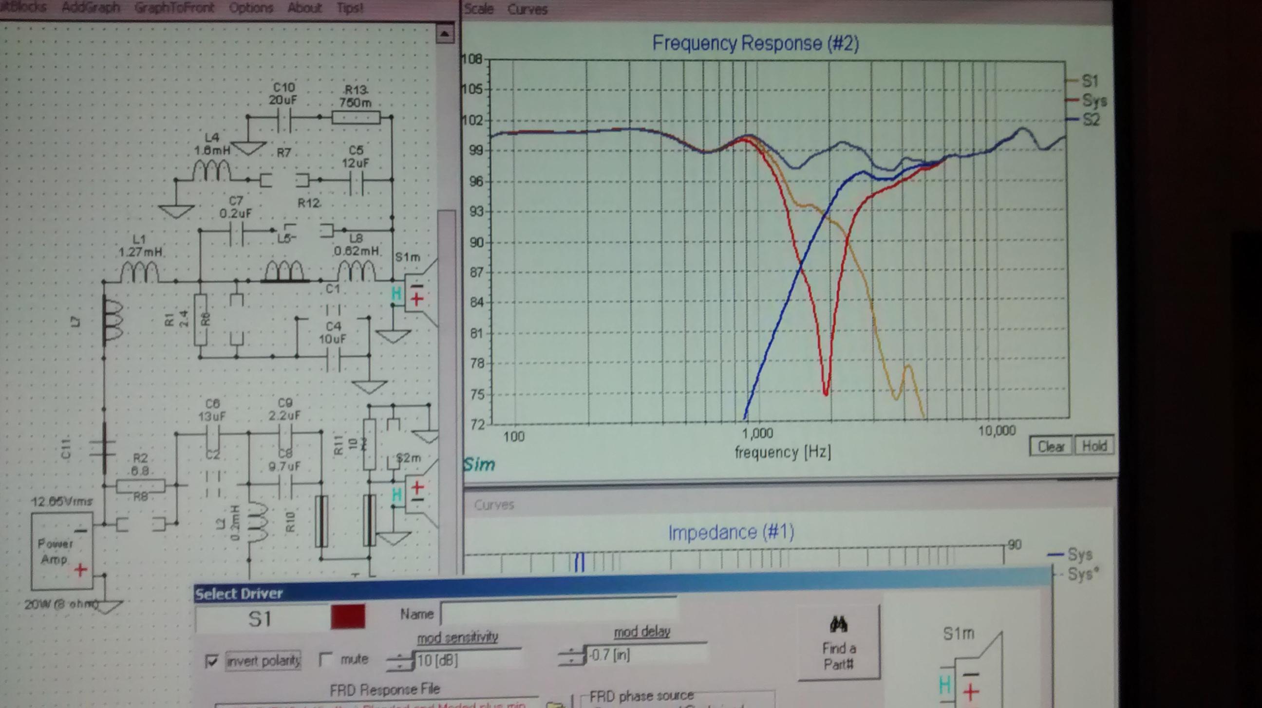

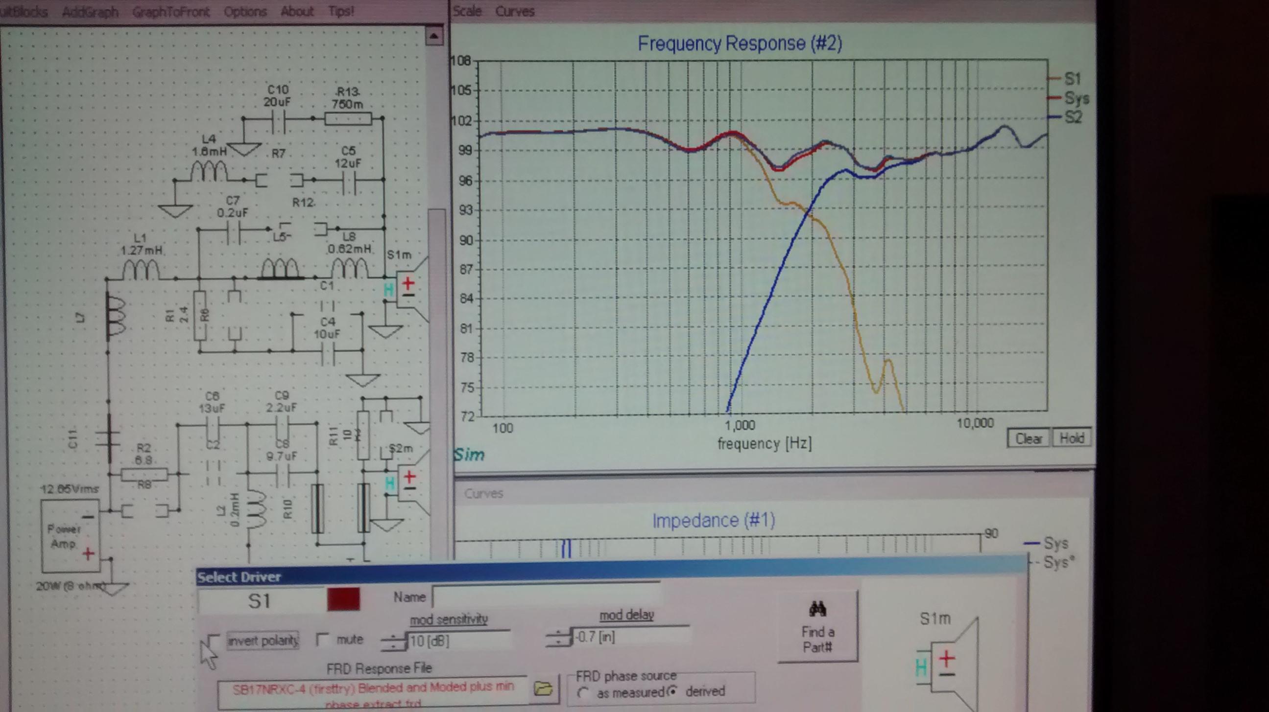

Moving the mic up and down determines acoustics center where the drivers are closest in phase with each other. If Wolf used LR4 or something similar the drivers phase should be track each other to sum close to flat on axis at crossover point. If one of drivers is reversed it would create a deep null. However, I use it so I adjust delay in the x-o simulations.
When you take measurements of individual drivers (frd and zma) and put them into something like XSim which has minimum phase extraction capability and ability to change the delay you can simulate the crossover, so it will be mirror of what you measure with current x-o. You can modify the x-o by reducing the dips created by bigger baffle or sharp edges. Since I don't have the driver files I can't model anything but, say you want to add a bit of a boost in 3k, you might lower value 0.82 Ohm resistor in series with coil in tweeters filter, or change the capacitors values. However it will change also the phase. Basically you play with the components until you're happy with the sound or measurements, hopefully both of them.

Maybe, yes. There isn't necessarily a problem with a peak a little off-axis vertical. Sometimes it is preferred.
That's why I wrote potentially. In my room it would be problematic. But if there is a measured flat response at 30 degrees off axis in room, why bother with it? In my opinion it's not detectable. But hey, everyone have their own spices to enjoy🙂
