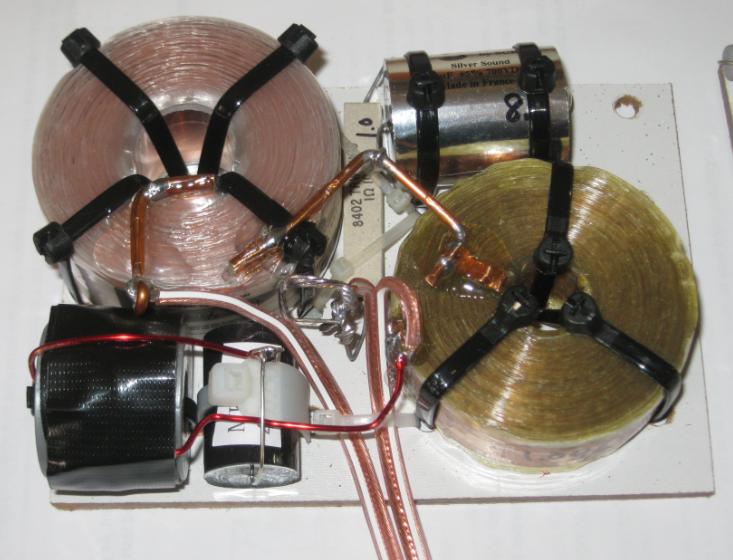

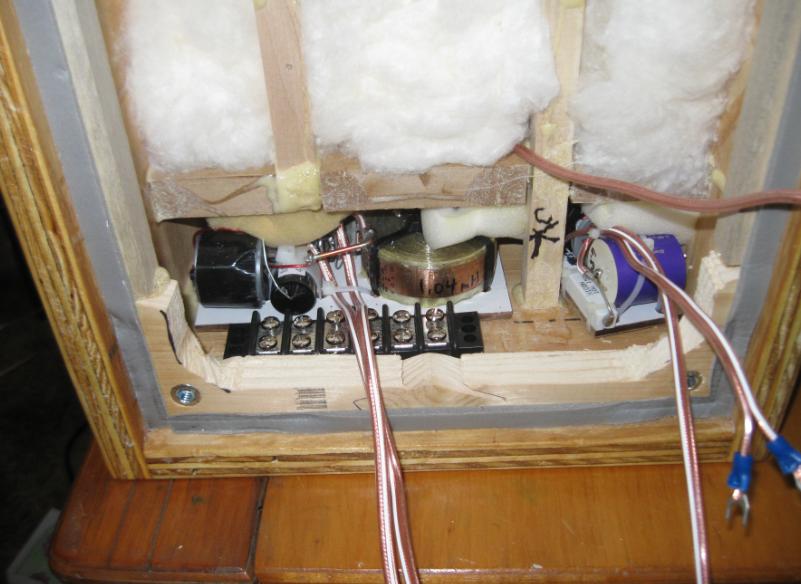

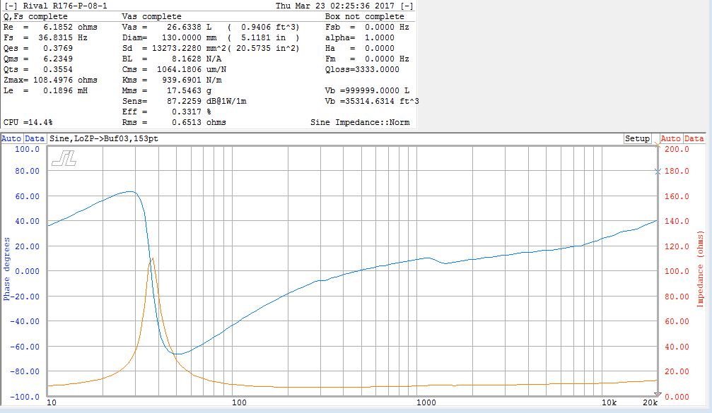

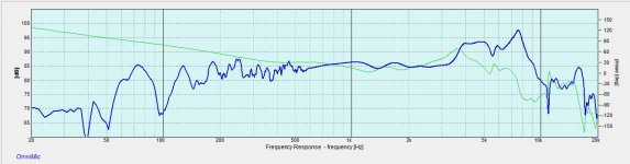

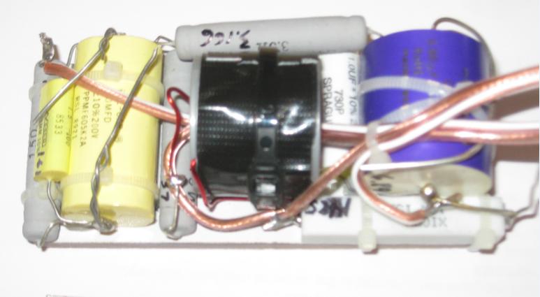

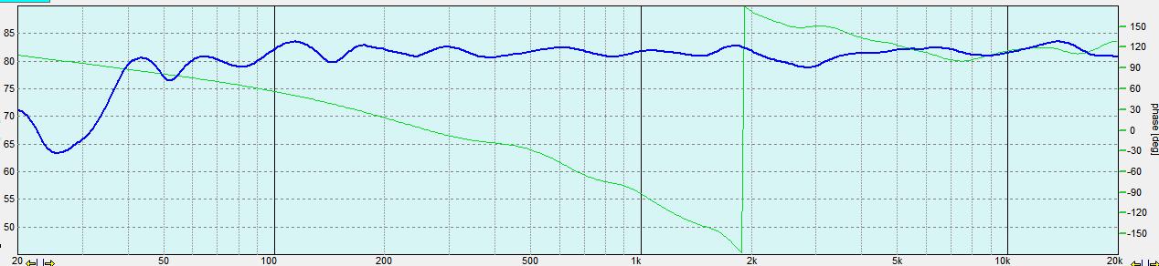

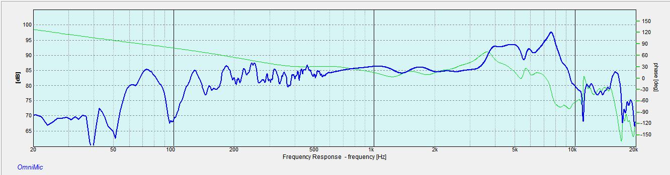

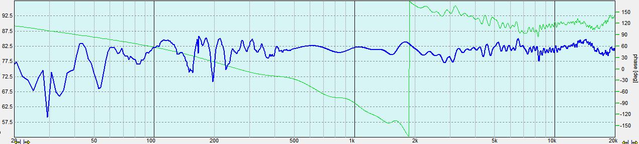

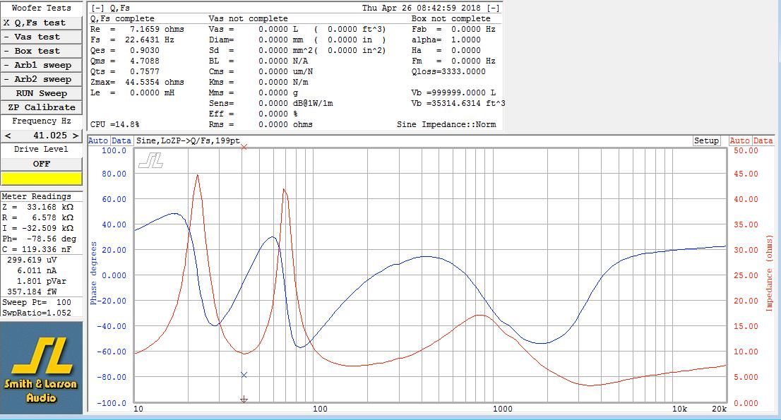

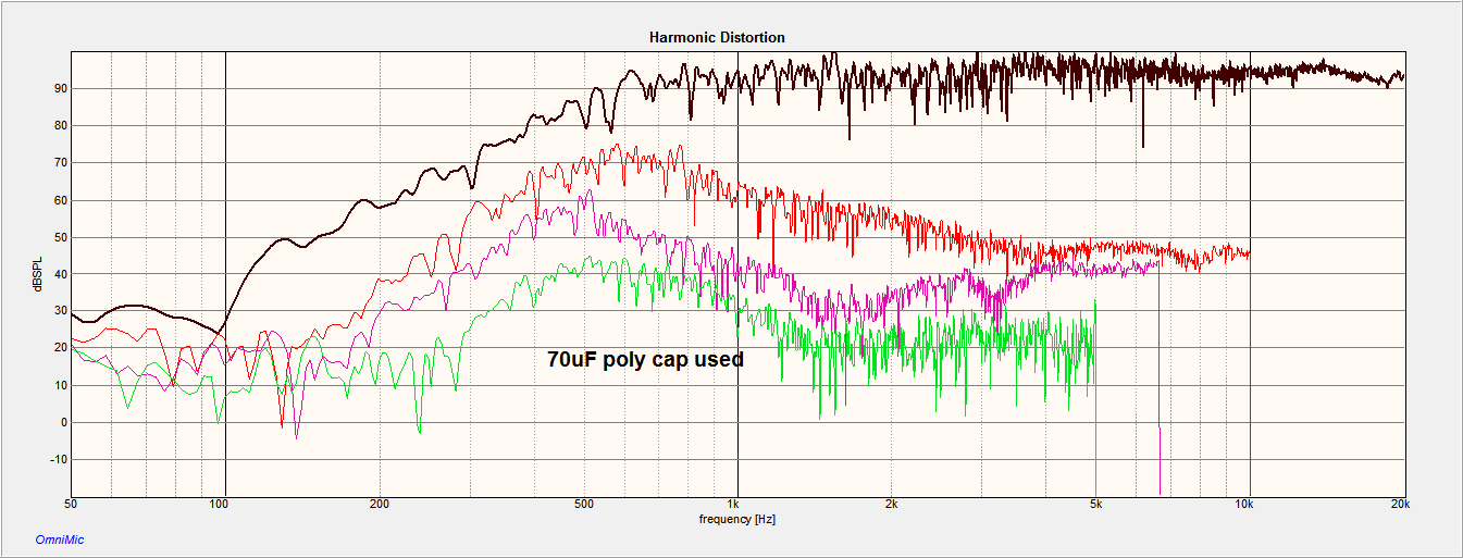

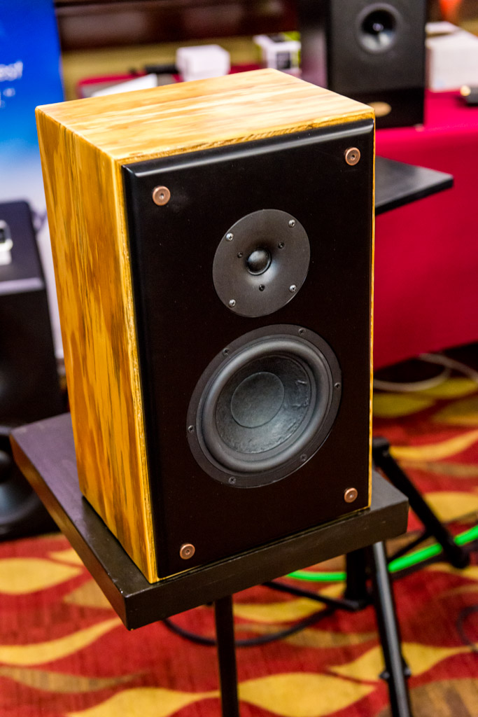

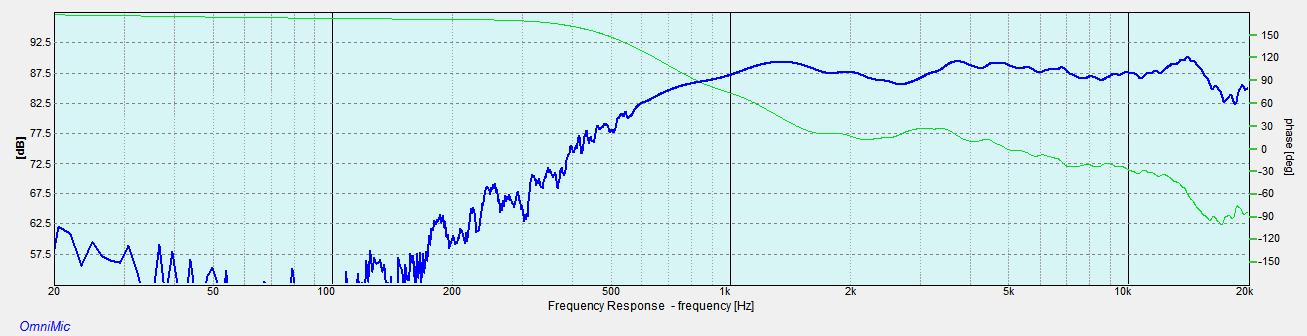

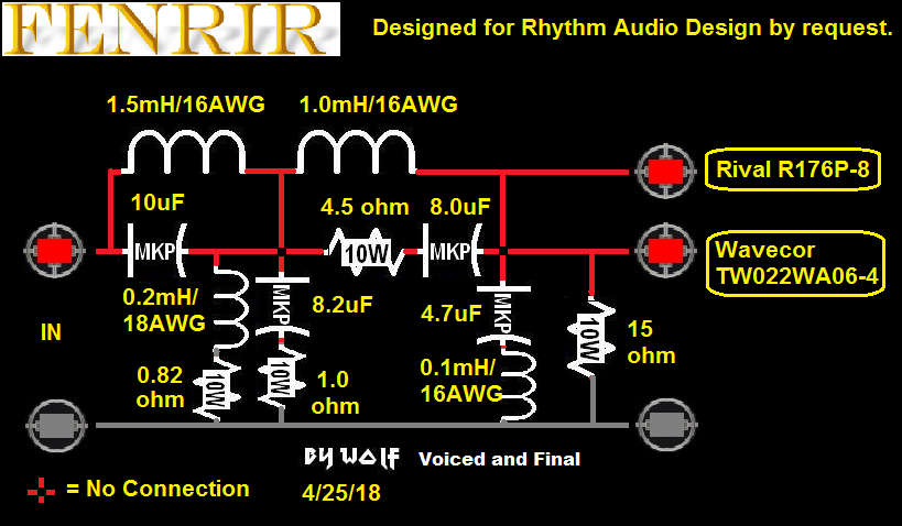

I just finished this pair of bookshelves a couple weeks ago, using the Rival Acoustics R176-P-08 carbon-paper woofers, and the Wavecor TW022WA06-4 waveguided 22mm tweeters. 18 ltrs tuned to 40Hz for an F3 just below that, and an FR measurement that sits mainly at +/-2dB, while having low HD.
I'll attach all of the documentation in photos. Thanks for looking, and please ask if you have any questions!
I didn't take any further polar responses that I saved, and the horizontal plots I took were of a previous xover iteration. It was enough information to apply, but not valid for the final implementation. Basically, it just tilts downward as it should.
If you mean the small bump at 1.8k, that's only about a dB, and is not forward sounding or anything like that.

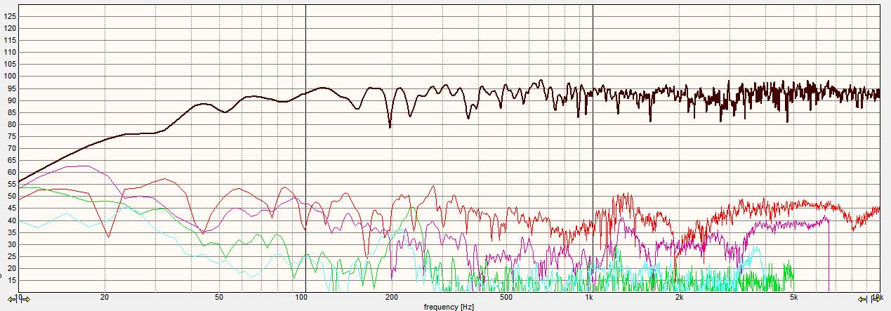

..looking at the UNaveraged on-axis response, the region between 810 Hz and 2.2 kHz looks like it could stand a reduction of about 1.5 db. The treble on-axis would be a bit "hot" on-axis as a result, but about 30 degrees off-axis (diffraction dependent) - it might be more ideal (particularly if you run the tweeter a bit lower in freq.). Moot point though if you've already got a listening axis you like.
(..yeah, the averaged graphs look exagerated around 1.8 - but I'd chalk that up to aggressive "interpretation" by the measurment system.)
-regardless, a nice project. How is the midbass? Subjectivly similar to the Scanspeak classic or Usher?

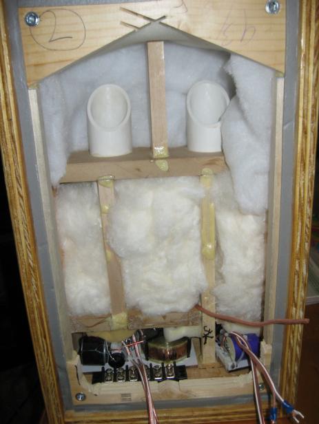

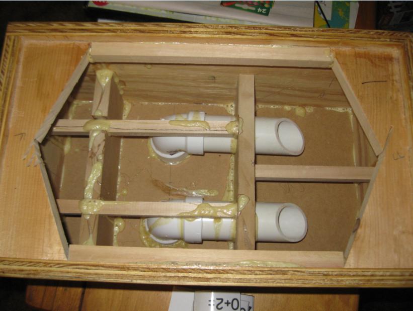

This looks like an interesting build. It’s the first time I’ve seen that tweeter used in a project and I’m not familiar with Rival drivers. If you don’t mind I have a few questions.
• What are your impressions of the overall sound quality of the Fenrir?
• Is it worth the money compared to other similar builds?
• Are those woofers worth price? They look great. Your impressions?
• How did you like that Wavecor tweeter?
• Would the Fenrir work in a different box with one port?
My brother-in-law is looking for a project of similar size.

The SQ is really easy on the ears and non-fatiguing. Enough detail to not sound dull, and bass extension and tonal ability is quite exceptional.
If you would like me to compare to other kits, please ask which ones.
The woofers are REALLY worth the price, and likely should cost twice what they do. Basically you get a motor/frame similar to that of Wavecor, and a proprietary cone formula only from Rival.

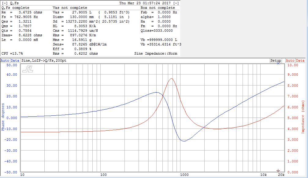

The Wavecor tweeter goes lower for a 22mm than it has a right to with a low Fs, and a reasonably smooth response. It has low HD as used in this design.

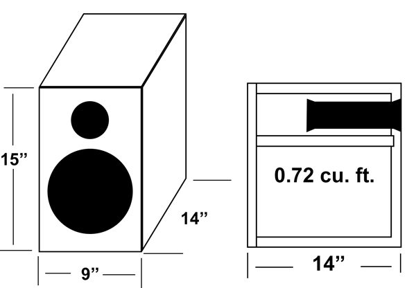

If you made the cabinets no more than 1.5" narrower, this should not affect BSC that much, and the cabinet can be made deeper this way with the same volume specification. If that is your choice, one port can be used as the depth will be more accommodating, BUT- It will need to be of larger diameter than the ports I used. I used 2 due to the angling needed in the shallow cabinet, and the port mach air velocity speed reduction. It would be a minimum of 2" diameter (2.25"+ recommended) to combine the 2 ports into one, and that with an elbow would not fit in my cabinets. Remember that the larger diameter port will also be longer than they are in the box as I designed it.
Let me know if you have any more questions,
Wolf
The baffle response will change from my 10.5" x 17.5", and your cabinet volume is too large. It should be 18 ltrs, or about 0.63ft^3. This will further alter the tuning of the port, and the air-spring on the driver.
If you make these kinds of multiple changes applied to this design, I cannot predict how the results will come out, and all bets are off.
Like I said- if you change the baffle more than 1.5", which you didn't, and use a larger singlular vent, your tuning will change and need adjusted in length. I cannot vouch for going larger in volume or also changing the height of the cabs.
You are, however, free to do as you wish. It is on you if you are unhappy with the results. I optimized the design for the cabs I used. The baffles are Parts Express baffles, and I would at least recommend using those.
