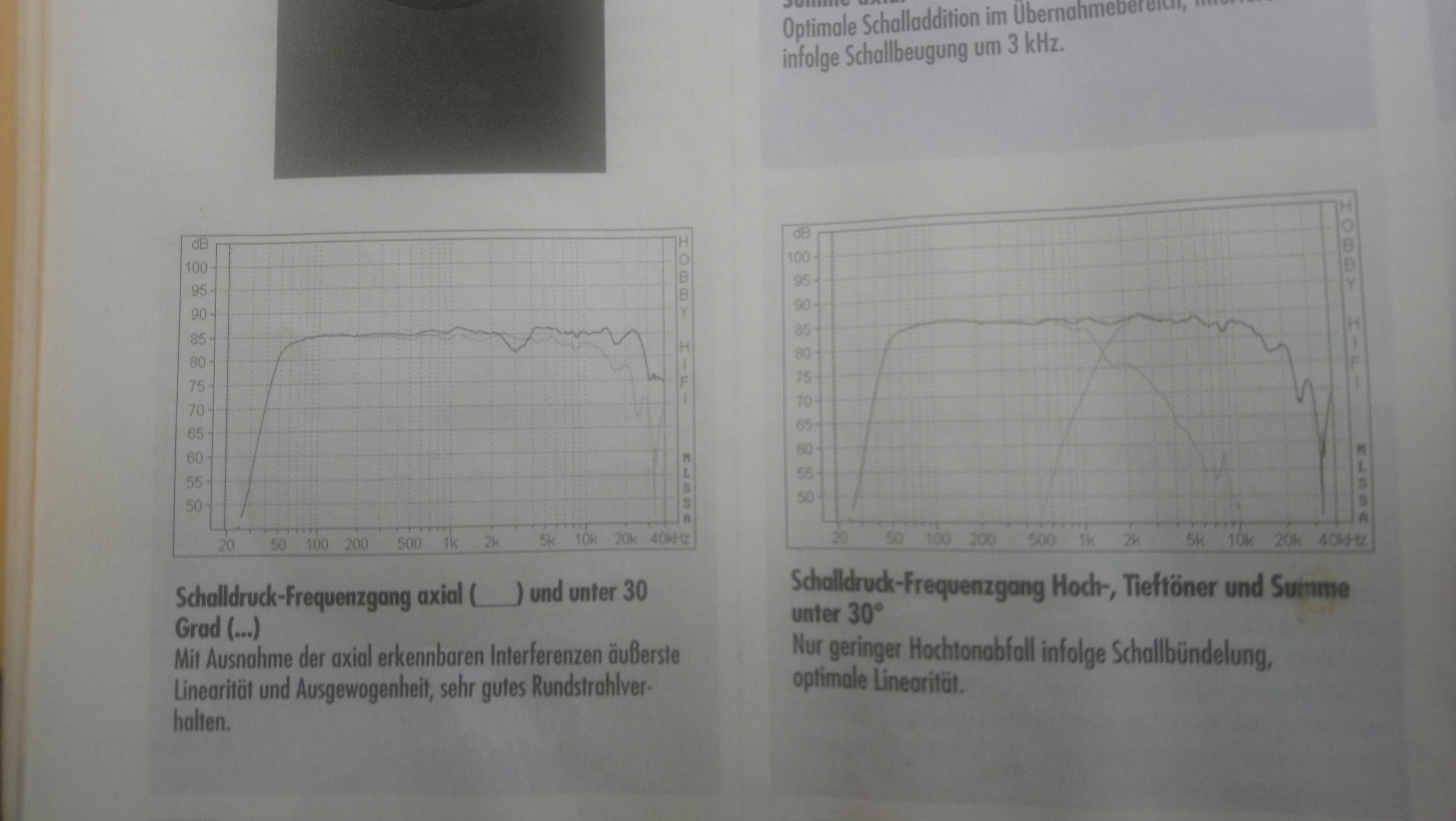

Same artefact is observable on the measurements in first post of this thread - just more obvious because you are using gated measurements and different grid resolution.
Try to measure it 30 degrees off axis. It could be diffraction related issue.
HobbyHifi baffle H40xW20cm Wavecor WA06...
Thank you gentlemen. I see the dip there in the hobbyhifi measurements too.. My baffle is 10" wide x 16.75" tall. The overall tower is 41" tall, same width as baffle. 3/8" roundover on sides of baffle, sharp edges on top/bottom of baffle.

Yes, it's definitelly a diffraction on axis. It would need much more than 19mm roundover or 45 degree chamfer to mitigate it. I wouldn't hack the cabinet just yet. I'd see what can be done with some felt. There is really interesting read at David Ralph's speaker pages about diffraction control with felt pads.
