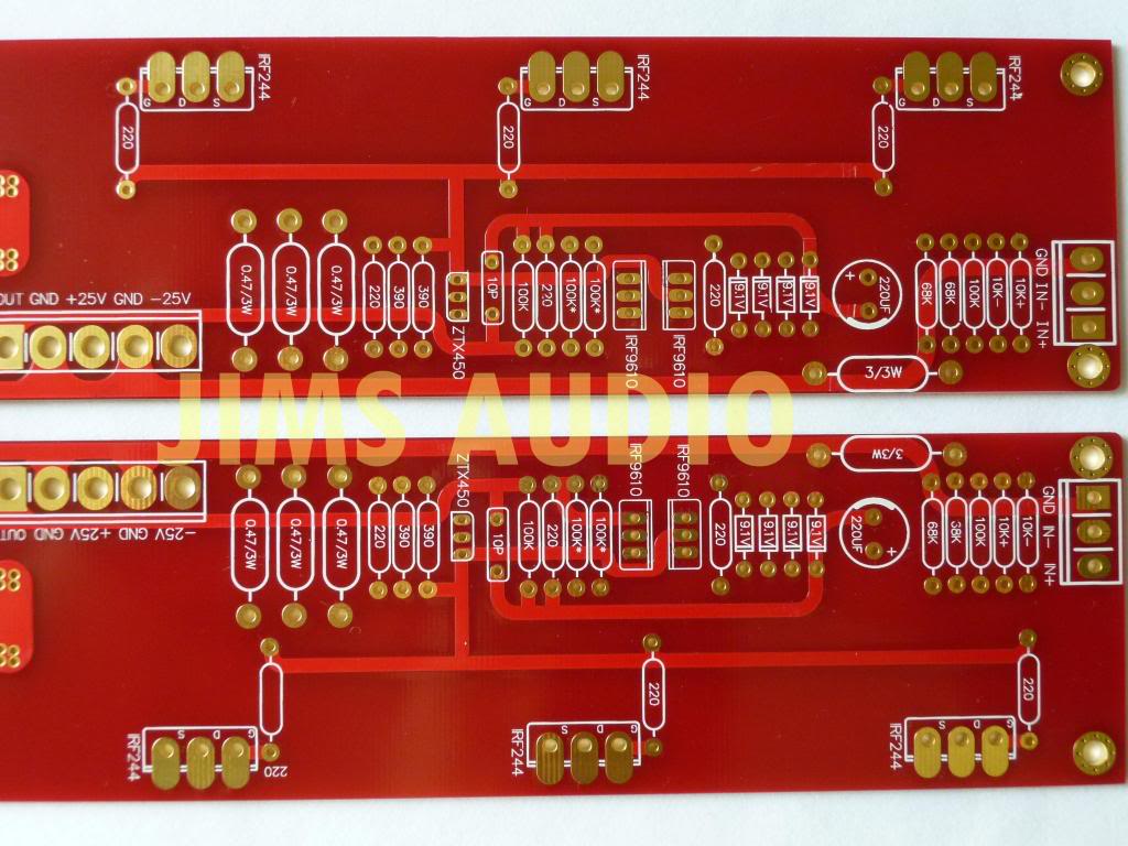

Finally got back to this !
Hi Gents,
finally got back this as the warm weather is here and I don't need the extra heat of the XA 160's 🙂
Got it all running of sorts . One channel running perfectly , heat ,sound !
The other channel ,no heat and distorted sound . Trying to trace the fault .
I'm hoping someone can help me trace the issue step by step ?
I have been struggling for a few hours as they are boards from ebay and probably not sanctioned copies so I've not wanted to incure the wrath 😉 I can't get on with Brian's boards ..... too small for me .
I have 30 VDC rails from the PSU .
This is the Schematic I got with the boards :

triple check values of all resistors , orientation of little bjt bstrds ( big ones even if you intend , you can't mix how to place them
also zener etc
also zener etc
gnd both inputs , no load on output
confirm what voltages you have at appropriate positions in orig schm ( you posted above)

Got it .... I had the 47k and 4.7 k in the wrong place .... bloody eye sight ...
Thank you again , Richard
