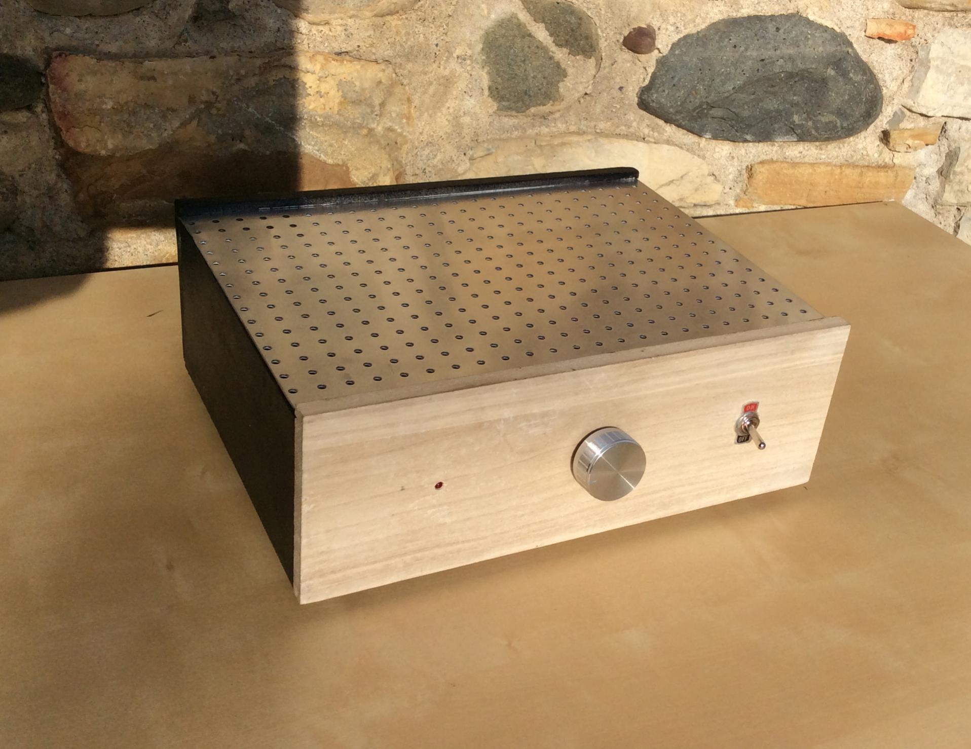

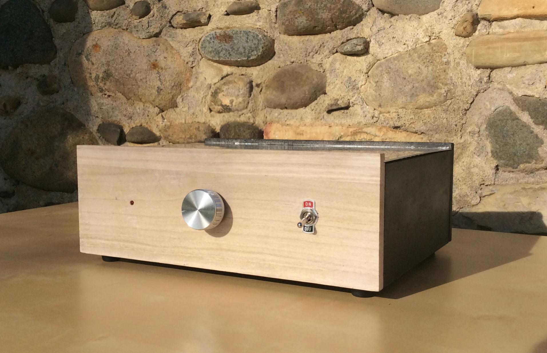

Yes, same here! It’s been a while, but so worth it and I’ve learned so much. I don’t know whether I’d have tried it if it wasn’t for a lockdown, so every cloud....��. Also if Mooly hadn’t stepped in and helped me the way he did I would probably have given up. And I’m not going away yet either!
Here's what it looks like. It's in an mdf case with a perforated aluminium top and a wooden front. It sounds just SO good! I am slightly surprised I have to turn it up quite a way to get it loud, but there's no doubt the quality is there 🙂

That looks great 🙂 so there is no stopping you now 😉

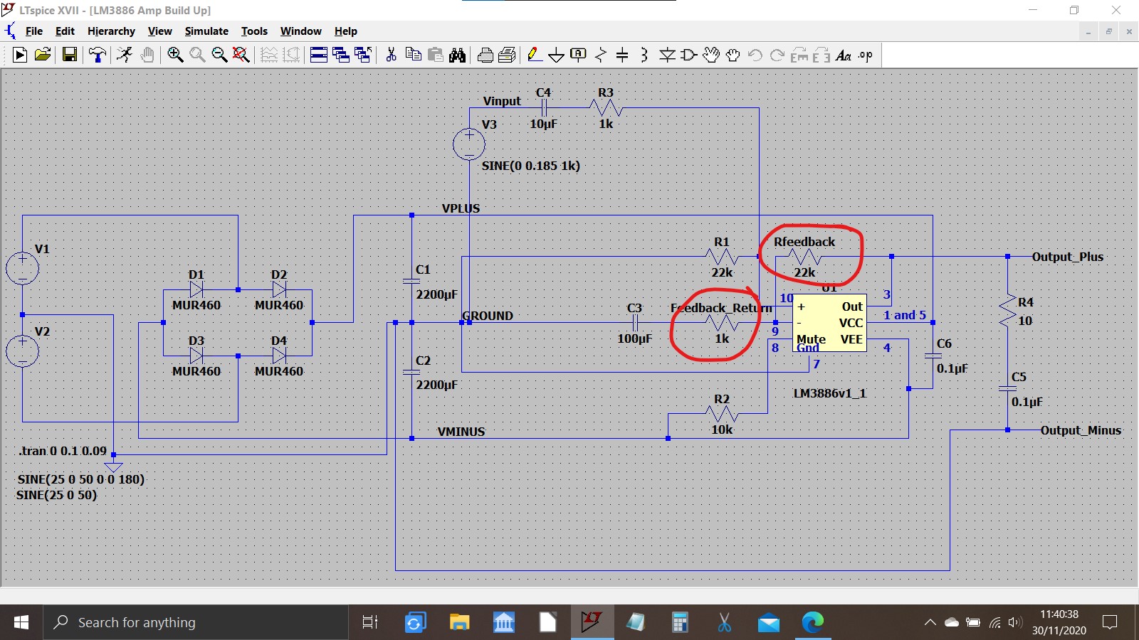

Secondly, if you find that even on full volume it is not going loud enough then that means that the amplifier isn't sensitive enough for the source you are feeding it from.
You have two choices with that... either add a preamplifier or increase the gain of the circuit you have. Increasing the gain is easy...
The two resistors circled on the diagram set the voltage gain and it is calculated as (Rfeedback/Feed backreturn)+1
So we have (22000/1000) + 1 which is 23.

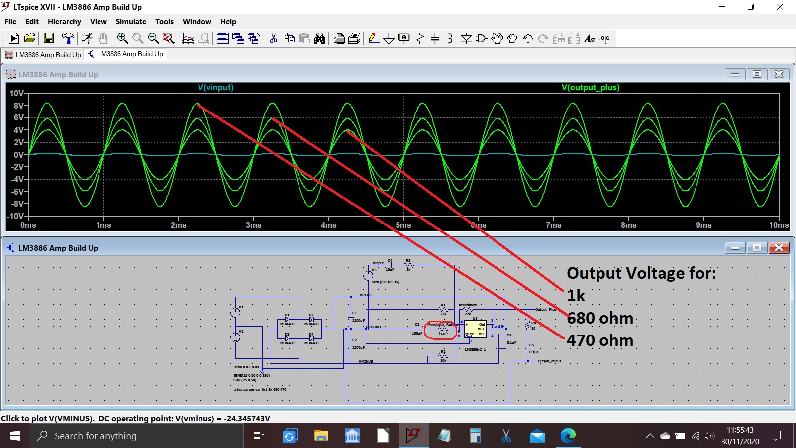

If you want a bit more gain then you could reduce the 1k a little to lets say 680 ohm. That would give a gain of (22000/680) + 1 which is 33.
I would advise you keep the 22k as it is so as to preserve the DC balance of the amplifier.
Do not make the 1k to low in value although even values down to 470 or even 330 ohm should be OK.
Also never make the 1k much higher (which would reduce gain) because the circuit relies and needs a minimum gain factor to be stable. Higher gain is often more stable and some argue actually sounds better because of the lower feedback factor.
If you change anything then always try it with the bulb first just to be sure all is OK.
