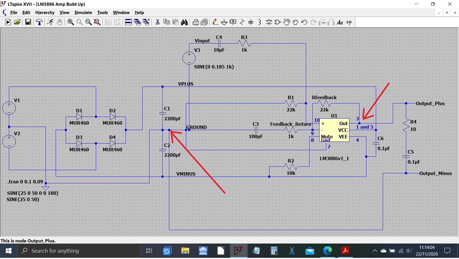

So the next step is to wire the chip to the speaker socket.
1/ Connect a wire from the left hand section of the short ground stub wire to the negative speaker terminal. This is important. The connection has to be further toward the left (so nearer to the large reservoir caps) than all other ground connections made so far. The actual distance doesn't matter, just so long as it is more toward the big caps.
2/ Connect another wire from Pin 3 of the chip (which is the output of the chip) to the positive speaker terminal.
(we have already correctly wired the Zobel network so ignore how they look on my diagram)
3/ Switch the amplifier on and confirm the DC voltage as measured across the speaker terminals is close to zero volts.
Assuming that it is you can now connect a speaker to the socket. Read carefully... we connect the speaker across the terminals while the amp is still ON.
The speaker should remain essentially silent although you may hear a tiny hiss if you go up close to it and/or a tiny level of hum.
If that is OK then disconnect the speaker and turn the amp OFF.

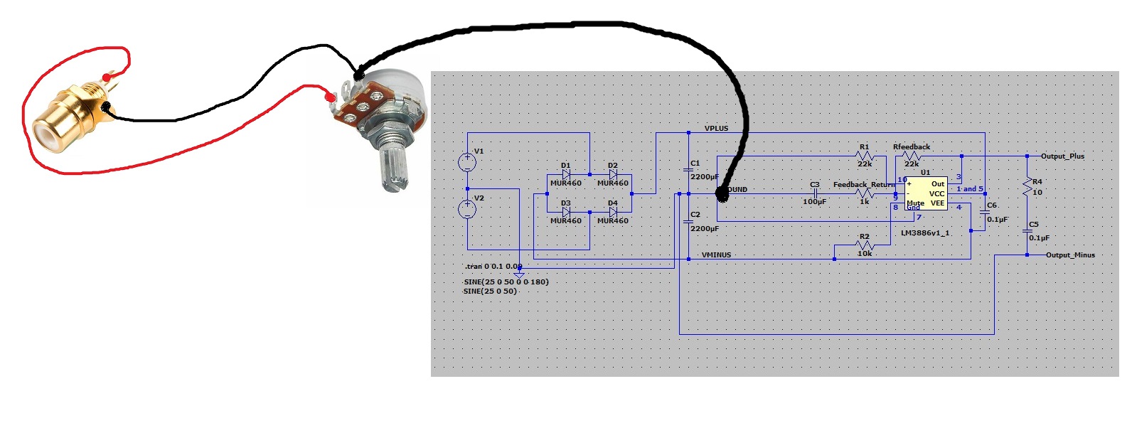

So now we wire one of the input sockets up. I'm assuming you are using RCA sockets (phono sockets).
1/ Connect a wire from the ground part of the socket to what will be the ground tag of one gang of the volume control.
2/ Now connect the ground tag of the volume control to the clean ground which is the right hand end of the stub of wire as shown.
3/ Connect the other end pin of the volume control to the centre input pin of the socket as shown.
Follow the diagram:

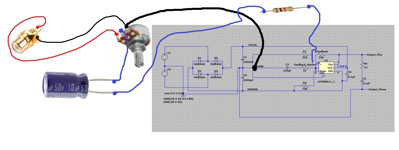

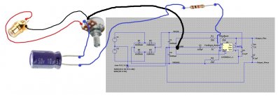

Now we connect the middle pin of the volume control to the chip.
1/ Connect a 1k resistor onto pin 10 and close to the chip. This is the non inverting or '+ input'.
2. Connect a 10uF cap to the centre pin of the volume control. The cap can go either way around at this stage.
3/ Connect the cap to the resistor as shown.
Note... try and keep the resistor as close to pin 10 as possible. Use the resistor leg itself to solder to the chip in order to keep it close, no need for actual extra wire. I've only shown wire in the diagram to show the connectivity.
Solder the capacitor lead direct to the volume control and only use wire to link the two parts.

Turn the volume to minimum.
You should now recheck the DC voltage at the speaker socket is still zero (no speaker attached). Keep using the bulb at this stage.
If that all is OK then switch OFF.
(With the amp OFF you should read almost a short circuit (zero ohms) between the middle pin of the volume control and any ground point such as the outer part of the RCA socket. This just confirms you have the control wired correctly)
Connect the RCA socket to a suitable source such as a CD player and play a disc.
Switch the amp ON.
Now connect the speaker.
Now turn up the volume.
