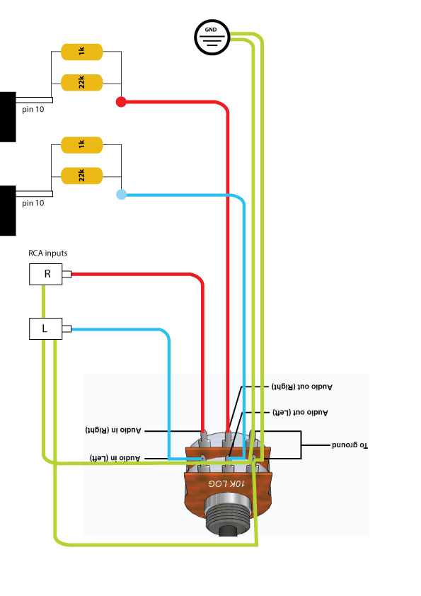

Diagram in post #97 is totally wrong. You have the resistors in series and incorrectly connected.

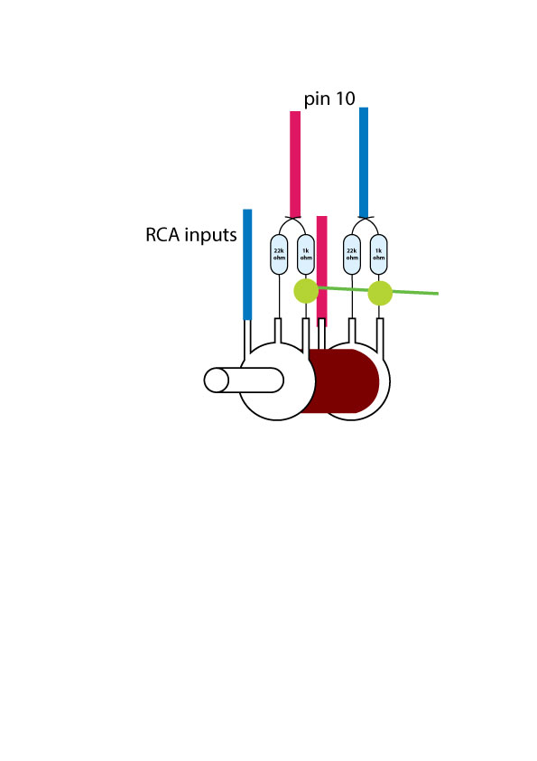

This is how I originally had it and this is what I copied from the person who posted the instructable I am following (https://www.instructables.com/Make-your-first-Serious-Amplifier/)
You are tying yourself in knots with this. What you have just posted looks wrong as you appear to have pin 10 going to ground via a 1k
Listen 🙂
Forget the inputs for now. Just connect pin 10 to ground via the 22k and see if the amp powers up correctly and silently. Use the DBT.
Listen 🙂

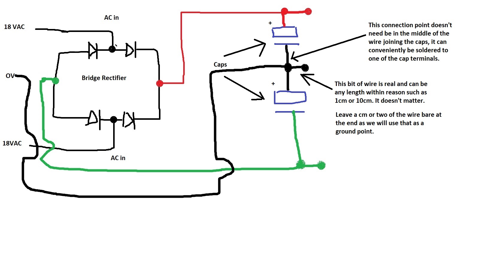

So I need you to end up with the bridge rectifier and two big reservoir caps connected exactly like this. The AC from the transformer comes in the left and you have the split rail DC output voltages at the right.
When powered on the bulb should flick brightly for an instant and then go out.
This is the boring bit 😉 but we have to build it up in stages.
When you have tested it and made sure the DC voltages are OK on the caps (which will be around + and - 25 volts if the transformer is an 18 volt type) then switch off and discharge the caps with a resistor. It will take quite a few seconds with a 10k for example.
You start with the power supply complete with bulb tester and we first make sure that is working OK and configured correctly.
I know this is all going back to very beginning but its the only way to do it.

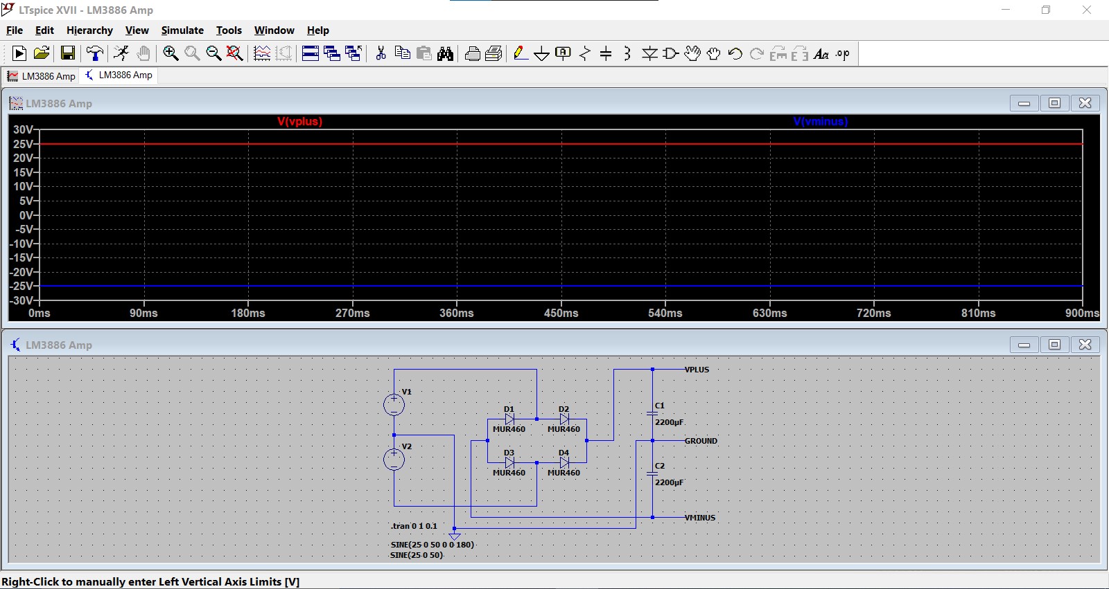

It is going to be easier for me to draw this using a dedicated program. This shows the configuration and also the actual voltages you should see.
V1 and V2 at the left represent the transformer windings.
The DC voltages can be seen on the graph and this is just how an oscilloscope would display it. There is plus 25 at the top and negative 25 at the bottom.
This is a working simulation and so we will build your amp up and prove it works 🙂
