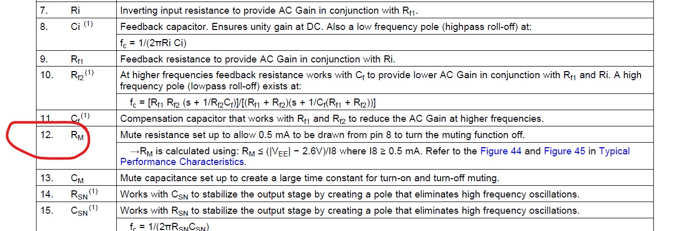

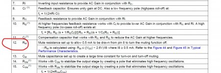

Pin 4 is the negative supply and so should have your negative 28 volts present.

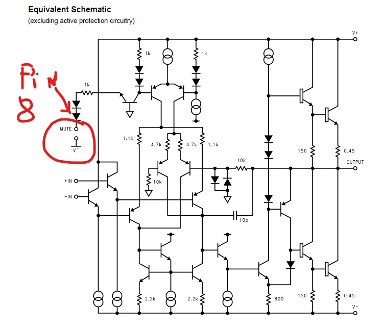

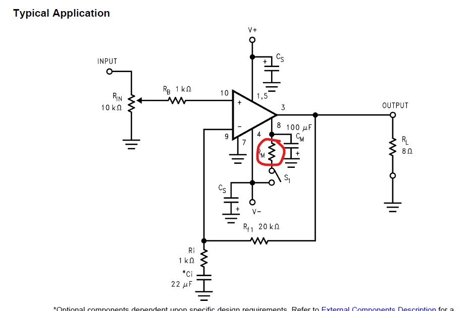

Pin 8 is the mute pin and should as mentioned earlier be configured in accordance with the recommended components. As a minimum pin 8 should connect to pin 4 via a resistor the value of which is chosen to allow at least 0.5 milliamps to flow. This disables the mute.
I don't know how the LM3886 handles a direct connection there and what sort of current may flow. I suspect the chip will be OK (as in not damaged) but it definitely isn't recommended.

It is hard to know what to advise for the best here. If you do rehash things then please connect the mute pin as per the data sheet and not just directly to the negative supply.

Hmm..I could try. Maybe insulating a probe almost all over except the tip? BTW my pin 8 definitely has a 10k resistor between that and pin 4, it just looks like it doesn't connect to anything after that.

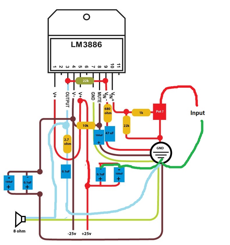

Hello again, not given up yet! Here's what I have done to better understand the schematic. I've drawn my versions of both the power supply and the amp. Could someone look them both over and check that it does exactly the same thing as the original schematic please? Originals are here:https://www.instructables.com/Make-your-first-Serious-Amplifier/
These are my interpretations...
As you can see, I don't understand what goes on exactly with the potentiometer.
So...
The pot is OK as drawn. The middle pin of the pot goes to the 1k as you have it. Ideally you should AC couple the 1k with a cap of say 4.7uF but it will all work as shown... at least the pot will 🙂 The audio will feed into the top of the pot (you haven't shown a connection there) and ground.
There is an error with the speaker wiring coming from the chip. Can you see what it is?
And your positive +25v supply is incorrect as well 😉 Those two caps will do a great job of blocking the supply.
The speaker wouldn't have both connections? What I mean is, one would have the connection from pin 3, the other speaker connector would have the ground? I've only drawn one. Is that right?
As for the +25v supply, I thought I'd just copied what happens on the author's original sketch. Obviously not 🙁
That looks better.
If you build it like that then it should work. Once you have it in that basic working state then we can tweak the little things such as AC coupling the input and perhaps adding a coil in series with the speaker feed.
As it stands though it should work.
I'll look in later...
OK
And remember to use the bulb tester and to test initially without speakers. Only connect speakers if the DC voltage across the speaker terminals is very close to zero (under 0.1 volts ideally... yours may be a little higher because the input is not AC coupled)
