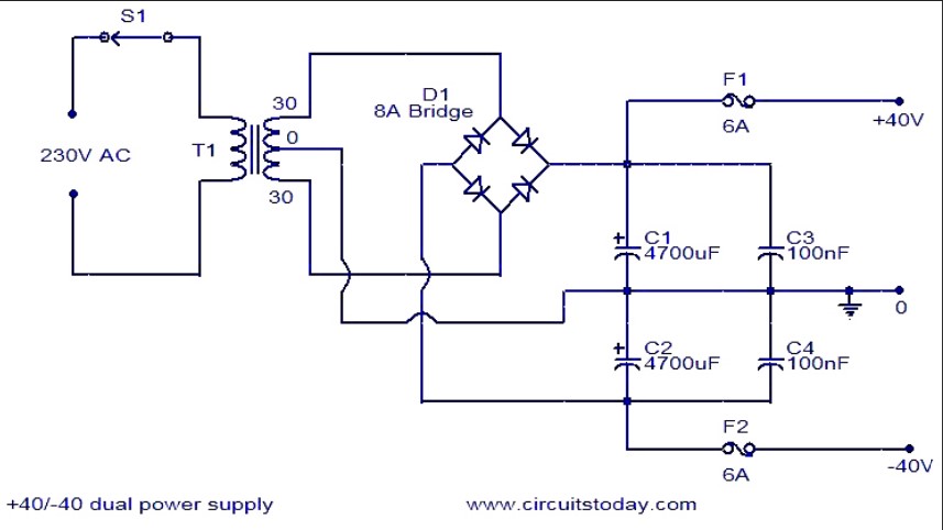

Complete novice alert! *don't read if easily annoyed by stupid questions*
The yellow/blue stay joined and become the 'zero' or 0V ground connection as shown here (generic circuit off the web).
The red and green go to the rectifier and it doesn't matter which one goes where.

Lets begin with the power supply and transformer. Is that wired up correctly now to the rectifier and reservoir caps?

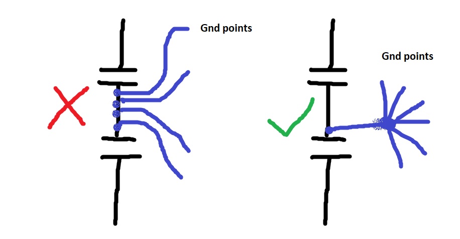

The blue connection joining the two caps becomes the 0 volt or ground point, however it is very important that you do not connect multiple individual wires to this connection but rather take a single spur off that wire, the end of which becomes the true ground reference point. It is all to do with high charging currents flowing in the blue wire and these will cause hum and buzzing if you just randomly connect to this.
So connect a single wire taken from any point along that common connection (it doesn't where or which end) and use the end point of the new spur as a common ground point.

Be sure you understand the spur principle.
I'll answer that by saying that if you must then take another spur of the existing one. Don't add another to that common connection between the caps.
The whole object is to prevent the volt drop that occurs in that common connection from generating unwanted voltage between ground points in the amp. Although the voltages may seem miniscule it is these very voltages that are at the root of most hum and buzzing problems in amps.
