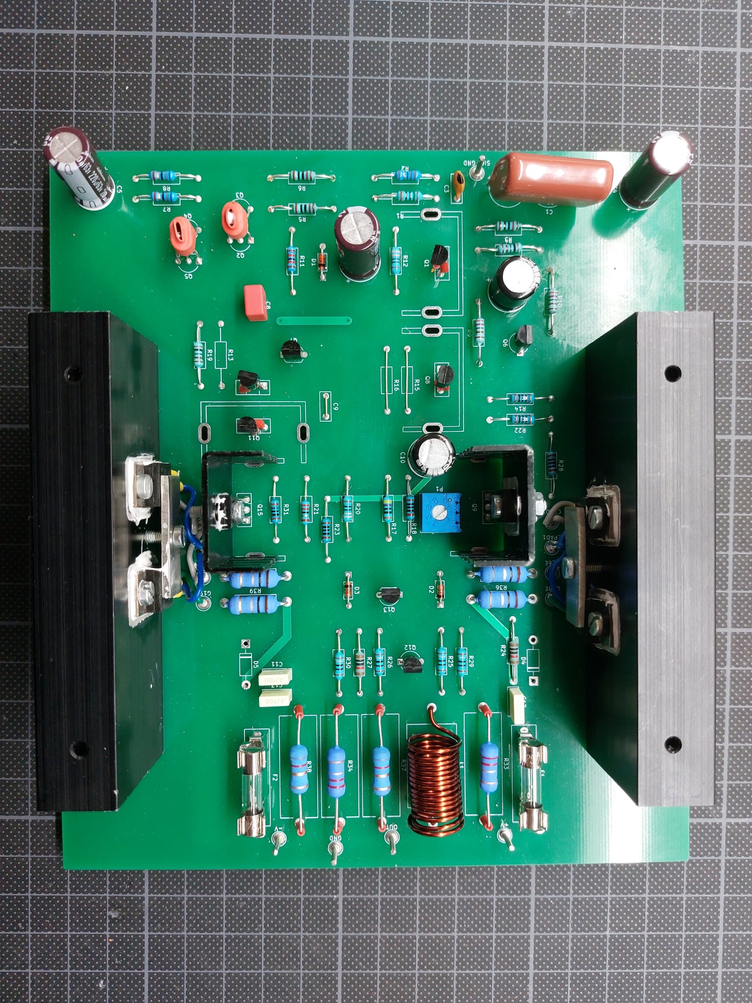

Can you post a photo of the thing? The way you wire it and the layout can have as much impact as component values. When touching heatsinks causes oscillations you know you are in serious trouble.

Sure, here's a pic of the finished amp and the Gerber files if your interested.

I'm very aware of that poor design can lead to issues like this. And therefore I used the exact layout as for fig 6.11 in Randy Slone's book "The Audiophile's Project Source book" (except that I substituted the jumpers with layer 2). That amp is a much bigger amp, but the schematic is almost the same, except for the components values and the bigger amp also involves a tho pole compensating capacitor network for the VAS. That's why you see some jumpers instead of resistors and capacitors at my board. This is also why the legs are twisted of some of the 2N3904/06, the bigger version uses 2SB649/2SD669 here instead which are ECB devices.

Can I assume your sig gnd and speaker gnd are not connected on the PCB, and they are connected at a single star point at the psu?
I don't like the distance on the pcb between Q3 base and R11 and R12. The base of Q3 is extremely sensitive...any noise there gets amplified by the full open loop gain. The copper traces attached to Q3 should be as short as possible.
C3 is too far from Q2. The purpose of C3 is to AC ground Q2 base at HF.
And then C8 is sort of out there on its own.
No point going any further. Too many layout provocations for instability for me. Is this the same component spacing in Randy Slone's layout?
Yes signal GND and speaker GND are both connected to the PSU GND at a starpoint.
Isn't C3 a lowpass filter just in combination with R1?
I can agree that there are some questionable things about the design. But yes, it is very identical, also in scale including component spacing to the layout from his book "The Audiophile's Project Sourcebook" (don't want to post it here for to copy right reasons). The design in his book was makde for single PCB, and using DIY methods for manufacturing. Which may explain the very generous spacing and so on. But I thought his the expert so made an order for 5 pcs to try it. There are some things i may change if I go furhter with this design thoug. Traces around Q3 may be a good idea.

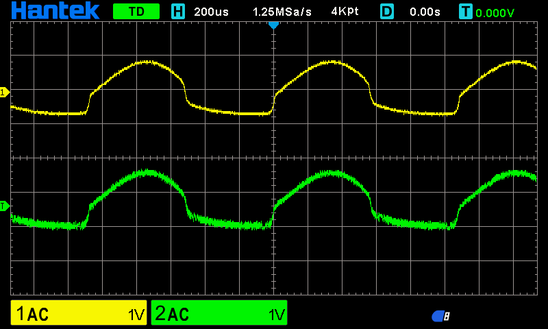

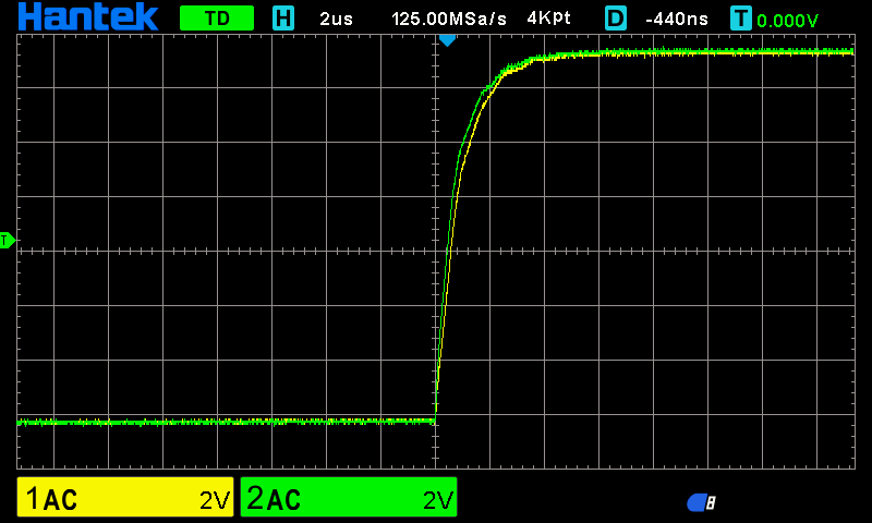

Today I finished building another identical board for the other channel. Having the opportunity to have to identical boards to compare I started to do some experimenting. First I tried some different combination of emitter resistors for the drivers, none of it had any effect. Maybe a little worse actually with 10 emitter resistors.
Nor had I any luck with two pole compensating capacitor networks. Nothing I do, except for increasing the degen resistors in input-stage apperad to have any real effect at stability. And any lower value of compensating capacitor C8 than 100 pF was still not possible.
However, you were right again @WhiteDragon about R3. I selected the value 120 ohm after reading Randy Slones book "High Power ampifier construction manual", a great book were the compensating cap and current of input stage is described in detail. And after som calcualations came up with that the current should be around 4-5 mA. But I noticed that the amp with 120 ohm for R3 (wich was the only different at this point) had - 1 mV offset at the output and the other one with 330 ohm for R3 had +1 mV. As you sad, it should be positive.
Also I could here this hissing noise again from the board with the negative offset, and located the source of it the heatsink of one of the driver transitros Q15. So after some probing around, I found this at the driver transistor emiiters;
This is at Q15, channel 1 has R3=330, channel R3=120 ohm.
This is at Q8, channel 1 has R3=330, channel R3=120 ohm.
After changing to 330 ohm for R3, this disappeared and offset was +1mV at both boards. Compared to the one with 120 ohm, the slew rate was not decreased very much that I could se (which could be the downside of too small current for input stage according to Slone). Here's the response for 20khz square wave, channel 1 has R3=330, channel R3=120 ohm.
After all this tweaking with components values, I believe that I've found some middle ground that actually works. Changing some values instead of trowing in a lot of capacitor makes more sense to me. It still bothers me that it didn't worked from the start as Slone guaranteed that it would. Maybe he got sloppy and copied some component values from other designs, or printing error. I'll never know probably. Thanks for all the support, I learned a lot of this.
