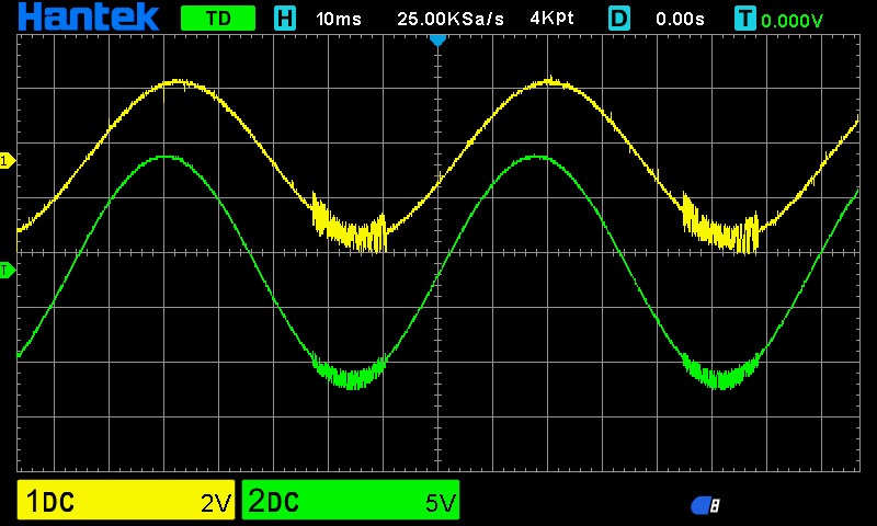

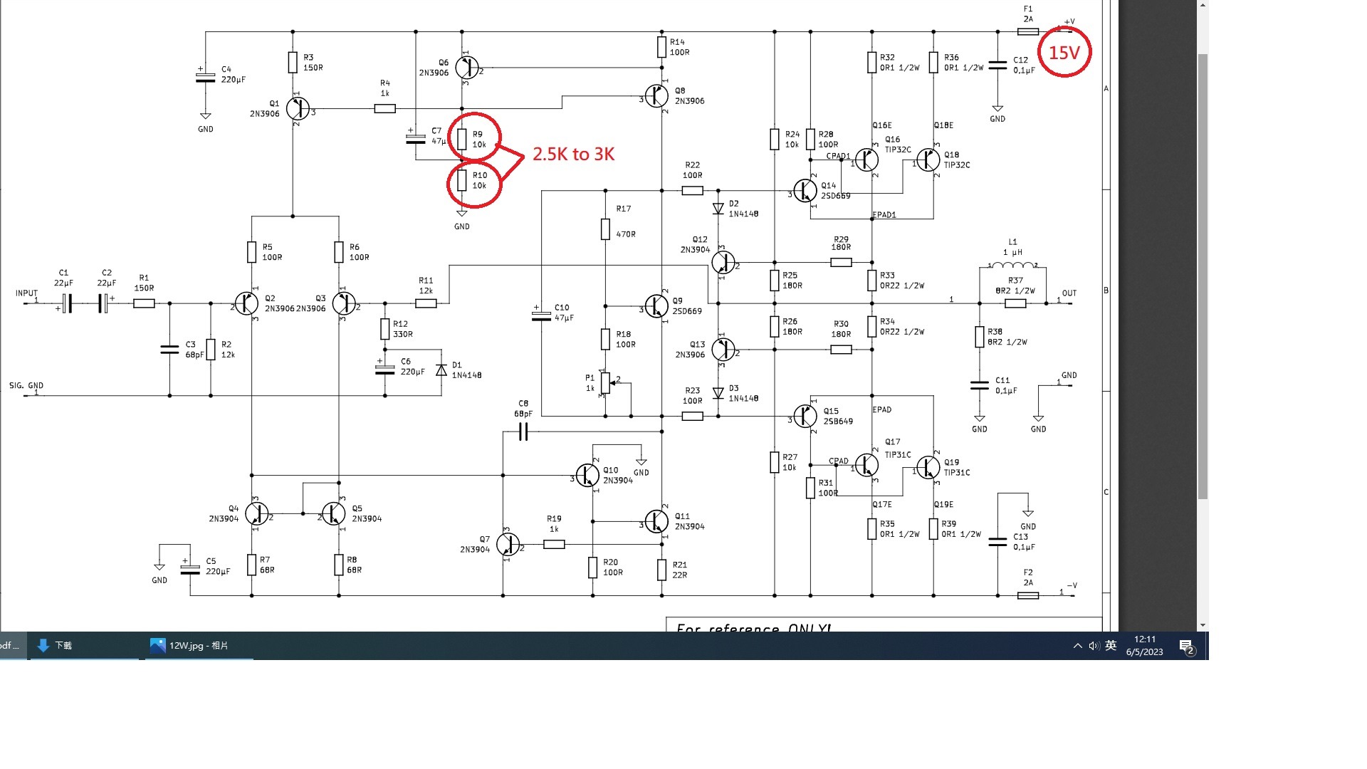

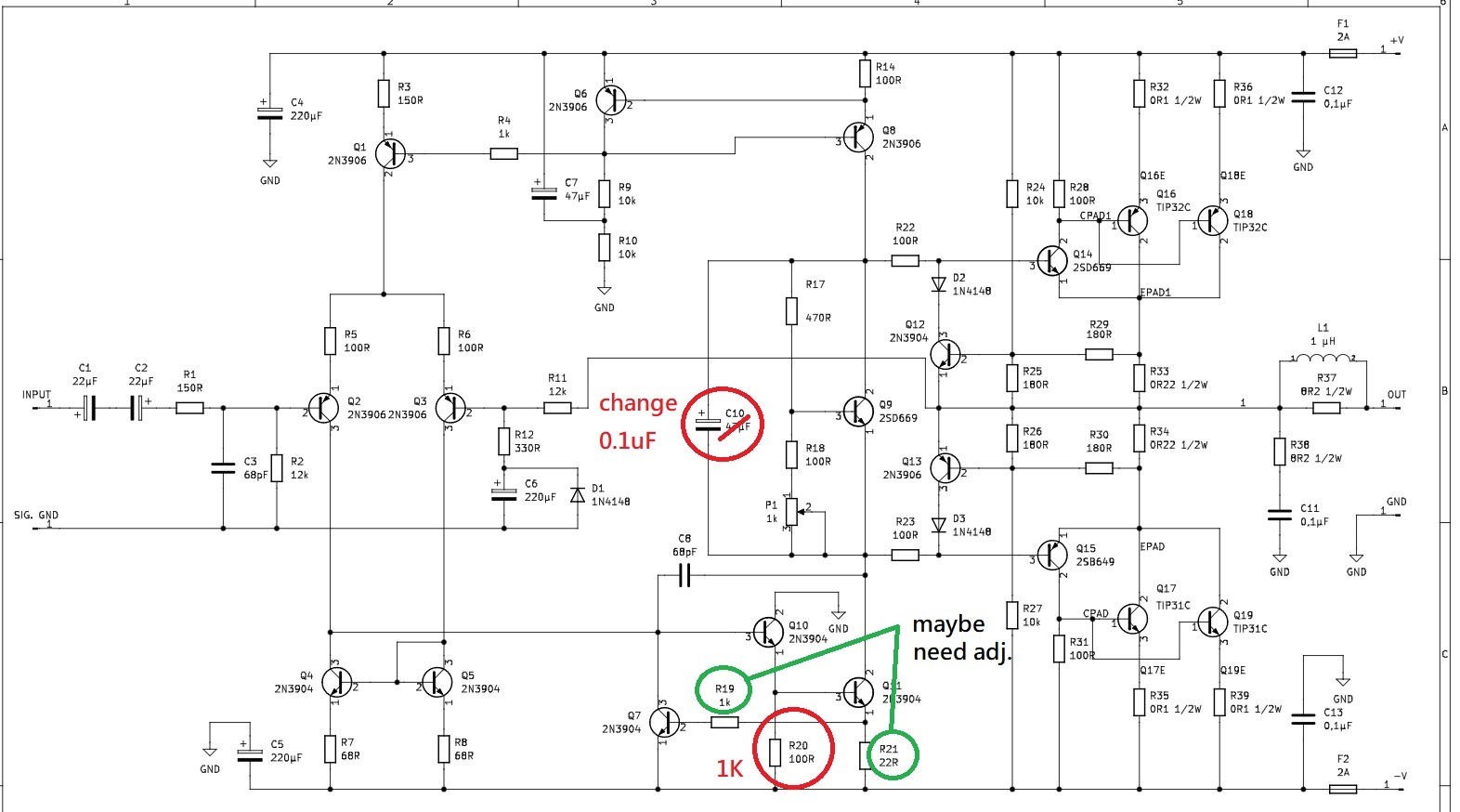

Complementary Feedback design amp oscillating problems
Interesting point. I wonder if increasing R12 to 470 to 560 would help. This would increase the negative feedback and reduce the closed loop gain to a more typical level. It looks like the closed loop gain is somewhere in the 30's right now. I think 470R to 560R would put it somewhere in the mid to high 20's.
Maybe this would help?
I'm defining the excess loop gain as open loop gain minus closed loop gain. So it's better to increase the closed loop gain rather than reduce it. Better still to reduce the open loop gain. In general, the excess loop gain reduces the total distortion, but it's at the price of stability.
Stepping back a bit. The excess loop gain in any circuit is what causes instability. Ultimately, the sure way to improve stability is to reduce the excess loop gain. This is always an option.

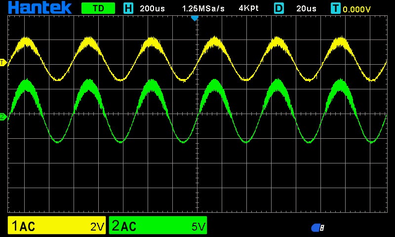

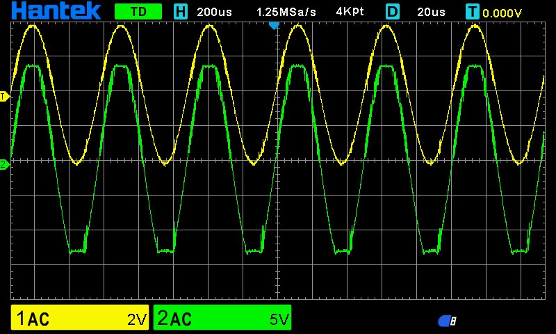

Yes of course. I tried with by bypassing R11 with some other resistors (lowering the total resistance) which reduces the overall gain of the amp. The interesting thing is that, then the ringing at the positive side disappears. But only because the output level drops due to the decreased gain. Then the input is increased so the same output level again, the curve looks exactly the same again.
Also tried putting resistor across R11 in the NFB loop, but that only makes it worse. Adding I resistor in series the the cap works. But only by lowering the overall gain.

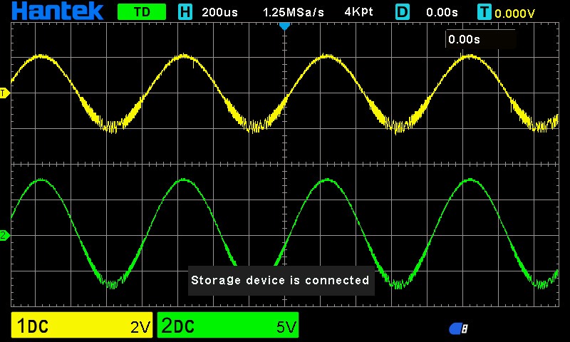

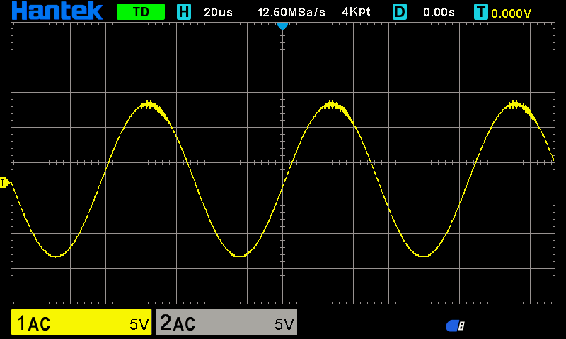

This is what I'm trying to make disappear;
So annoying, feels like it should within reach to get this working. Just getting rid of these ringing and it may perform pretty good actually. Adding more capacictance to the compensating cap C8 does the trick, but it's already at 100 pf.
Sorry read your post first after posting my previous post. How do you mean? The closed loop gain is set by the NFB network I guess. But the open loop gain? What sets it?

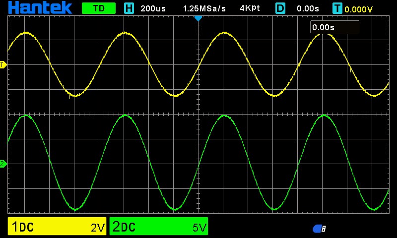

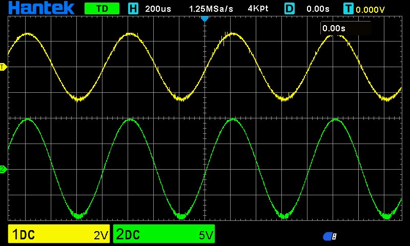

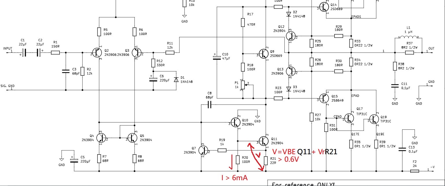

Well after a lot of more trying and error I finally got rid of this oscillations, without increasing the compensating cap C8. Tried everything suggested by @WhiteDragon in previous post but nothing really had the effect I hoped for.
  • C10 changed 10 100 and 10 n, did not have any effect, stuck with 10nF
  • Changing R20 or jumping R19 had very little effect as well
  • Degen still the same story, work but kills the slew rate.
However It has to be something with the output/driver/VAS area my suspicions was. Also changing the bias current to the extreme took care of the ringing. So i put in a extra resistor (R16 in schematic) in the bias network. This didn't help until I put a cap in parallel with it. The value of the cap seems to be very picky, not to small, not too large. around 2n2 and the ringings no longer visible (with my crappy scope at least). I'm not sure why this actually help, so if anyone know, please tell.

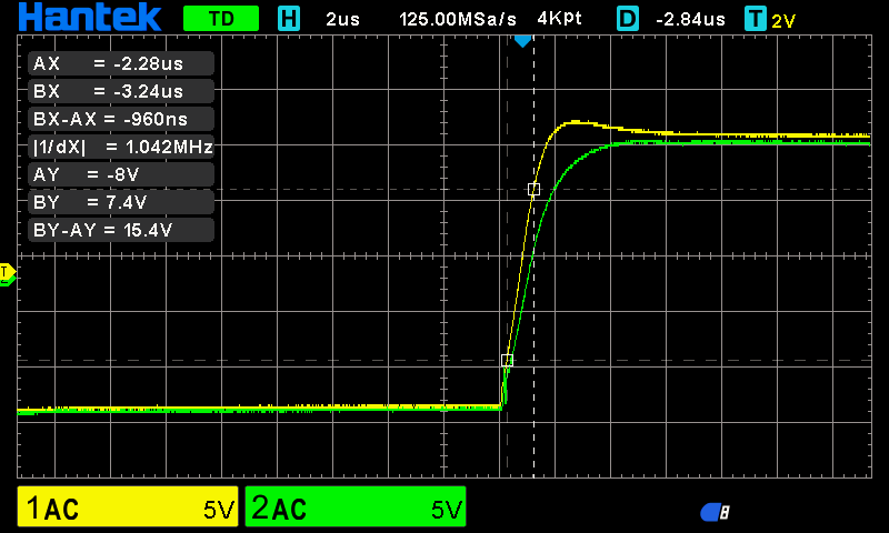

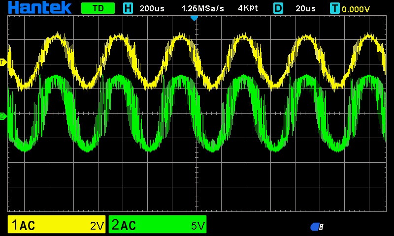

Below is the square wave response of 20khz, into 4 ohm. Channel 2 is amp with TIP's for comparison. I agree it looks like it close to the limit of being overcompensated. Sine wave response look good know without any ringing.
However I think this is as far I'll get with this design (I also have to leave two weeks for work now). Maybe I just go back to the TIP's, I think actual listening and (maybe) distortion analyzing will decide. Thanks a lot for all of your help and input.
The resistor R16 is known as a current compensation resistor. It’s value is picky and 22R is in the right ballpark for a CFP OP. It offsets Re in the bias transistor Q9. It’s intended to make the bias voltage more stable.
Not sure why the cap helped. Make someone else has insights here.

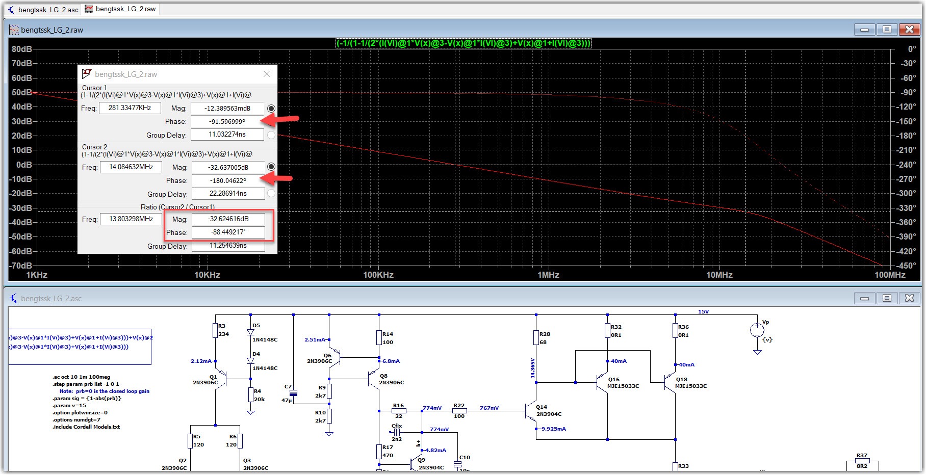

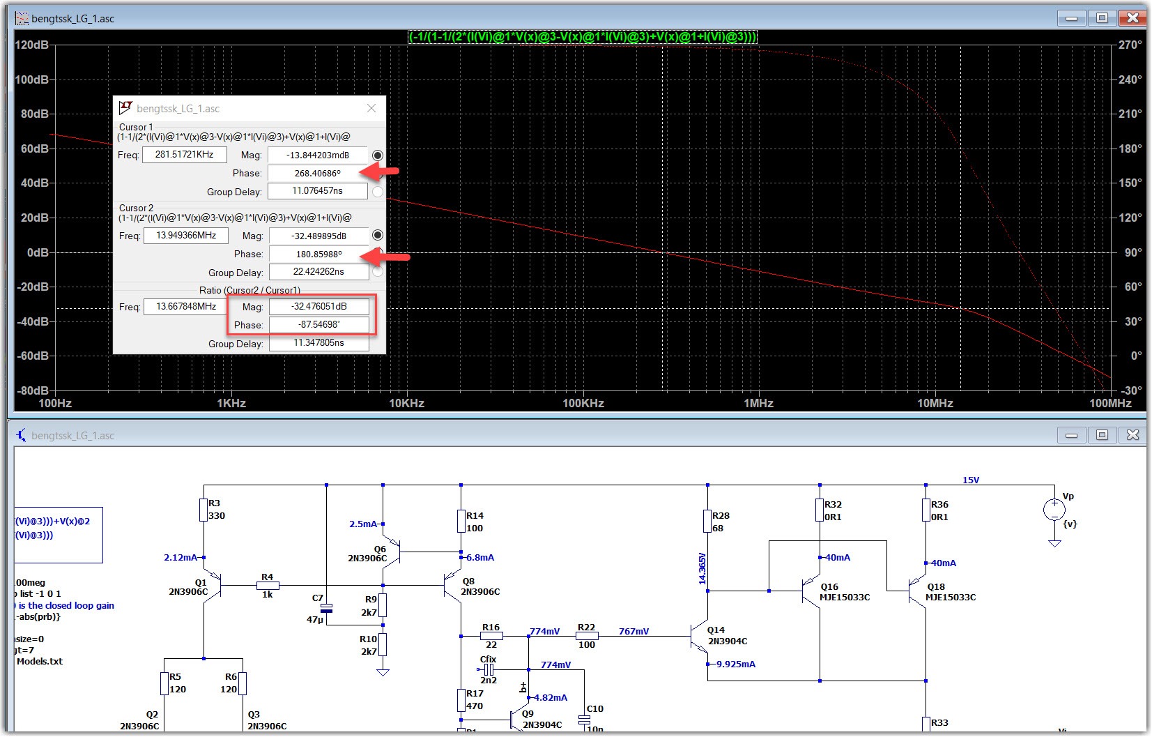

I simulated this design and checked the loop gain. I'm not sure how to interpret this... The 180 degree point for checking margin is inverted. If I replace the IPS current source with separate generator, the phase margin looks like what I would normally see.
Is this normal for the as-built version with the IPS and VAS current sources tied together?
I attached my asc files if anyone is interested.
Original
With separated IPS current source

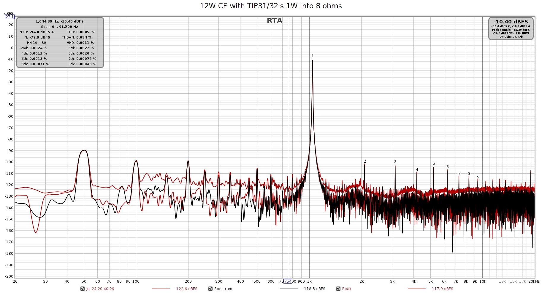

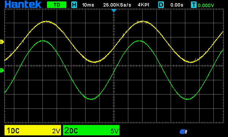

Finally got some time to finish this project. Had to abandon the MJE15030/31 design since I never got it stable enough. The TIP31/32 version seem to work ok and passed the "capacitor-test".

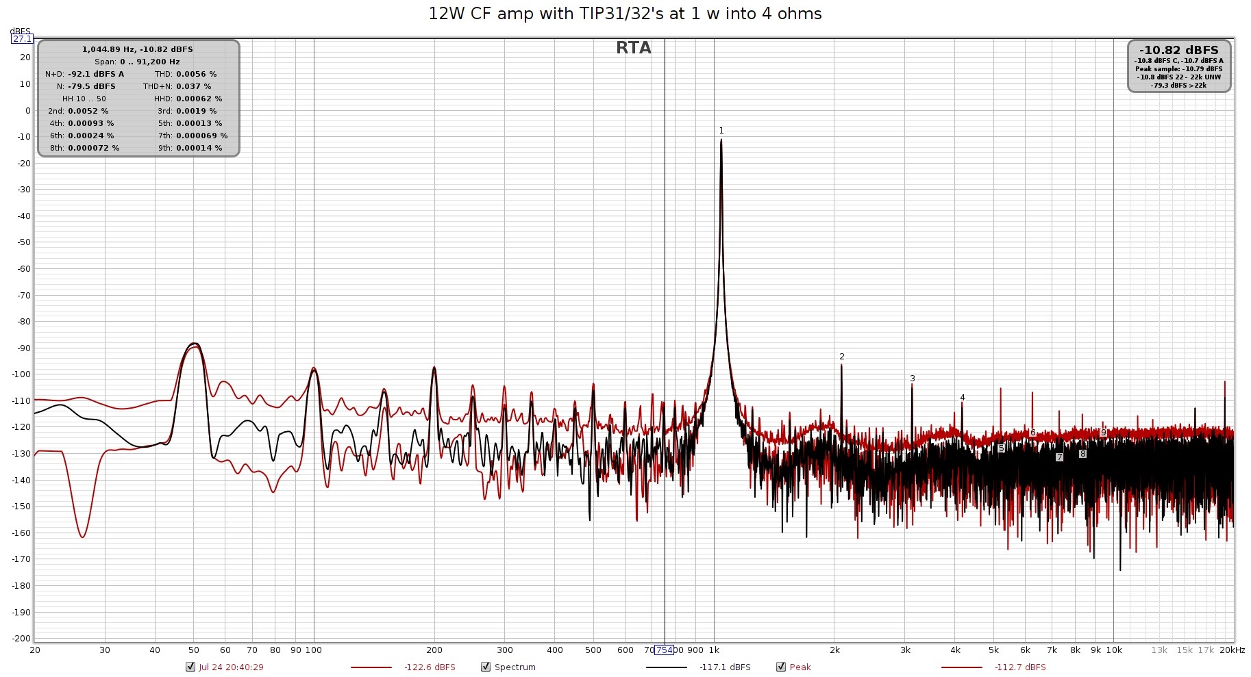

After building low distortion signal generator I could finally measure the distortion of the amp. The results are acceptable, but not great I would say;
0,0045 % THD (1khz) 1W into 8 ohms
0,0056% THD (1kz) 1W into 4 ohms
Fined tuned the bias current during the test for lowest distortion. It was pretty close to preset position of 8 mV across R33 + R34, but managed to decrase the distortion a few 0,001's at the end.
