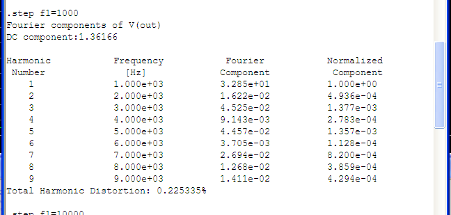

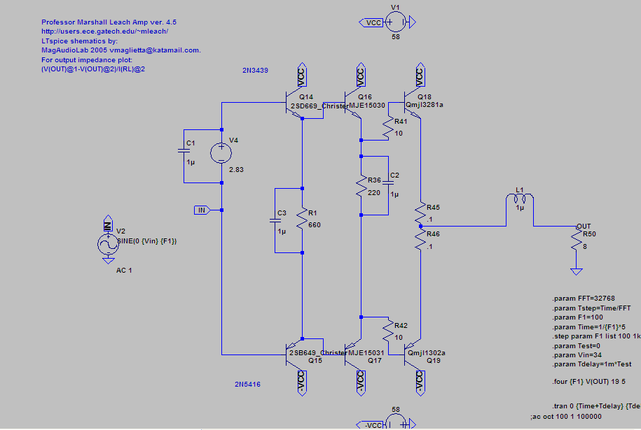

panson_hk said:
Thank you Ken. What was the output level for THD simulation? If it was not high, the transistors were probably in Class A mode with higher bias levels. See Andrew's message above.
Panson,
vin was 34v
Schematic below

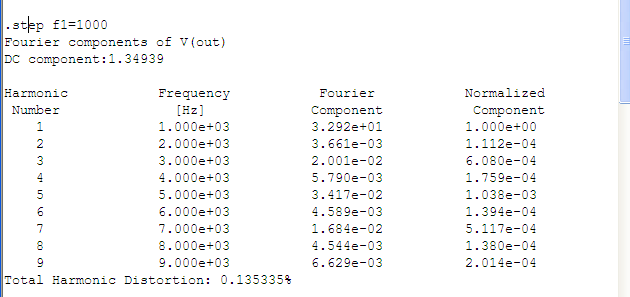

Panson,
So, I don't know what happened here... my prior sim showed the thd for the 15030 at >2% now it's better than 0.2% - I don't know why..., sorry.
Thd for the 15030/31 combo subsituted for the 2sd669 in the prior schematic.
Ken
Ken
klewis said:Panson,
Ken
Hi Ken,
Thank you for your data. Do you have .option plotwinsize=0 in your simulations?
