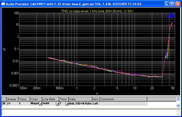

Thank you for your input. I have not simulated other pairs for pre-driver. Do you refer to THD performance? What bias level did you use in your simulation module?
Here is some data from a warm-up test. The AP has been off for a while. I run THD vs output level for a 49811 multiple times. The test circuit Fig. 3 shown in 49811 data sheet was used with gain set resistors 51k and 1.65 k; and Cc = 22 pF.

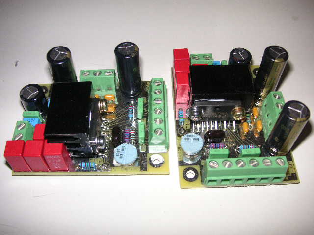

I too am designing power amps based on the LME49810. I have completed PCAs for the 810 chip, and just recently received my power output boards as well.
Attached is a pic of my driver board. It is 1/2 of one of ExpressPCB's MiniBoard service. So with one purchase, I ended up with 6 boards (6 audio channels).
My basic design is right off the data sheet with just a few changes. The output stage will be a triple-darlington emitter-follower design. Those boards are done too, and were basically free. Here's a link to my output boards and the free deal I used: http://www.diyaudio.com/forums/showthread.php?s=&threadid=145590
Thanks again for the great knowledge and technical dialog.
Paul
Hi Paul,
Thank you! Please let us know your test results. Are you going to use 4 pairs output?

I'm actually going to be using 8-pairs of TO-264 per channel. I'm planning on running the amp at +/- 90VDC and MAY try to run it full-tilt into 2 ohms. The transformers (1 per channel) are 1.4KVA, plus lots of outputs for lots of SOA should do the trick : )
foo said:Triple darlinton will be a good idea.
If they are not blown.
Why would they be blown? They'll be matched, well filtered, and properly cooled. Any advice you can recommend?
Thanks,
Paul
