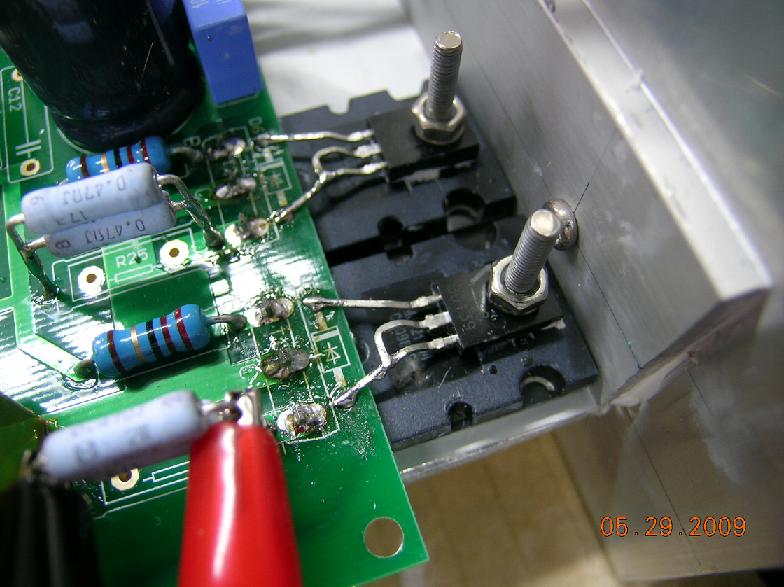

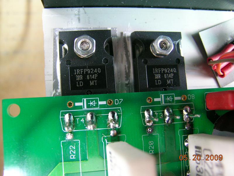

I just finished a board with 49830 and IRFP240/9240x2. There is not oscillation.
I initially used "incorrect" resistor values for VBE multiplier which can give bias voltage over 20 V! During bias adjustment, I burned the chip and all four MOSFETs.
If driver stage MJE15030/15031 is added, the amp oscillates at 20 MHz. It can be stopped by increasing MOSFET gate resistors from 22 to 100 Ohm.

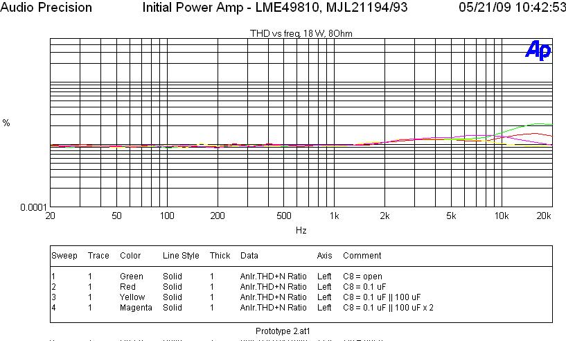

Hi Panson,
when using 811 in the driver PCB what value for C8, or should it be left empty?
C8 is the cap across the output bias voltage.

AndrewT said:Hi Panson,

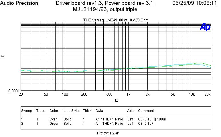

Hi Andrew,
I have data for 49810+21194/93 at the moment. Please see the curves below. The impact of C8 is noticeable in high frequencies. C8 = 0.1 uF || 100 uF gives the best result.
I will post 49811 result when it is ready.

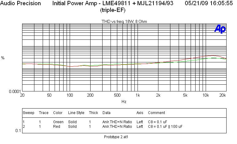

Here is 49811 preliminary result (THD vs freq, 18W, 8 Ohm). Output stage is triple-EF (pre-driver, driver and output device). The chip can not provide sufficient driving current for only one driver stage (MJE15030/31).
Without C8, there is a tendency of oscillation after excitation.
panson_hk said:After bias adjustment, THD vs freq of LME49811 is shown below. The output power is 18 W at 8 Ohm.
Very nice! What criterion did you use to set the bias?
The bias is adjusted to eliminate cross-over distortion which can be seen from THD residual.

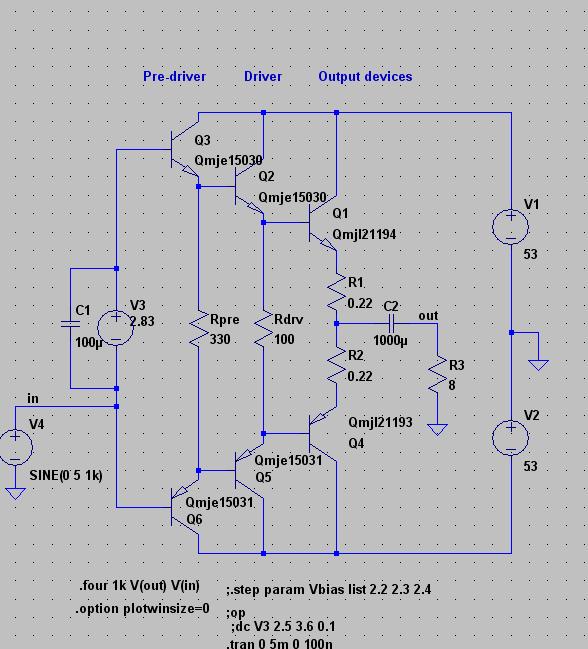

panson_hk said:I should use output triple instead of triple-EF to describe the output stage configuration (pre-driver, driver, output device).
Is that like a CFP driver? Could you please post this configuration? I would like to build a 300W amplifier...
Hi Shaun,
This is a three stages of emitter follower as the SPICE model below.
Are you going to use CFP or EF output configuration?
I was thinking of CFP driving an EF output stage... I'm really just wanting the lowest distortion output stage.

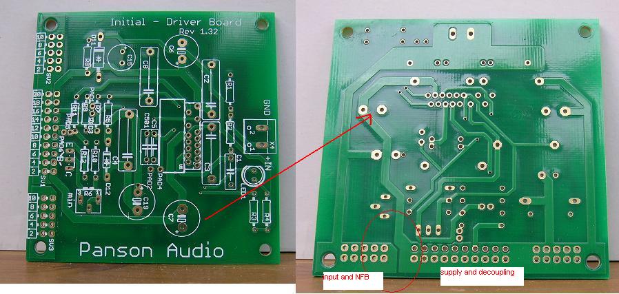

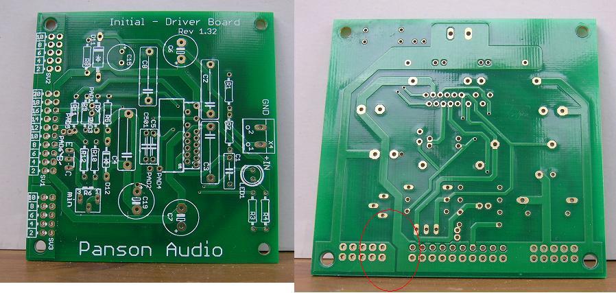

I have slightly modified the driver board. New boards are back from the fab house. Input, NFB ground and supply, decoupling ground are split as circled in the image. I have not found that this is essential for all 49810 built and tested so far. However, it seems necessary for 49811. 49811 seems to be a very sensitive chip. I am going to do more experiments.

panson_hk said:Input, NFB ground and supply, decoupling ground are split as circled in the image.
C7, the decoupling cap, is tied into the Signal Ground trace.
The old PCB had C7 on a separate trace down to the multi-pin connectors.
You still have C2,3,4 & 8 as BIG caps with a long pin pitch.
Add an extra pin hole to R6 to allow three inline pot to be inserted.
Thank you Andrew!
Decoupling cap C7 & C3 is connected to the "dirty" ground as shown. This is identical to the previous PCB. C19, NFB cap together with input ground is connected to the "clean" ground of the board.
I will definitely do multi-hole for different cap sizes in new layouts.
