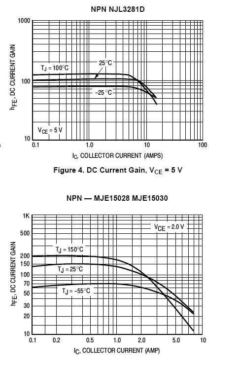

what happened to the requirement for linearity.
Very good point! Current gain of NJL3281D output and MJE15030 driver are "nearly" flat.
I don't see the reason why mess with Darlingtons, gain curve tells you all. I really do not like to impose but please try my output stage schematic and you'll hear the difference compare to all classical outputs. Besides you won't have any problem with too large output currents of LME49811.🙂

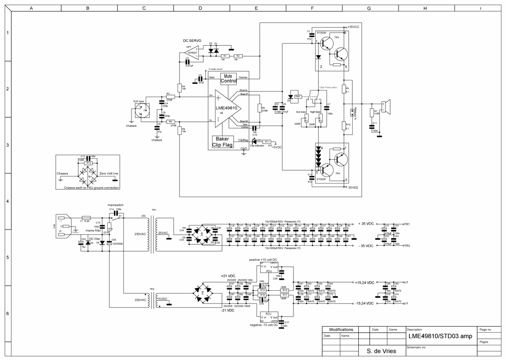

Sure I will share. See the attachment. Sorry it is so blurry but I can't upload higher resolution. It is just to get the idea. Forget the relays bias switch, this was just an experiment, to be able to switch between two bias levels 😉
For correct bias, set the resistor between biasP and biasN (of the LME49810) at 1Kohm. This way you have a voltage approx. 2340mV over the STD03 diode string, which gives the desired 2,5mA forward current to make the thermal compensation work. (my schematic says 470 ohm but is incorrect).
With the potmeter of 200 ohm meter between the diode string you set your desired idle current bias level. It can be wise to connect a bas16 diode in parallel with the potmeter. This to protect the outputstage in case the potmeter goes open circuit and destroy the outputstage.
Sanken advice 40mA through both Re's. The voltage drop should be for the following Re's:
0,1ohm Re = 4mV across both Re's
0,22ohm Re= 8,8 mV across both Re's
0,33ohm Re= 13,2mV across both Re's
0,5 ohm Re= 20mV across both Re's (not recommended)
Of course you can try higher bias settings and see if the thermal compensation remains reliable.
Above schematic is built, tested and reliable and very good sounding.
With a 400V/A transformer with 27VAC secondaries (gives +/- 38VDC.) I got the following power ratings just below clipping.
70 watt @ 8 ohm and 126 watt @ 4 ohm
With best regards,
Bas
