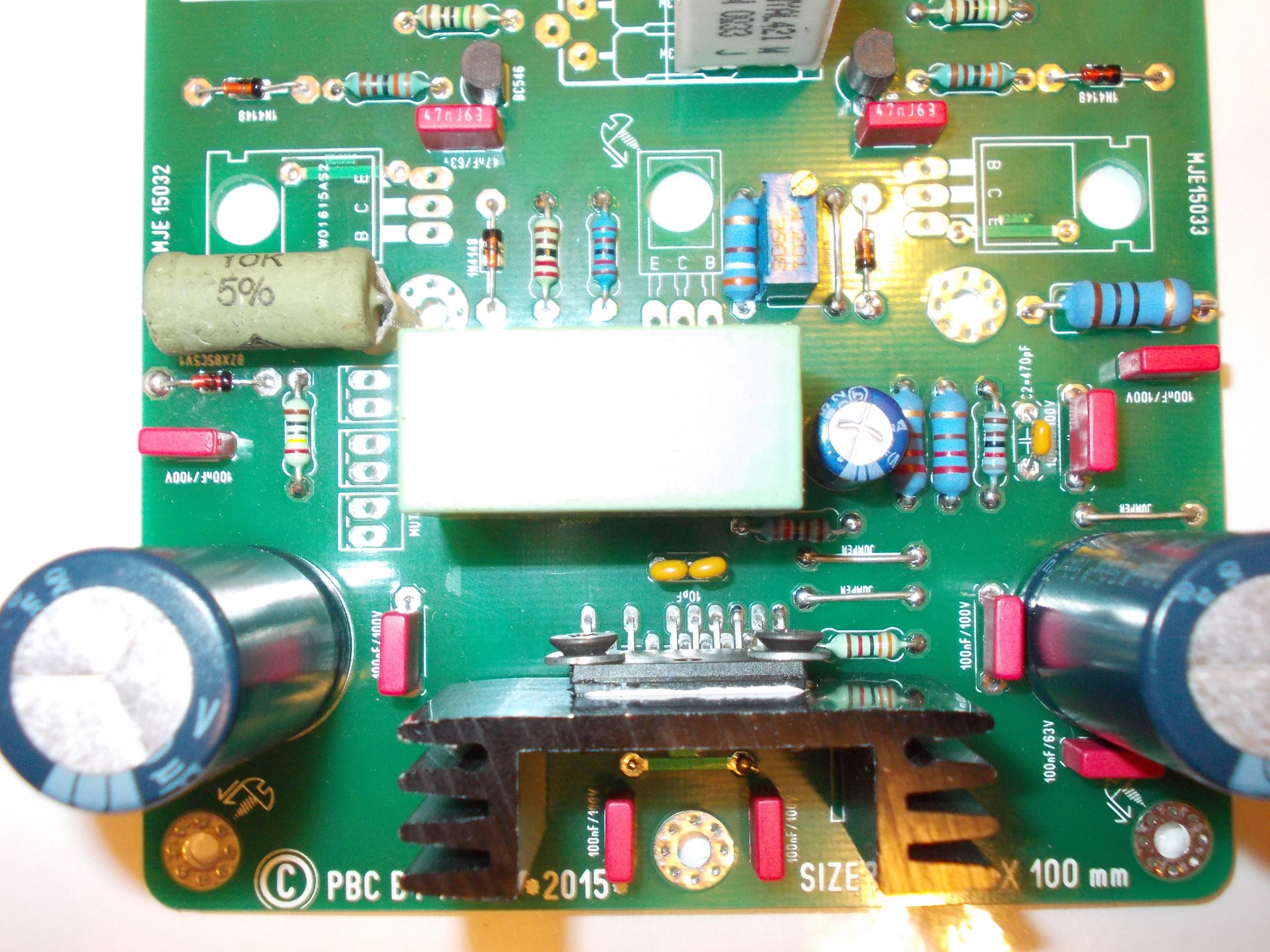

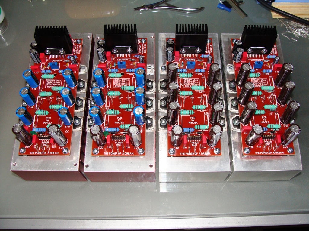

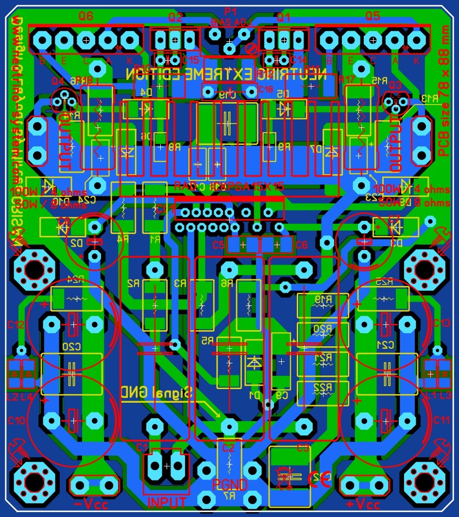

My LME49811 implementation.

Q3 Q4 C23 C24 circuit is it for current limiting?
Have you tried biasing it with mosfet at 1Amp?

Hallo, Mircea,
I quickly looked at the diagram in http://oi57.tinypic.com/rk4x94.jpg
and I think the potentiometer P1 should be put in parallel with C19, between the 2 resistors (R8, R9) on the basis of the drivers. Isn'it correct?

Hi Mircea,
The board is very compact and and the components are neatly arrange. I have another question for you:
From the images available I did not see the component Rth NTC (thermistor) on the populated board (in the schematic is connected in parallel to potentioneter P1)
Is it an optional component?
Or it is foreseen for the thermal stablization of the output BJT bias current in case of use of BJTs without integrated diode for thermal track?

Hi Luigi,
Yes, it is for thermal stablization.
Unfortunately the diode inside ThermalTrak transistor is nothing else then ultrafast diode (MUR120).
However, in this configuration I have a very good thermal equilibrium.
Mircea
Hi Mircea, Nice protection idea! have you tested the shortcircuit/overcurrent protection circuit?
Peter
Peter
"I quickly looked at the diagram in http://oi57.tinypic.com/rk4x94.jpg
and I think the potentiometer P1 should be put in parallel with C19, between the 2 resistors (R8, R9) on the basis of the drivers. Isn'it correct?"
"Your observation is right. In fact P1 is located between the ThermalTrak diodes."
So, the schematic is WRONG??
if you redraw the sch with the diodes in between the bases of the drivers, you can see that the sch shows a series combination of a variable resistor in parallel to NTC resistor and then two diodes.
That combination is in parallel to C19

I suggest that you secure the small heat sink mechanically to the board. Otherwise, vibration will cause the pins on the LME498xx to fail by metal fatigue.

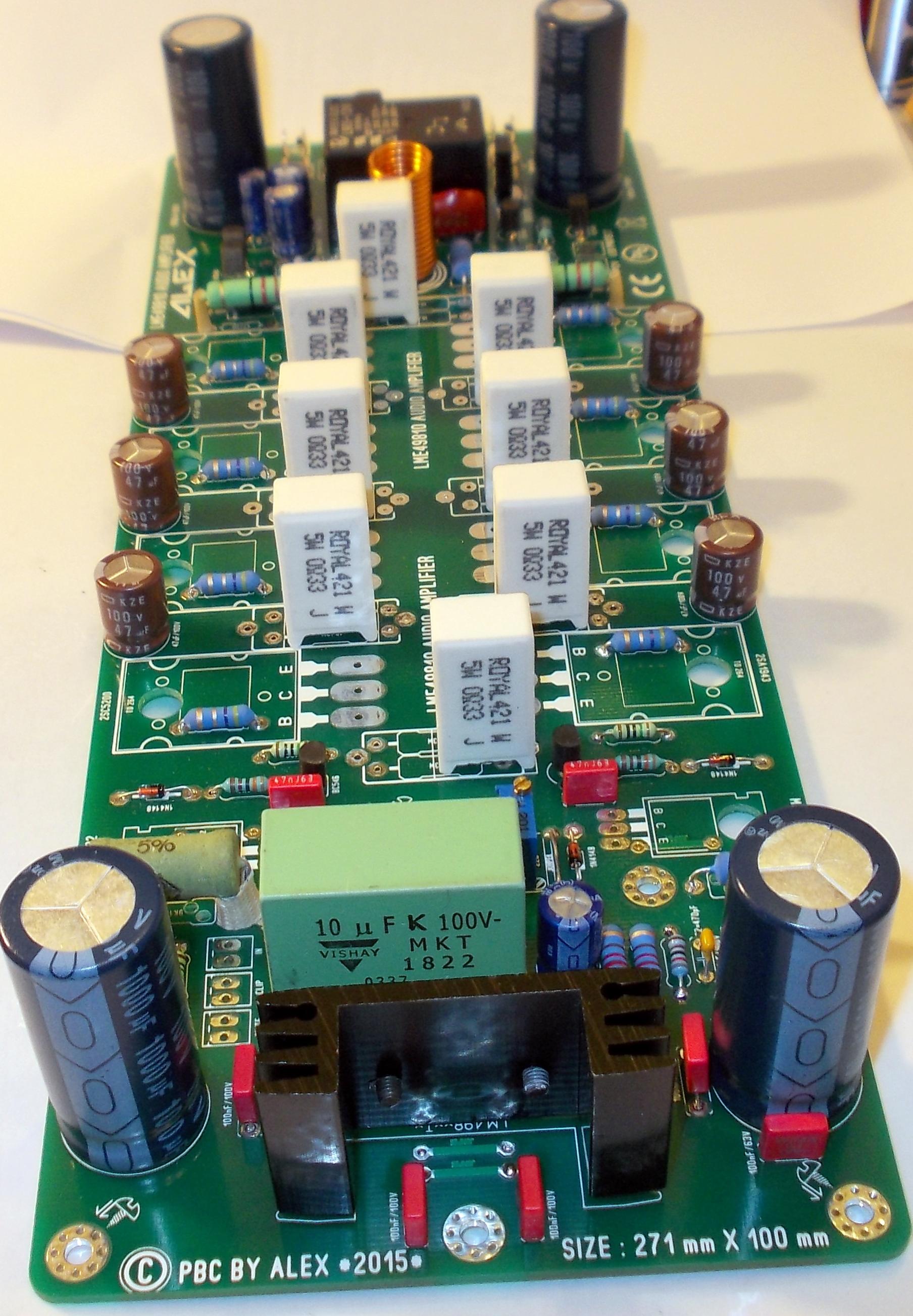

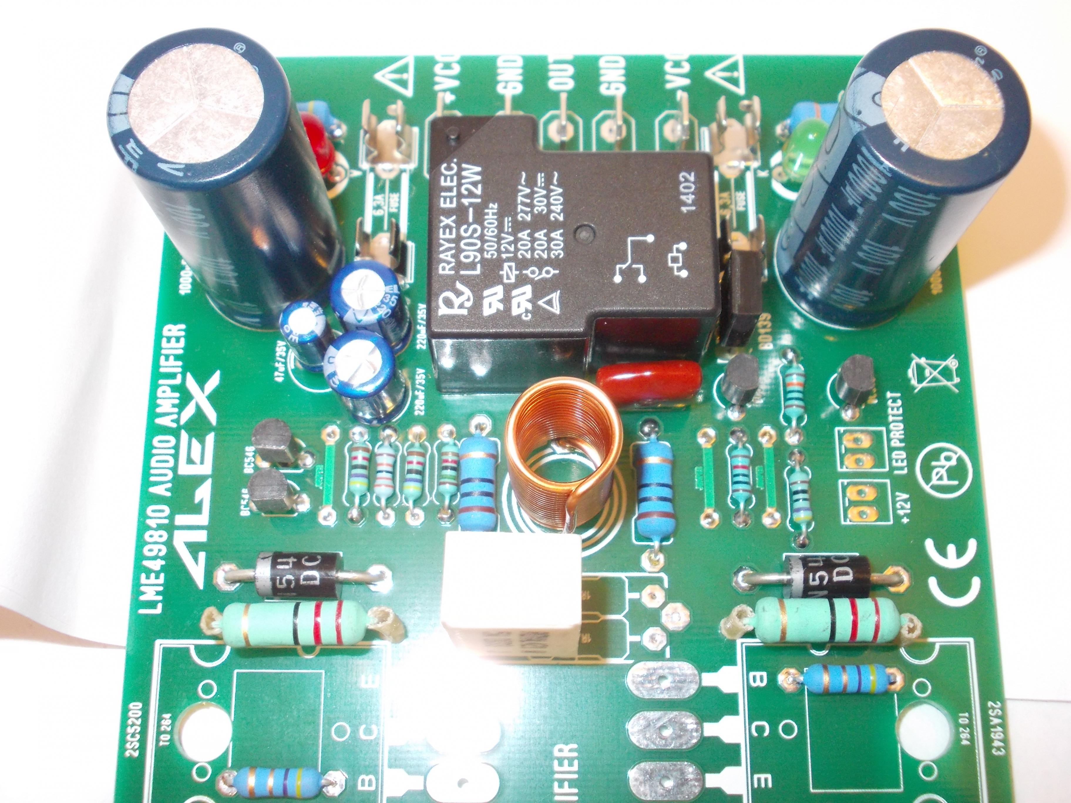

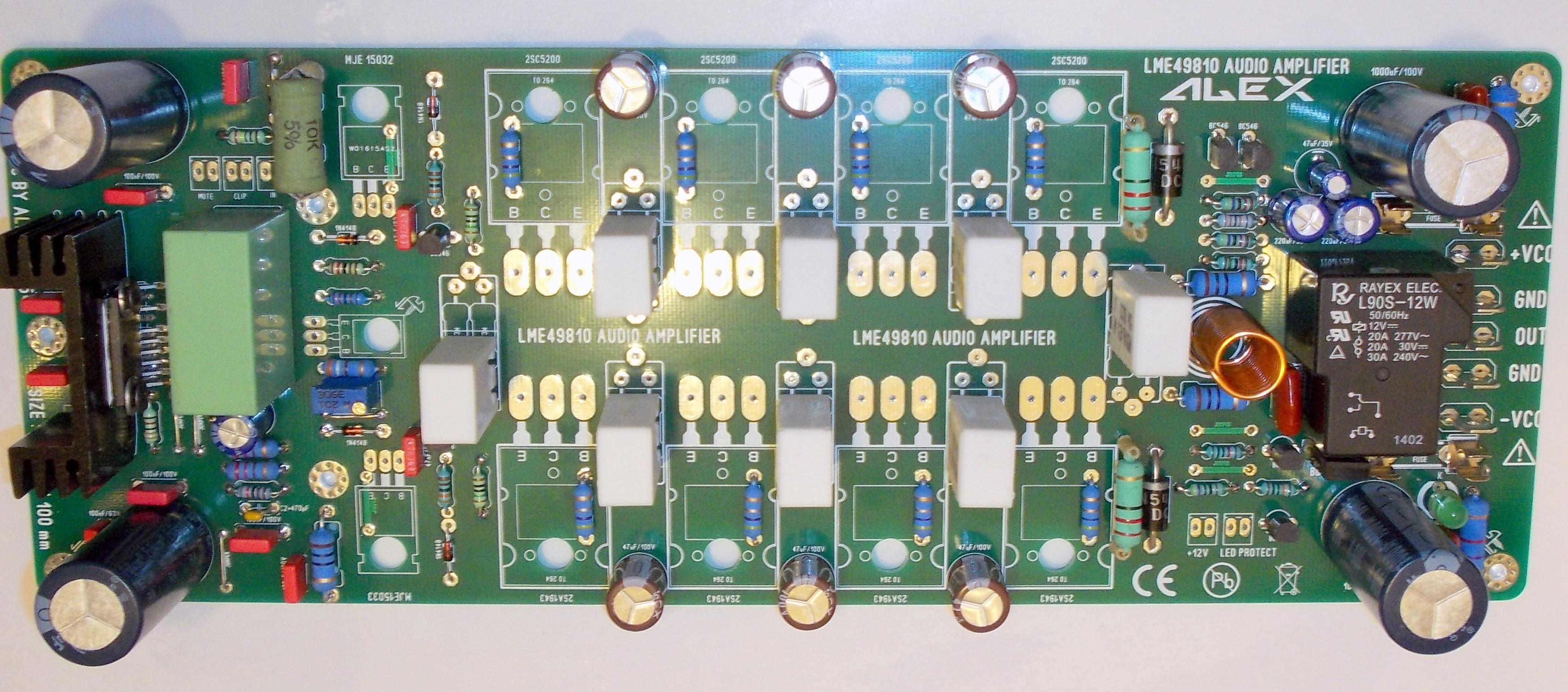

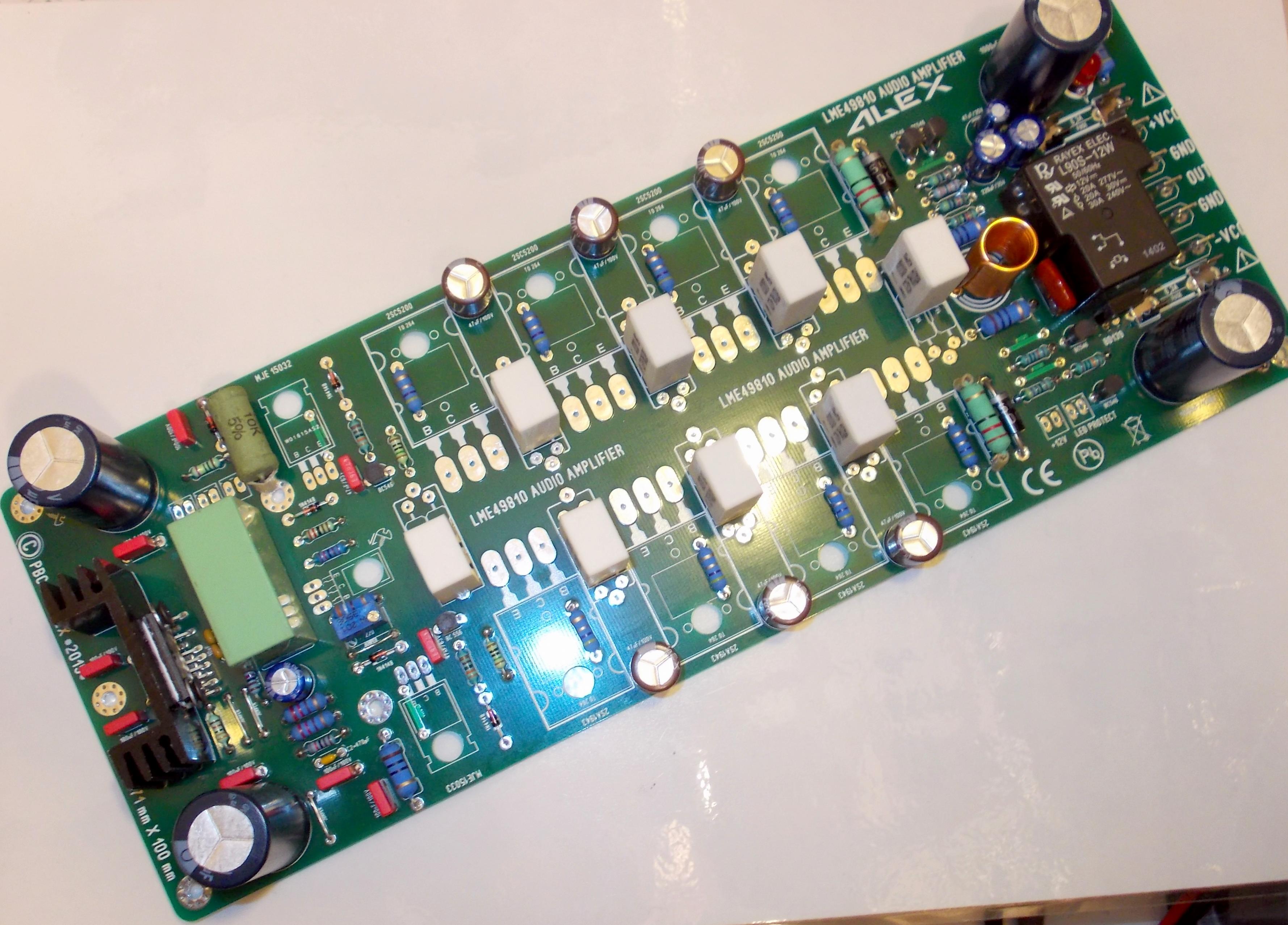

Just another amplifier LME 49810 driving 4 pairs OT 😀
Regards,Alex
Regards,Alex
