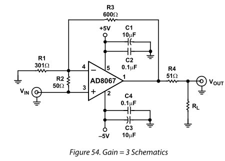

Here's an example of how to run a decompensated ( in this case a min-gain-of-8 AD8067) opamp at lower overall gain. The resistor to add is R2, here 50ohms. Its also permissible to put a cap in series with this resistor so that the DC offset and LF noise don't suffer.

Interesting approach..despite relying on amplification of noise instead of signal. What range of capacitor value is suffice in case of ~10K input impedance? According to AD datasheet, gain is 1+ [R3 / (R1||R2)], so.. does R1||R2 mean 1/R1+1/R2 or simply R1/R2?

The stability issue only rears it's ugly head at HF and generally this HF is well above the Audio Passband.
If you choose a resistor alone for R2 then the noise gain of the amplifier applies over the whole passband of the amplifier.
You can take advantage of the noise gain and only needing the stability of the noise gain at HF by using an R+C for R2.
Choose a capacitor that moves the majority of the noise gain above the audio passband.
If you are lucky (or can use a simulator) you will find that the audio passband becomes stable and the added noise of the high noise gain is only measurable above our HF limit.
There are many "stability" articles which describe this "noise gain" adjustment.
BTW, I am in the early part of my stability learning having only built one +20dB chipamp implementation. I can't hear any added noise and the amp plays very well. This method should work for +12dB chipamp implementations, but the added noise (due to larger cap value) may move down closer to the audio range.
If any one spots an error/s in my comments, please correct me.

Here is an another note about noise gain vs signal gain.
http://www.analog.com/library/analogDialogue/cd/vol46n4.pdf#page=3
They elaborated the technique in two different methods Method 1, Method 2. They notice the advantage of Method 1 because of lower noise comparing Method 2. It seems same advantage can be attained by adding a series capacitor (Cc) to R1 on Method 2.

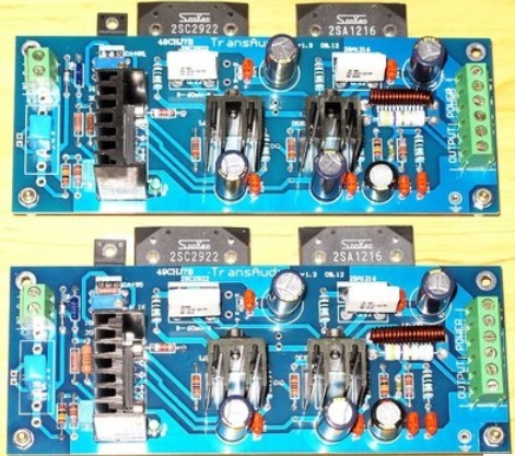

Do they look like these? If so I have four ready to assemble into a stereo bridged pair (with step-down OPT) but haven't built the power supply yet. I'll report back when they're up and running.
I searched for a small LME pcb's like this but ended up with two stereo LM4702 pcb's. Seller sent me darlington/mosfet version mistakenly but no problem at all since I have enough amount of MN2488/MP1620 Sanken darlingtons. These chinese pcb's are very high quality.
Are these modules compatible with LME49811's? Where did you get them?
Edit: Ok, there are couple of listings at aliexpress. Probably this kit is quite new..
I've not investigated substituting the main IC so can't answer that at the moment. They came from this Taobao seller, he's in Chengdu - ·¢ÉÕ¼¶LME49810TB ÍƵ¥¶Ô¹Ü¹¦·Å Ó¡°å/Ì×¼þ/³ÉÆ·°å-ÌÔ±¦Íø
