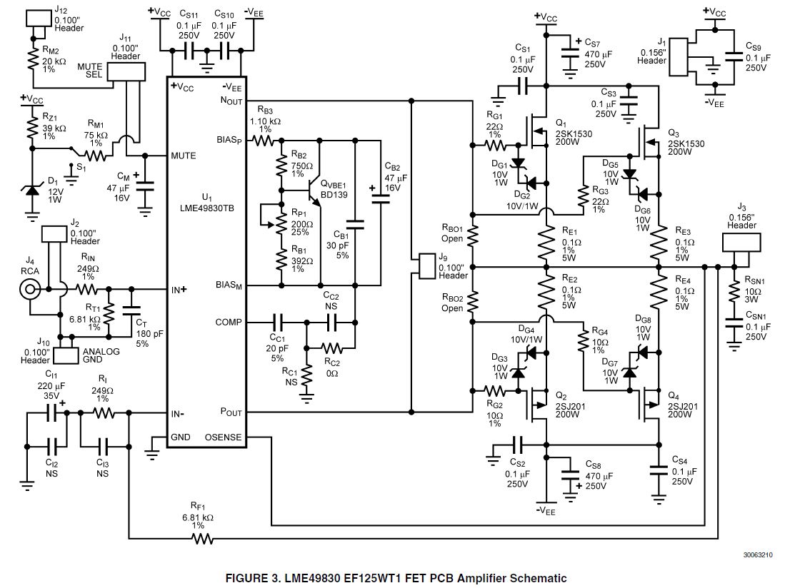

Hi together,
I'm from germany and I red this threat because I want to build an amplifier with the LM49830 gate driver and IRFP240 / 9240 Mosfets because they're very cheap to get.
The circuit I want to use is in the attachment, can I easily change the mosfets to the IRFP240/9240 or do I have to change any resistors?
Has anyone build exactly this circuit and experiences with it?

You should read mail #480, where they did use those IRF mosfets and didn't like them.
If I'm not wrong that design you show is from Bob Cordell's book, isn't it?

I would like to use LME49810 with toshiba 2SJ201 for the amp but what is the way to Bias this amp into class A. Is it Rp1 to be made balanced to get this amp into class A so that the quiescent point will be in the mid of the SOA?
what value to be across Rp1?
