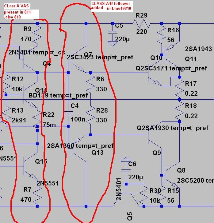

can LME49810 be used for class A? as the previous posts say that LME49830 itself is biased in A/B. I agree 811 works in class A but how about 810?
Both chips has the vas biased in class A .811 has the output direct from the vas stage.The 49810 added an emitter follower to provide a higher current at the output .So the 810 has the vas in class A like 811 but also an simple class A/B emitter follower stage .
so the 810 vas might be in class A but the emitter follower at its output would not run in class A if biased at the output stage isnt it?
Here is a similar example,hope that it helps ,To have triple output stage at 811 you must add 6 transistors .To have triple on 810 you must add only 4 transistors because 2 are already in it .
can you attach the spice file i would like to simulate few things..

Sorry I have not posted for quite some time but I just got a notice in my email about a comment on this thread and thought I could shed a little light on the questions posted here...
The LME49810 was designed for high power amplifiers for the music industry and a class AB stage was added to its output stage to bring the output current up to 50ma (60max on data sheet) to be able to achieve 2KW with a single Darlington output stage. It also has a pure Baker Clamp which is only slightly different than a similar circuit implemented in the LME49811 and LM4702.
The LME49811 is a class A internal implementation but it only has 7ma of output current. It also has a "Bob Pease" improvement to the layout of its input stage to improve low level thermal performance. We did this when we split the stereo LM4702 in half to create the LME49811, that I specified.
I have been listening to the LME49811's used in a mono block amplifier design, very similar to the circuit in app note AN-1490 for the stereo LM4702, at home and here in our sound room at TI Santa Clara for over 5 years now. With 50VDC rails that amplifier has no trouble driving our Wilson Watt Puppy model 7's at work. You can see from the graph in AN-1490 (for the very similar stereo LM4702) that this amplifier design achieves 0.0005% THD+N. Actually my LME49811 amplifier measures even better than that.
