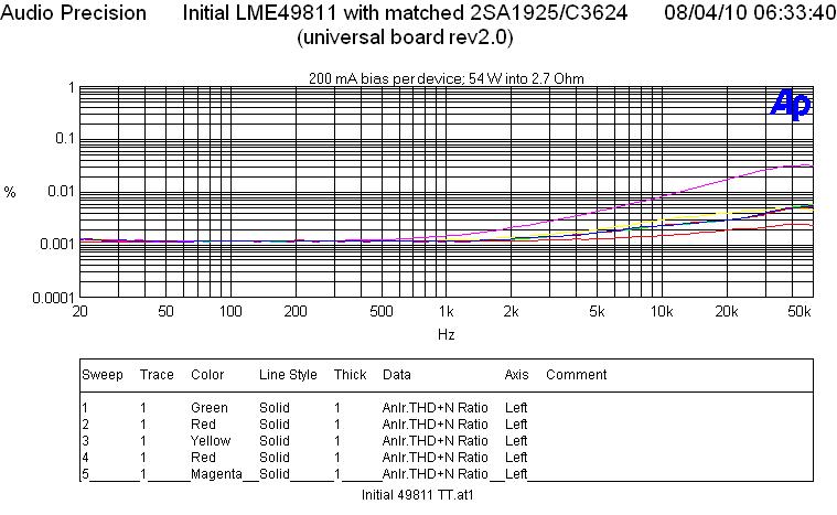

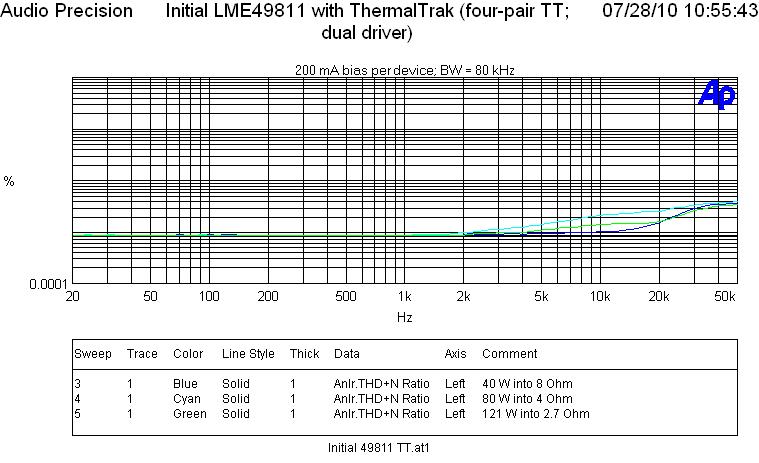

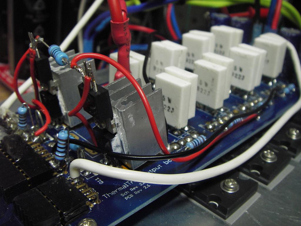

Dual Drivers for Four-Pair ThermalTrak
I slightly modified the existing four-pair TT power board to have dual drivers (MJE15030/15031 x 2). Each driver pair drives two TT. Here is THD vs freq for 2.7 R, 4 R and 8 R loads. At 121 W into 2.7 R, THD is only 0.003 %.
the extra drivers will allow a slightly increased gain from VAS to Output.
The extra drivers have reduced the current demand from the VAS.
This is proof that a pre-driver stage is required when larger output currents are required.
Perhaps I don't have a good understanding of this circuit but to me using multiple drivers in // or one driver for the output transistors in // gives the same current requirement for the VAS ( distributivity of multiplication with respect to sum).
It seems to me that the main advantage of multiple drivers is less current in each driver and so less distortion.
JPV
the drivers as well as the outputs suffer gain droop at higher currents.
If the drivers only have to drive 2pair instead of 4pair of outputs then the driver gain will be higher and thus the VAS current into the bases of the drivers will be less.
That is equivalent to saying the VAS sees a higher load impedance.
