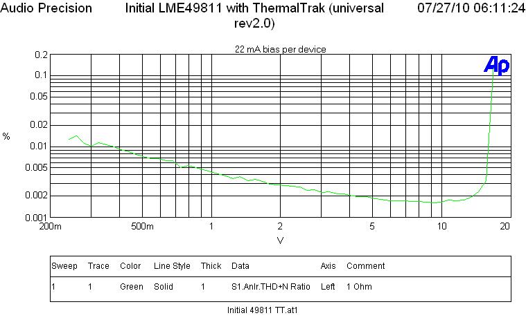

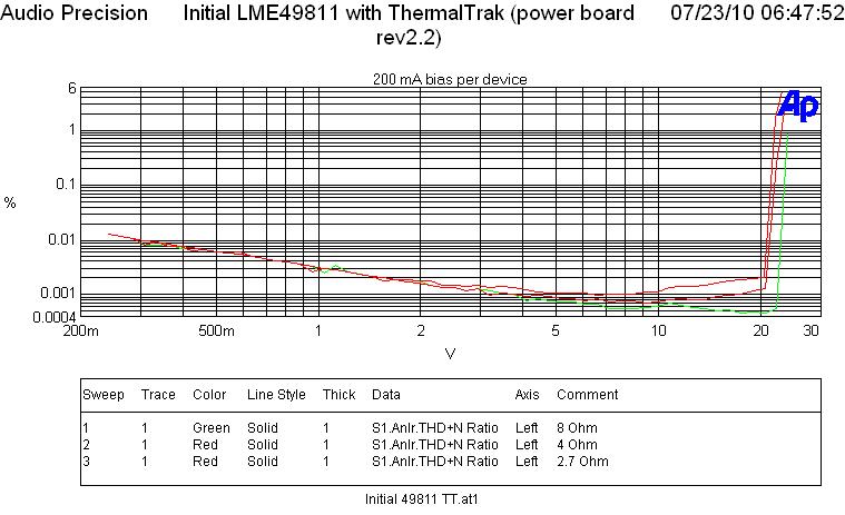

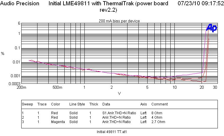

We all knew that layout pays vital role in amp performance. Here is an evidence. The amp under test is LME49811 with two-pair NJL3281D/1302D.
From left: 1kHz for previous version power board, 1 kHz for new version power board, 10 kHz for previous version power board, 10 kHz for new version power board
The performance for 8 Ohm is nearly the same for both boards. However, it is very clear that the new board achieves better performance (lower THD and higher clipping level) for heavier loads.
I just told you that I did not make a very good board 😱 or I am improving. 🙄 Nevertheless, this is a good example to share with you.

You may be right, but, I also thought that your new boards had significantly more on board capacitance. I remember reading a thread where Bob Cordell was talking about the benefits of on board capacitance. He was describing the "violent" voltage/current swings at the output transistors under heavy load as they switch on and off in the class B mode and how this switching caused extreme things to happen at the power supply to these devices. The on board capacitance, close to the pins of the (significantly closer than the main supply caps) would absorb or dampen these extremes, reducing their influence on their counter parts as well as the driver transistors.
Maybe you should put the same amount of capacitance on the early version boards and then compare. At a minimum it would eliminate one variable.

Yes, I added the same amount of onboard cap on the old board for comparison.

Ok, so much for that theory😱
What do you think you have done to improve the new boards?

That particular plot is for the new board.

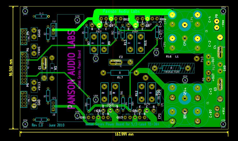

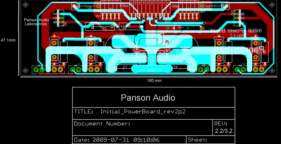

Here are the layout of old and new boards.

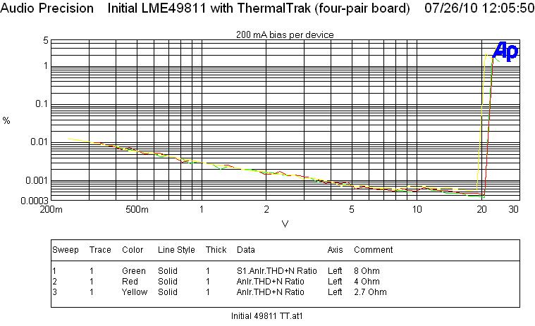

I tested both boards without output coil and Zobel RC.
The extra onboard caps do not make very big different.
Left: no extra onboard cap
Right: with extra onboard cap. better performance in 4 Ohm, very slightly improvement in 2.7 Ohm (assuming this is not measurement error).
I am doing tests for why the new board is better. The new one got more space for better/easier routing. I think this is the key factor. The net resistance of some critical traces of the new board does not lower than the old one. As can be seen from the plots, the new board got lower THD. It should be contributed by component placement and routing pattern instead of thicker traces.

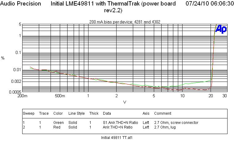

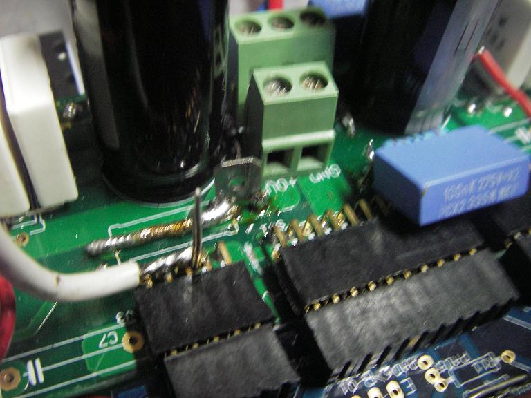

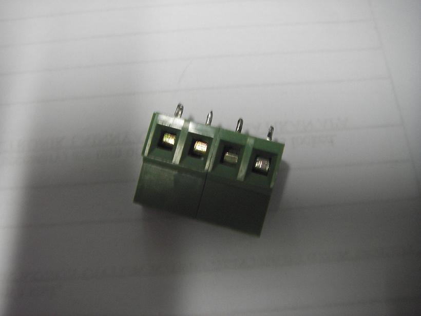

I just found the root cause of the problem. This is not layout at all. 😛
This is the connector used in the old board!!! Take a look of the plot to see what it does!
I might be wrong for saying not layout related. The 2.7 Ohm curve of the old board with connector issue fixed is flat from 10 V whereas that of the new board does not. It may indicate there is something going on not found yet. My test is thus continued.

I'm not sure I understand what happened, did the connector melt? Or what?

No. They are just not linear at high current.

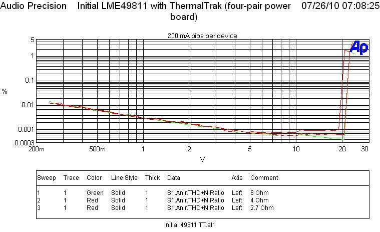

I eventually found the root cause for the old board inferior performance compared to the new board. In the new version power board, there two 10R resistors for each rail. These 10R together with the decoupling caps on the LME driver form LPFs to make a cleaner supply voltage for the LME chip. The old board does not have the resistors. After I added the 10R resistors, the performance with the old power board is identical to that of new new power board.
Based on the result, separate power supply for the LME board may lead to better performance. Will give it a try.
1 kHz THD vs level plots
Left: without the 10R resistors
Right: with the 10R resistors
