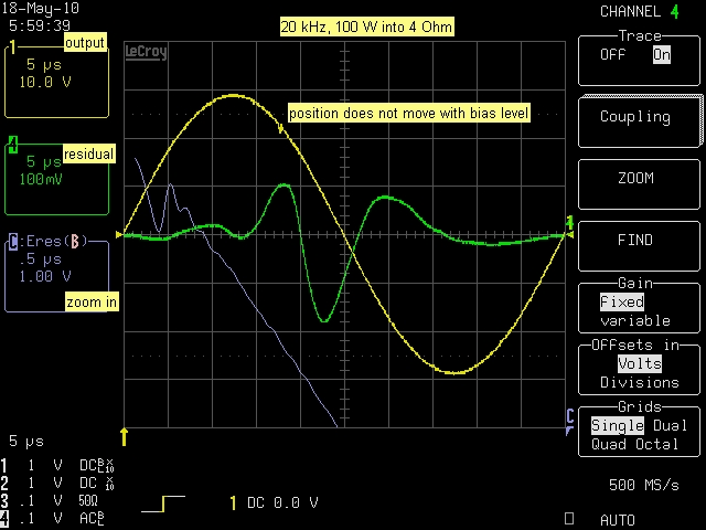

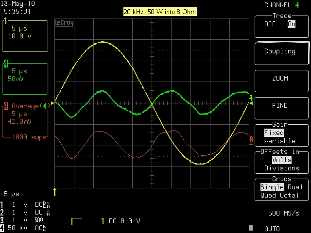

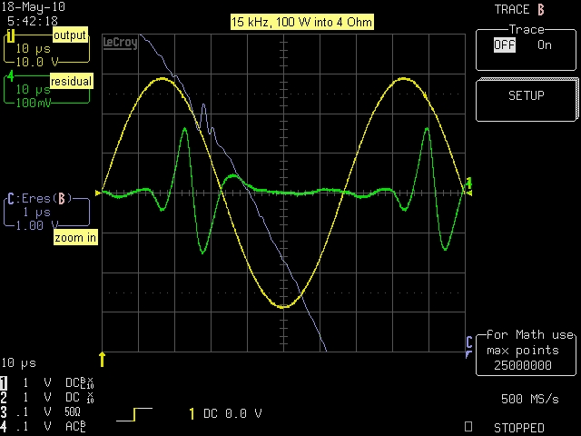

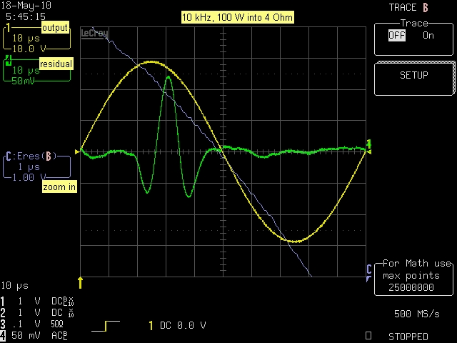

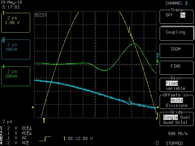

I take more measurements for the above issue - raising distortion at high freq. Hope these data can help one to interpret what is happening. Something is found from the output waveform when no speed cap installed.
Starting from the left figure:
20 kHz 50 W into 8 Ohm --- third harmonic dominates the distortion residual
20 kHz 100 W into 4 Ohm -- something (call it glitch) occurs on positive cycle
10 kHz 100 W into 4 Ohm -- glitch is not clearly seen in output
15 kHz 100 W into 4 Ohm: -- glitch is clearly seen in the positive cycle
The output load is a resistive load. The voltage and current waveform are inphase. The glitch does not seem to happen at voltage or current zero-crossing.

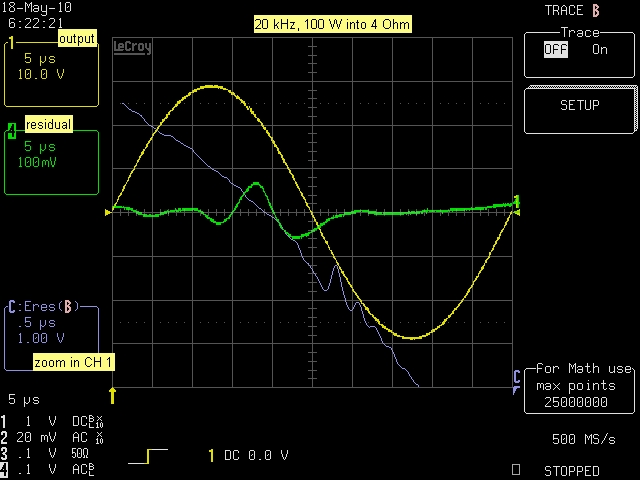

The right most figure is 20 kHz 100 W into 4 Ohm with speed-up cap installed. The glitch is hardly seen from the output waveform. It can be seen from the zoom in and distortion residual.
glitch

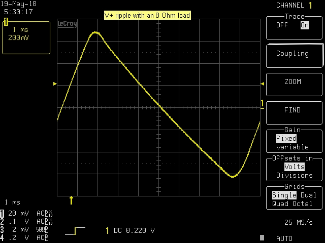

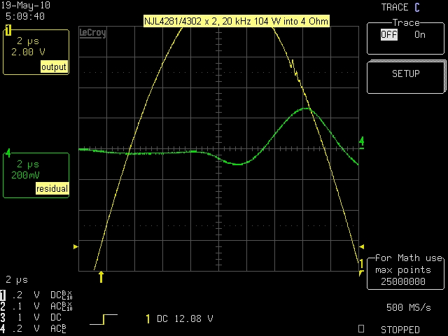

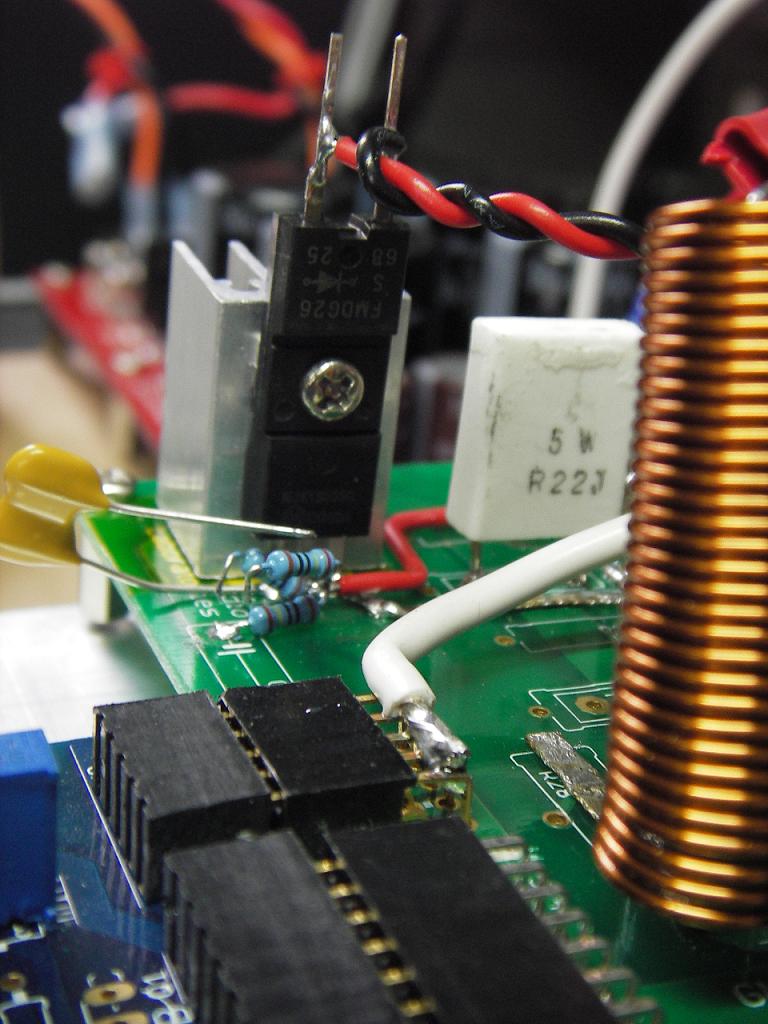

Hi Ken,
Thanks for you suggestion. I also looked into this possible cause by adding snubber cap 0.1 uF across all Sanken FMDG26S rectifier diodes. The glitch still exists after this mods. It seems the glitch taking a long time to settle with the caps added. Probably need to try value or RC snubber.
A load test using an 8 Ohm resistor connected to the supply rail +/- 40 V does not show any glitch in the ripple. Dynamic should be more useful. But I don't have an electronic load.
Left: no snubber
Middle: with snubber
Right: supply load test

Those are they same kind glitches that raised havoc in my transformer tests here http://www.diyaudio.com/forums/planars-exotics/161485-step-up-transformer-design-4.html#post2137648 and here http://www.diyaudio.com/forums/planars-exotics/161485-step-up-transformer-design-3.html#post2133865 , I believe them to be crossover distortion and they got worse as load impedence got lower.
In those tests, my load impedence's were as low as an .5 ohm and lower as the frequency went up and it was a purely reactive load too boot, demanding much much more current than the amp could even dream of producing.
Just my thoughts. jer
Hi Ken,
Left: no snubber
Panson
Hi Panson,
RC filtering might remove it, also, you might try adding more capacitance near the output transistors say 1000uf each. I am going to try attaching a pdf written by Jim Hagerman, Hagerman Technologies on calculating optimum snubbers. To big to post... here is the link to his tech articles, scroll down and look for title "calculating optimum snubbers". Thanks to Jack Walton for the link :).
Ken

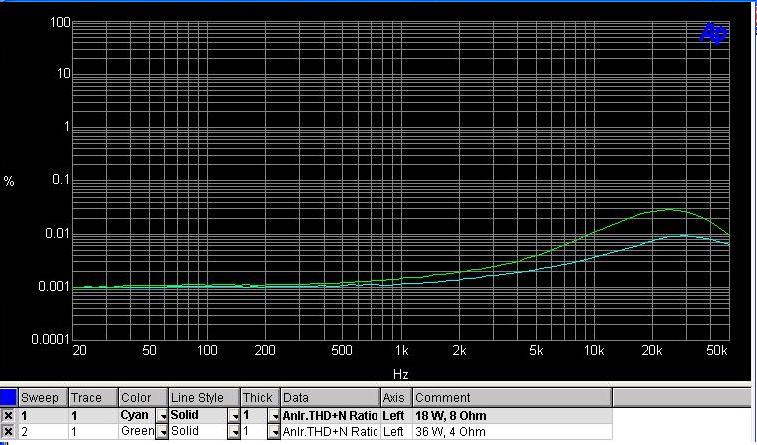

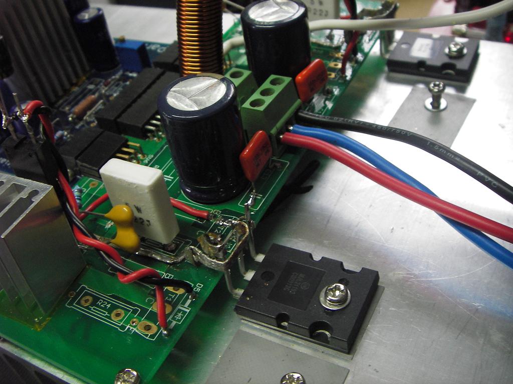

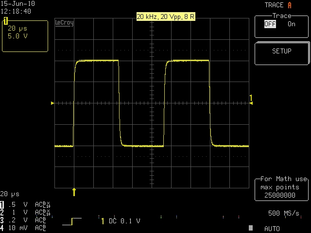

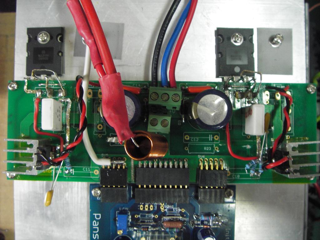

LME49811 with CFP output
I modified the output power board to accommodate a CFP output stage. It consists on MJE15034/35 and MJL21194/93. The driver collector resistor is initially 120 R. Re is 0.22 R. Base stopper for driver is 100 R. The stopper very important here to avoid oscillation. The comp cap is 32 pF. Bias is simply generated by two diode and a trim pot. Each diode is attached to the driver heatsink as shown in the picture. Output coil and damping is employed.
Compared to emitter follower output stage, CFP is relatively less friendly. This is my impression at the moment.
THD+N vs freq (BW=80k) for 18W/8R and 36W/4R is shown in the picture.

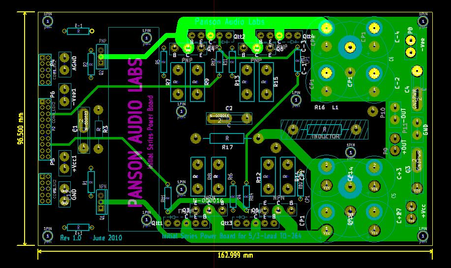

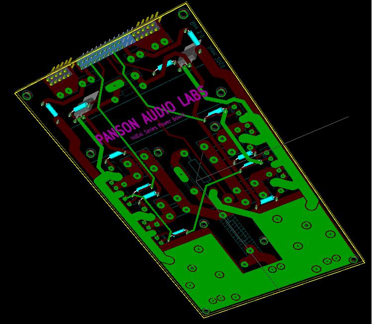

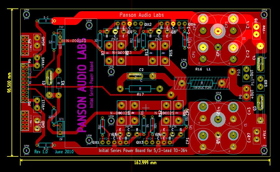

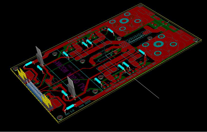

New layout for Initial Power Board
Here is a new power board for the Initial Series. The board accommodates two-pair 3-lead and 5-lead TO-264. Output coil and Zobel network are added. It will be released to PCB house soon. Comments are welcome.
Green: Bottom layer
Red: Top layer
The 3D is not perfect since I have not build the 3D models for my component library.
