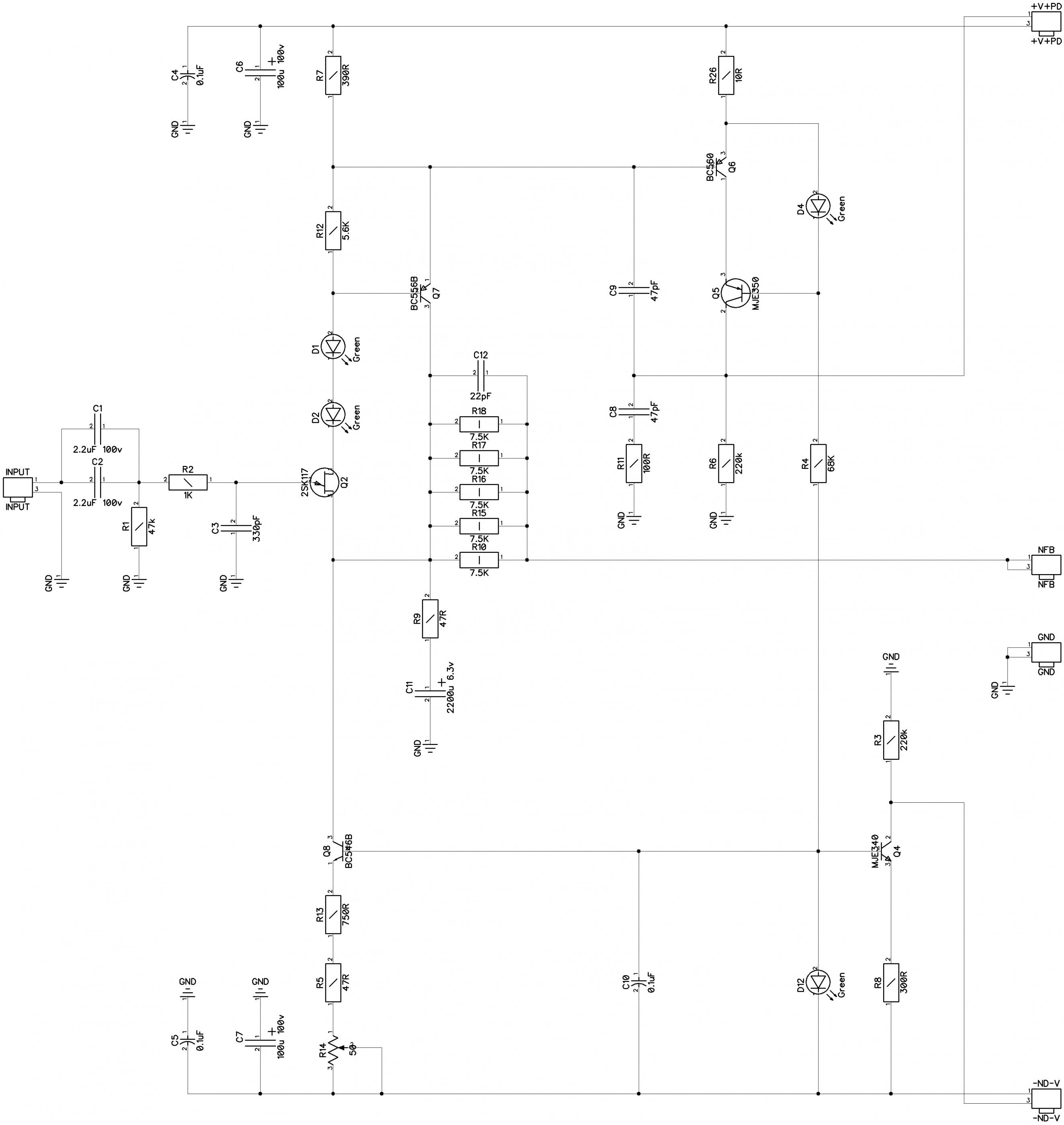

I have some 2sk146,can i use them?
Mary Cristmas![]()
Unfortunately, 2sk146 have got too low Vgds for this design.
2sk389 can be used here (although it will require some minor layout amendment).
Merry Christmas!
Bf862
Also out of SOA. Vds / Vdg = 20V max.
We need at least 50V for these designs.
Again, it's possible to add a common-base cascade to lower the drain voltage, however it requires some additional parts (although some LEDs will go). I tried to keep it simple - even at the price of limited choice of transistors...

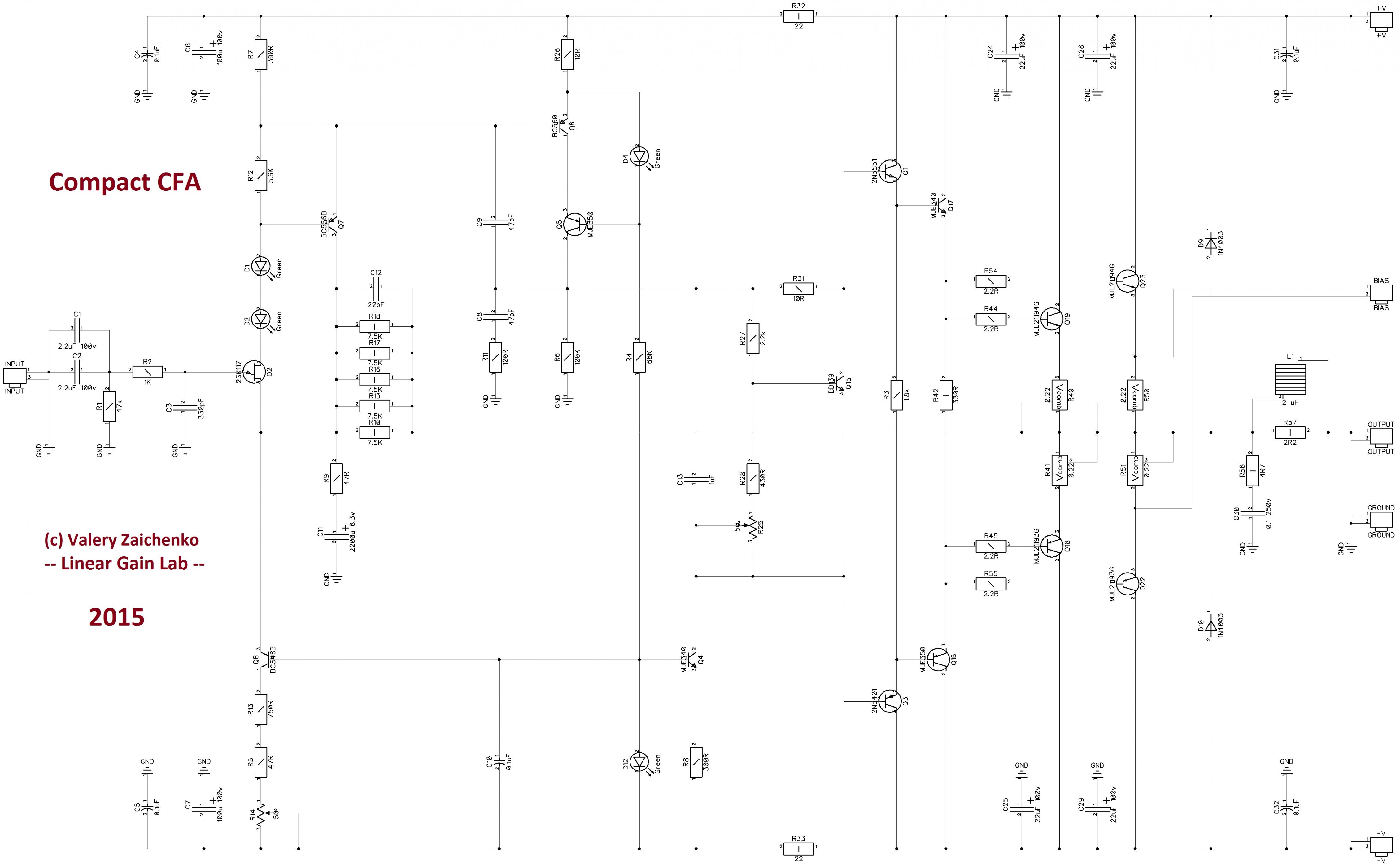

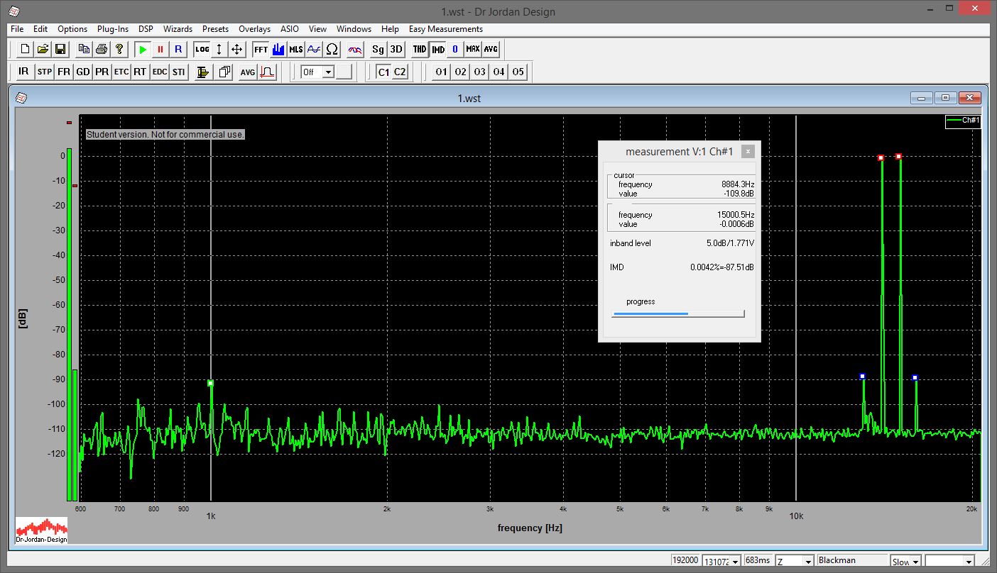

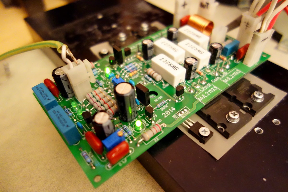

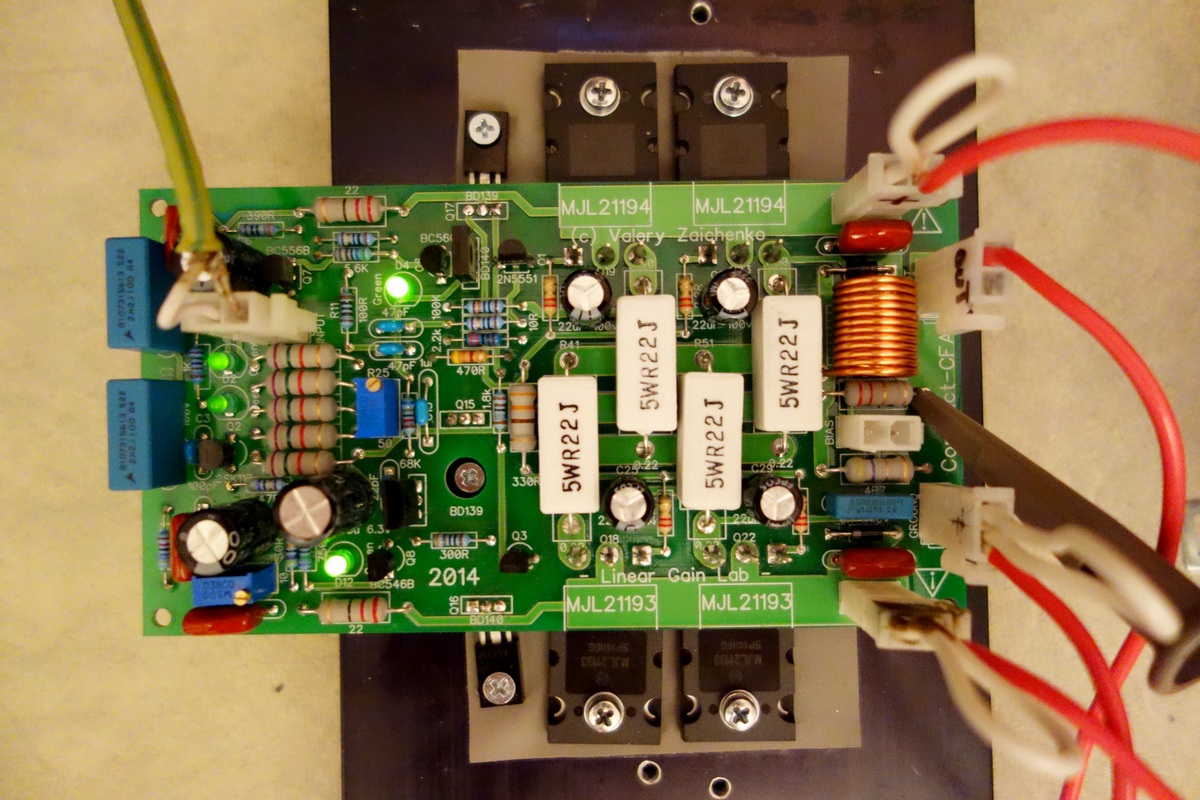

Compact CFA is prototyped and tested!
Hi All,

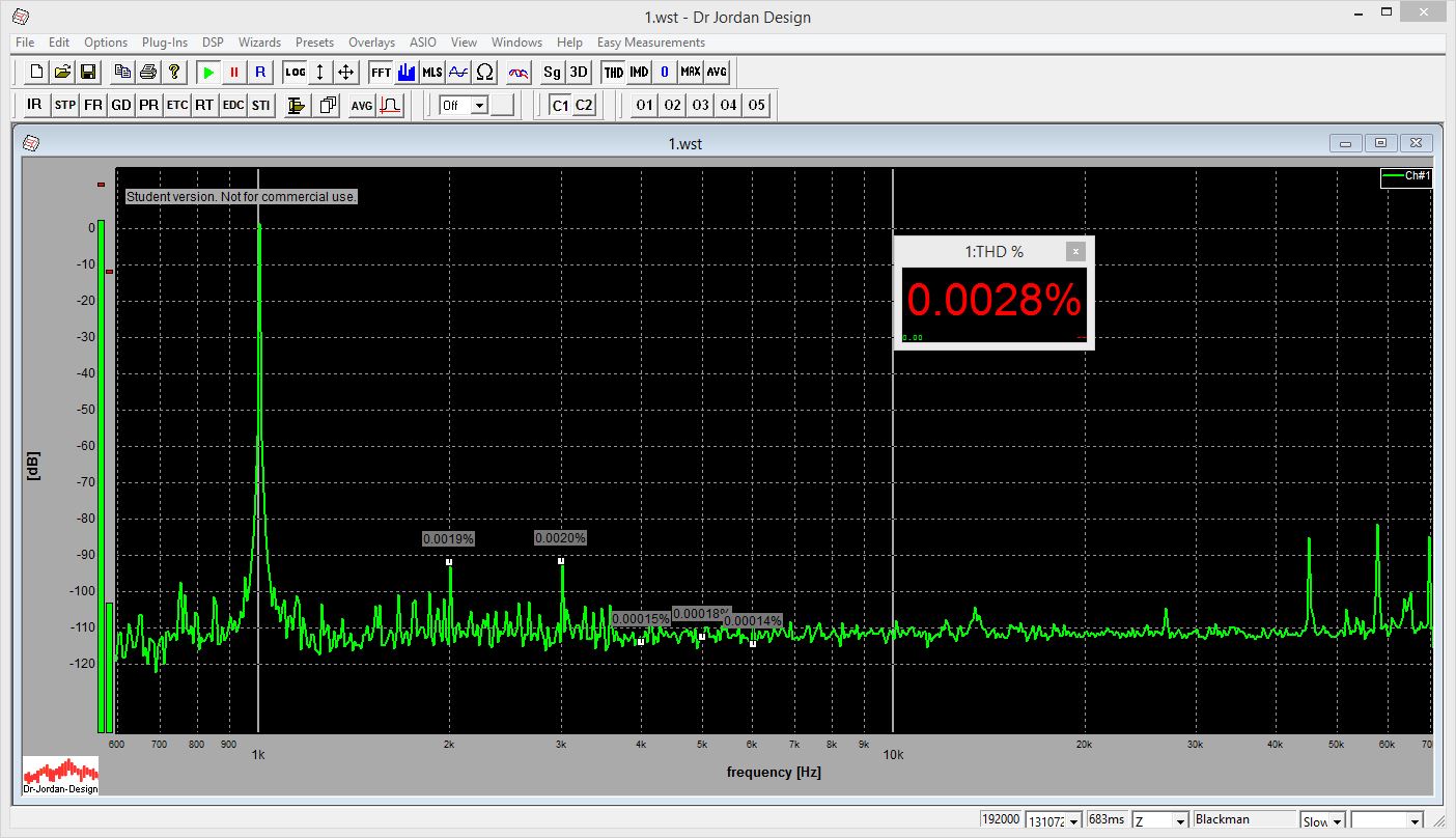

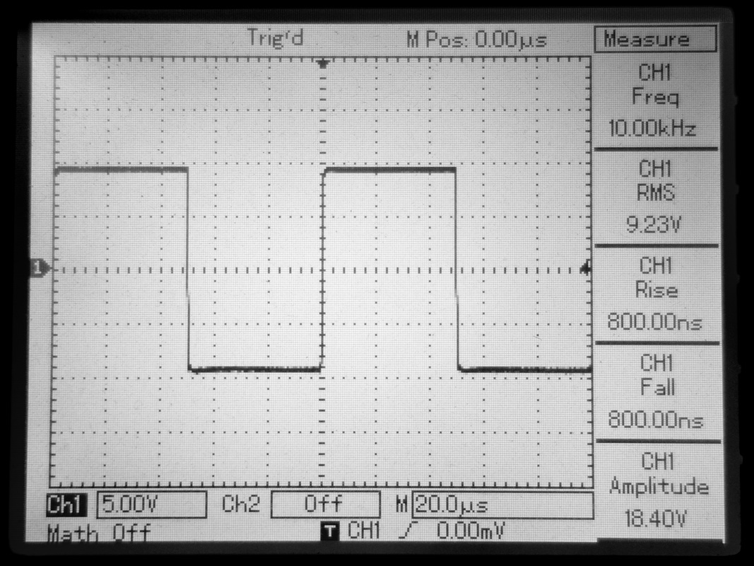

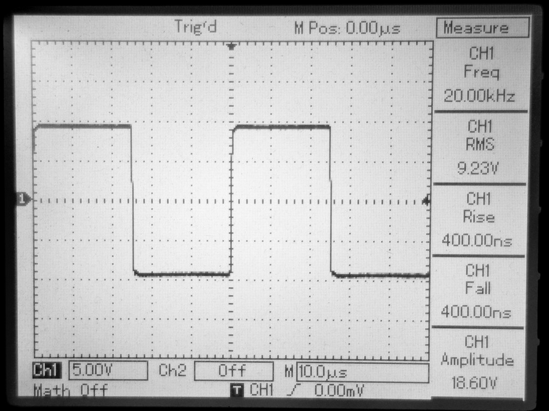

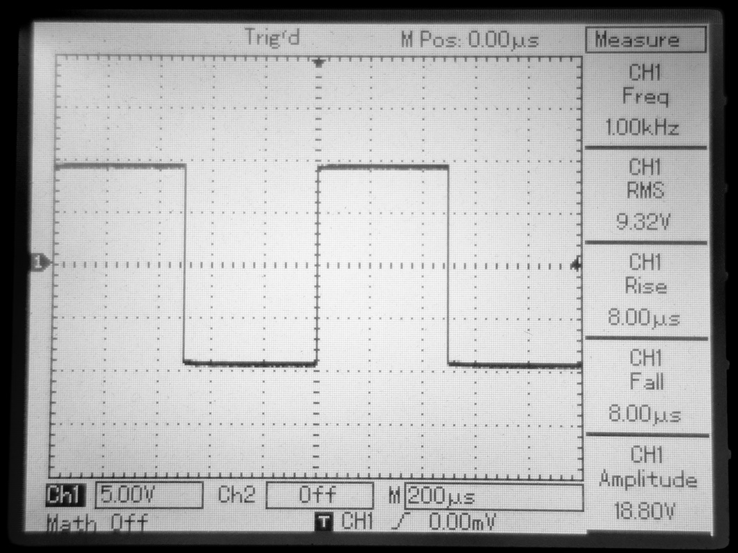

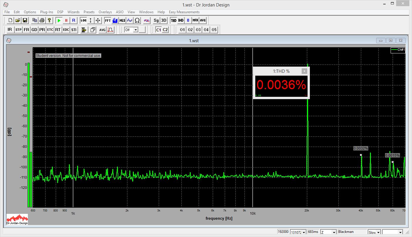

Tested the CFA one today. Pretty cool. Stable, low distortion, fast, symmetric slew and clipping. No clipping artifacts. All measurements are done at 8R load except clipping test (100R). DC at the output stays within a couple of mV.
Great sound. Somehow, bass here seems to sound a bit "softer" - in a positive sense - that the other CFAs I tested before. Staying very detailed and natural at the mids and highs.
PSU voltage is +/-52V DC, non-regulated (as usual). Dead quiet with no signal.
It's fast enough even with the slow output transistors. However - be careful. Input signal at the frequencies above 500KHz may kill the OPS if it's not fast enough (current shoot-through across the output pairs as they close slower then they open). With faster devices, including most of the MOSFETs, this is not a problem.

Nice , Val.
Hey.. make a standardized IPS out of it.
PS - with CCS / cascoded simple VAS , will work VERY well with my EF3.
And just 1 Jfet - no matching.
It looks like perfect alternative to the 7 device bootstrap VFA.
Do I see 2 pole compensation at VAS ??

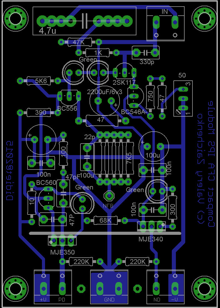

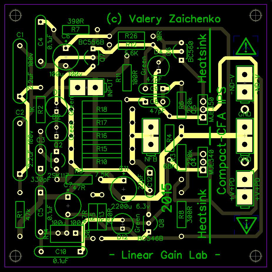

Slewmaster-compatible IPS module
Good idea to make a "standardized", Slewmaster-compatible IPS. Here it is 🙂
Being rather simple, it easily fits 3"x3" board. Output plugs layout appears a bit "messy" as it was initially designed with "mirrored" rails. I'm sure, somebody can make a better single-layer layout 😛
Heatsink is not required at around 5mA VAS current, however, if somebody will like to drive the Lateral FETs directly from here, the VAS cirrent will have to be increased to some 15mA - in this case the heatsink will be needed.
Compensation is actually Miller (plus the lead cap in parallel with GNFB). C8, R11 is just an RC filter, correcting the frequency response above 30MHz and improving the gain margin for about 3db 😀 ULGF is set to 2MHz, however, the point, where the phase flips over 180 degrees is at around 40MHz - that's where the falling gain reaches -19db.
Frequency response is limited to around 500KHz by the input filter. With C3=100pF it will go above 1MHz, staying stable, but again - at such bandwidth, if the OPS devices are not fast enough, they will be killed by the rail-to-rail current shoot-through.
