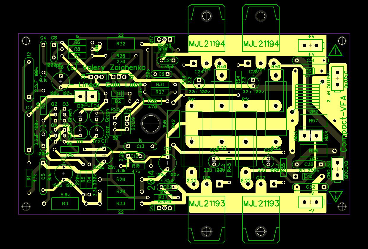

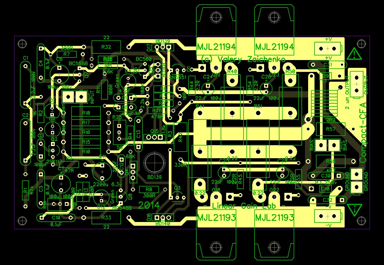

Hi Valery,
As it's not easy to each precise double layer at home i attemp to do single layer routing job for 6DJ8-All-Fet-IPS. Could take an eyes on it for advices...
Hi Valery,
Hi Marc, that's great - thank you for doing this 🙂
Looks good, just one thought - it would be useful to keep physical orientation of the MOSFETs (Q2, Q3) in such a way, that it's easy to attach a heatsink to them - in case of rather high VAS current, they will be moderately warm, so some small local heatsink is recommended.
Valery
i will take a look but think i can attach a local heatsink even in this positionHi Marc, that's great - thank you for doing this 🙂
Marc
Valery
Valery

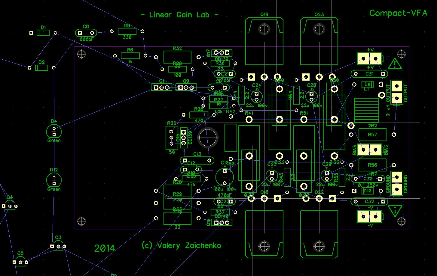

Here the modification according your advice....
Yeah, it was just an overall recommendation - leave it, I think it's very good as is.
P.S. Ah - did not see the latest version - this one is just perfect!

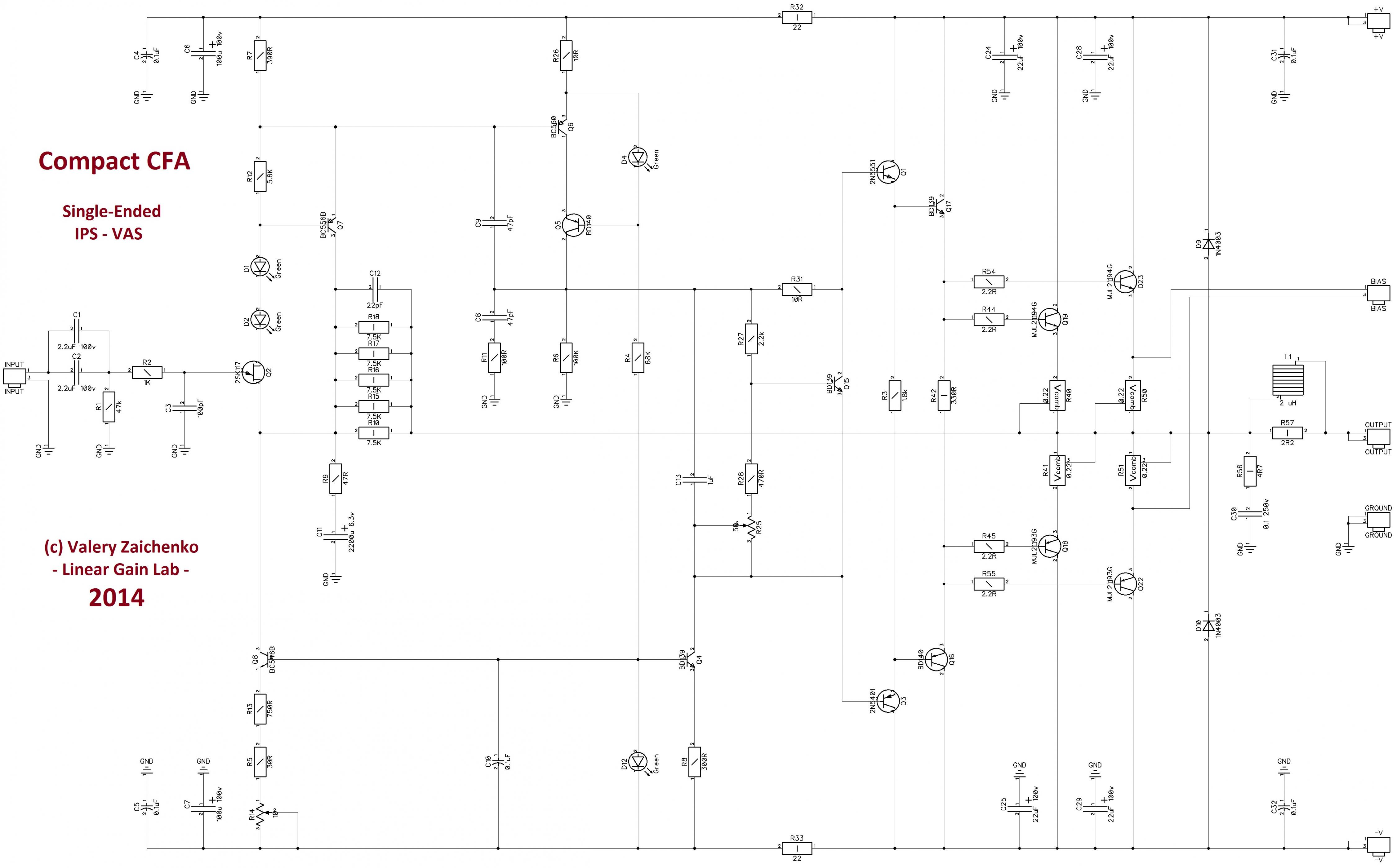

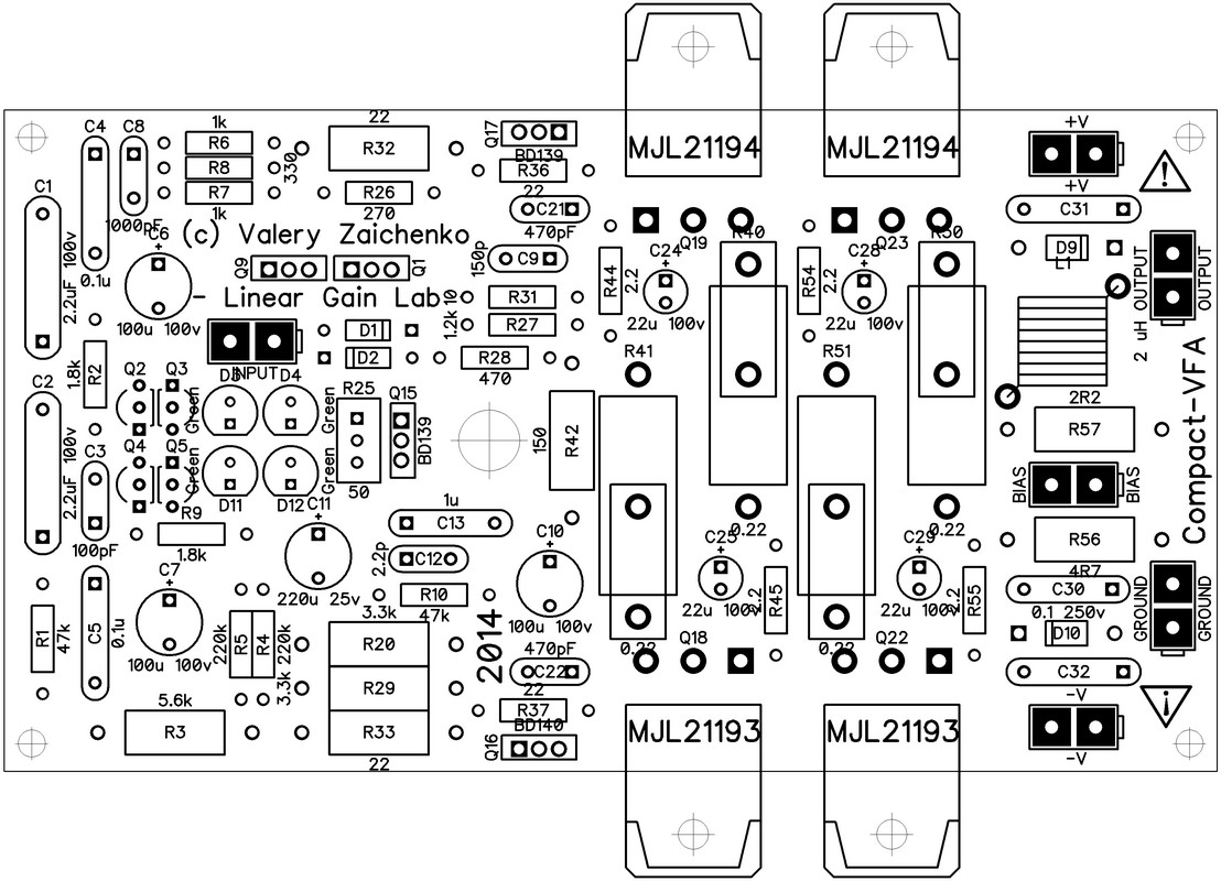

Compact Amplifier - Singleton CFA - "as built" refined
Compact CFA Singleton with jFET+BJT Sziklai at the input is refined for ultimate stability and reliable performance.
Attached is "as built" schematic and spectrums, measured at 50W output power @ 8 ohm dummy load.
Power supply is +/-52V DC, quiescent current is 80mA per output pair.
Layout is corrected accordingly. It's mostly TH with some SMD components, including DC servo underneath the board. PCB size: 5.5 x 3 inch.
Have fun!
Valery
