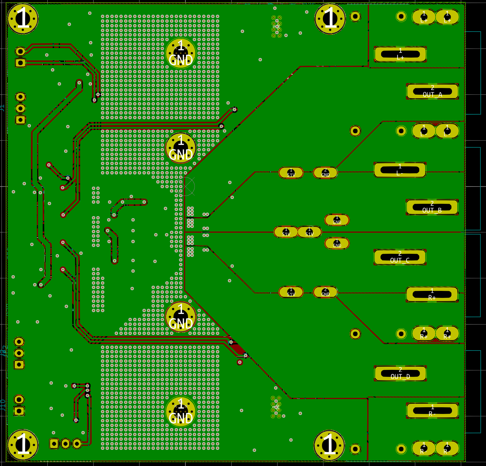

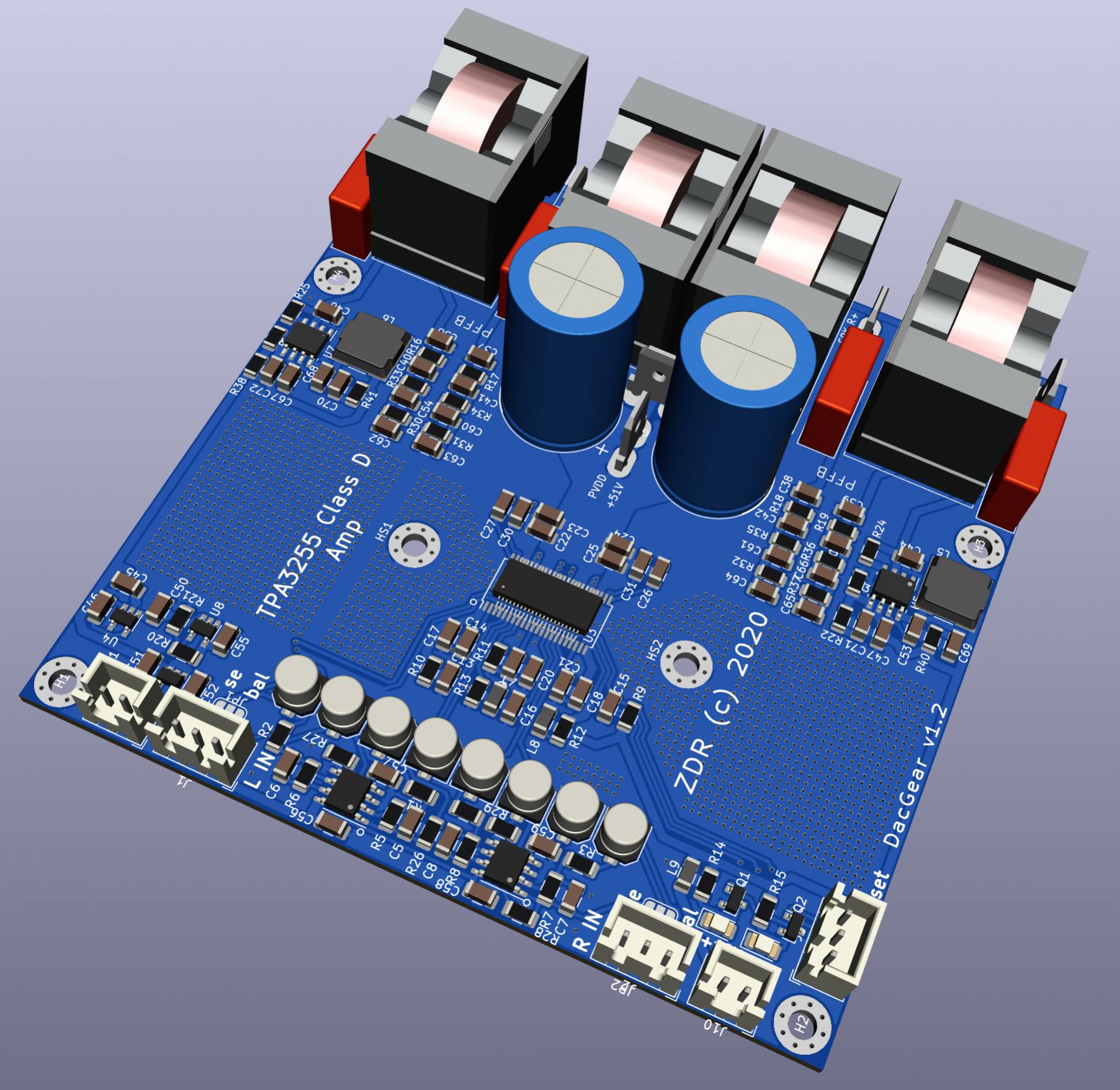

Compact TPA3255 design with PFFB and single PS
This amp definitely deserves and update, so here it is:)
Two LM5017 for 5 and 12V, should run much colder. Optimized space for original TPA heatsink
Don't tell me the speaker QD connectors are in between the power inductors?
1) I would strongly recommend making the board a bit longer and putting the connectors along the outside edge... and preferably Phoenix TDPT push-in (not screw) terminals instead ;) Two of these, for example, if going with stereo BTL only: 1017503 Phoenix Contact | Mouser Canada
2) Also, would be really nice if the input connectors were compatible with MTA 100? Those are my favorite low-voltage connectors.
3) Mounting holes should be outboard of all connectors, in order to avoid cantilevered loads. Especially if using QD connectors. A stubborn connection could put quite a large amount of force on an unsupported free end of PCB.
4) Are the mounting holes grounded? If the board is able to accept single-ended inputs, it would be nicer to have the mounting holes isolated in order to allow free function of a ground loop breaker circuit.
5) Are there connections for multi-board synchronization to avoid beat interference? https://www.ti.com/lit/an/slaa787/slaa787.pdf
ZDR

1) Need to keep it 10cm max in all directions. Keeps cost down.
2) link? Connectors are JST 2.5mm pitch, many other with same pitch should fit in.
3) I would like to, but I need to keep board small, 10x10cm max. You can always use angled faston, so that pulling force is horizontal instead of vertical.
4) Mounting holes are isolated. Board can take SE and balanced inputs.
5) I will check it out.
I added a connector that exposes two OSC pins for master/slave operation

6x Edge holes Isolated from earth as in leaky voltage run in circles with no escape by design?
What does this mean? Like it would be better to have them act as antennae? (that's a joke)
There is still (at least) one 0 V reference on the board even if the mounting holes are isolated, you know. For example, 0 VDC on the incoming DC power, and "common" (also 0 VDC) on the incoming signal(s).

Very nice amp! Congrats. Can you give more details for your distortion measurement? The TI PFFB app note quotes one of the reference conditions of 10Wrms BTL config with a 48v supply with 0.0021% THD. So if your measurement is at 10wrms and you get 0.0016% beats that. It comes down to layout and quality of components. On my amp with PFFB, I managed to get 0.0011% THD for 10wrms.
837048d1587662608-tpa3255-reference-design-class-amp-gb-tpa3255-v002-10-0vrms-10ohms-fft-pffb-victors-osc-jpg
I think the big SER29X Coilcraft falt copper wire inductors and the layout play a significant role.
I was just asking for clarity on how the 6 edge holes are isolated and how the 2 heat sink holes are grounded.
It wasn't clear to me. I'm not sure what the isolation holes and grounding holes do as designed.
Thanks! The measurement was done at 10W, 4.5ohm, 20V, Lenovo laptop PS. Passive components are cheapest AliExpress ones I found in the drawer, the coils are coilcraft knockoffs and there are even MLCCs at the amp inputs :)
PCB is also standard with 1oz copper.

That’s pretty good for cheap AliExpress parts. I am using 2oz copper, all name brand metal thin film resistors (Vishay etc), no MLCCs in signal path (Elna Silmic II 10uF), and real CoilCraft SER290x series inductors. I think the inductors make a big difference. So the quality parts do help to bring down the distortion vs no name parts.
