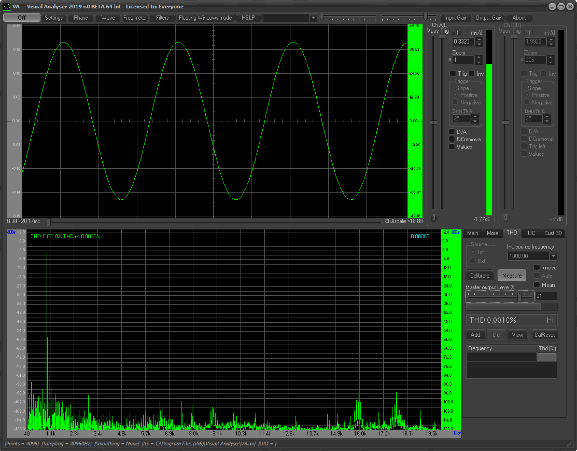

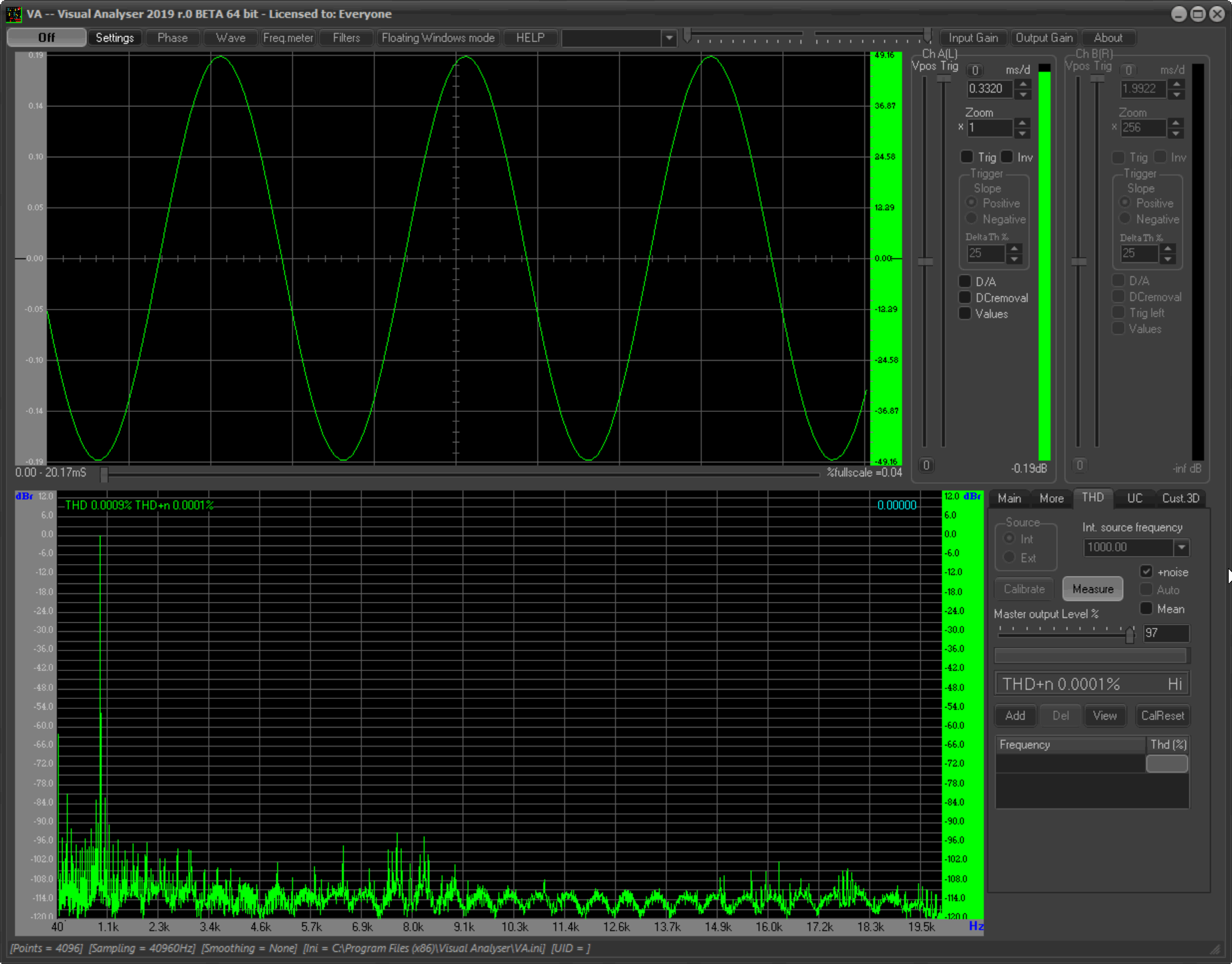

Played a bit with new version of the board, new 48V power supply and new 120W 4.5ohm resistive dummy load. THD measured at 70W RMS calibrated.
