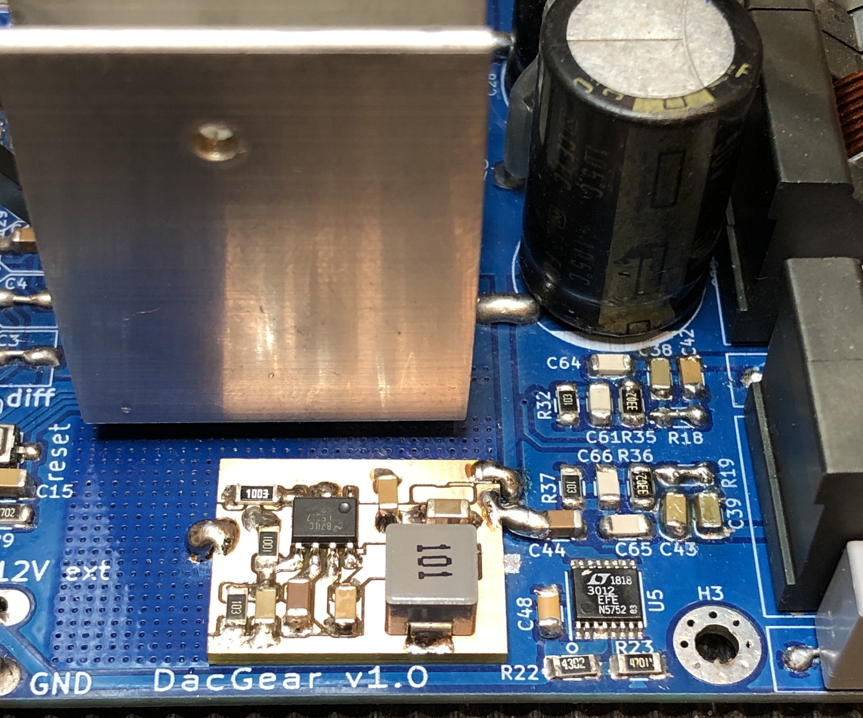

Thanks! Would you be willing to pay literally 20 times more for a pcb to have thicker copper and four layers, with no significant benefits to performance, if any at all? The most critical part for heat dissipation is around IC pins where there is very little space, and there is not much we can do about it. Further you get away from IC, trace widths expand exponentially and become less and less of a problem.
I am primarily designing boards for my needs so no need to thank me. If your needs align with mine, you are in luck 🙂
Totally agreed. I did my own 2-sided pcb-designs based on TPA3118 and TPA3155 that perform similar to TI reference boards. What improvements are to be expected from a 4 layer pcb? Even if THD would drop from lets say 0.003 to 0.001% - hey, this is totally academic as NOBODY on this blue planet will perceive the difference in a double blind test. Imho not worth the money at all.

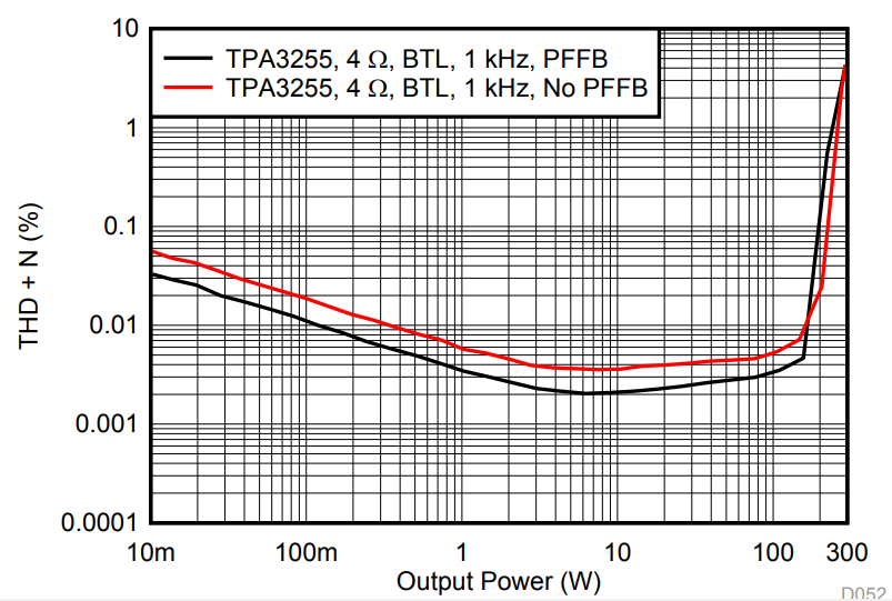

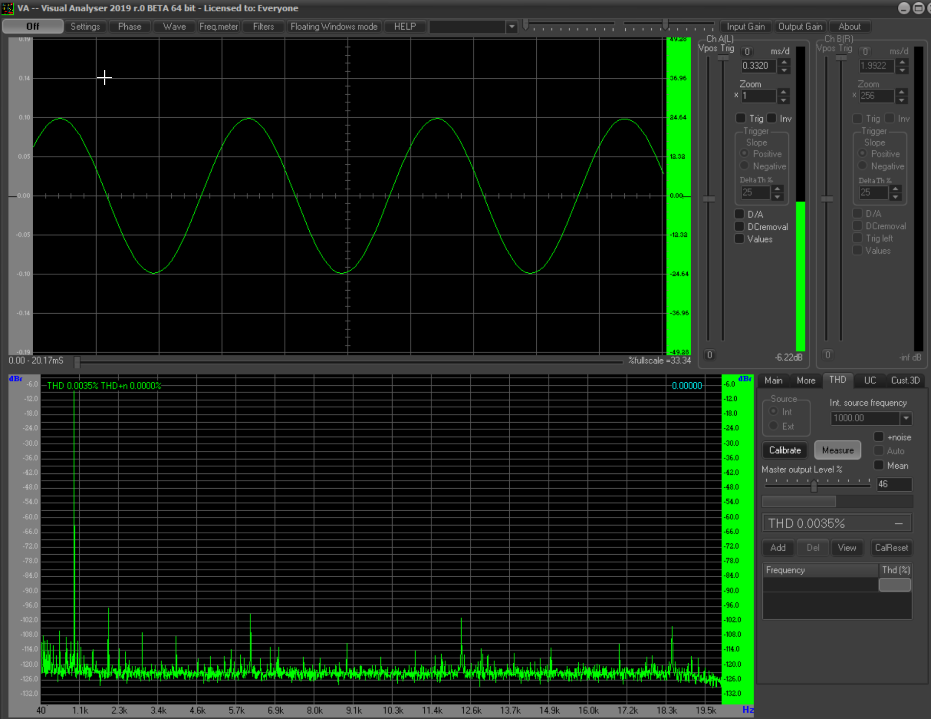

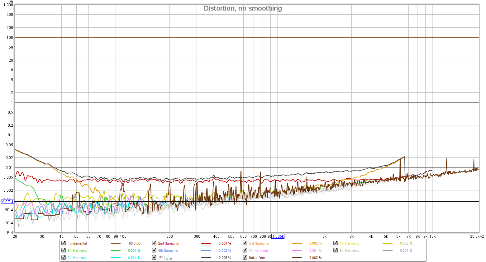

Very nice amp! Congrats. Can you give more details for your distortion measurement? The TI PFFB app note quotes one of the reference conditions of 10Wrms BTL config with a 48v supply with 0.0021% THD. So if your measurement is at 10wrms and you get 0.0016% beats that. It comes down to layout and quality of components. On my amp with PFFB, I managed to get 0.0011% THD for 10wrms.
I think the big SER29X Coilcraft falt copper wire inductors and the layout play a significant role.
TI PFFB app note quotes reference condition as 0.0021% THD+N at 4 ohms load, I think you are mixing up THD and THD+N. On your graph THD+N is 0.0035% at 10W at 10 ohms load.
Nevertheless it is pretty good performance for a soundcard measurement. Even QA401 with "the TPA3255EVM" can't achieve the datasheet's THD+N reference. It is a limitation on the soundcard and QA401's part. For sure you'll get better measurements on AP analyzer.
