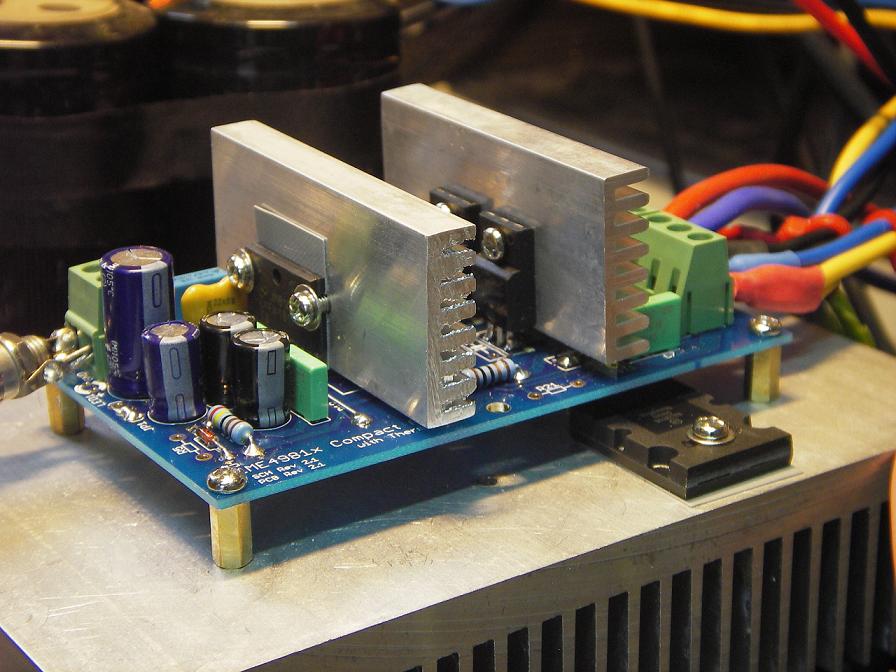

New Compact 4981x ThermalTrak board being made
I revised the schematic to include Vbe multiplier, two-pole compensation and ThermalTrak diode current by-pass. We now have many things to try!!!
The new board is being made. Here is the new schematic.

Hi Bas,
Good question! This is added for user to compare different bias schemes. I want users to have more fun with the new board. We can do simple bias with solely TT diodes, conventional Vbe without using TT diodes, Leach like Vbe with TT diodes, etc.
Panson
Hi Bas,
Panson

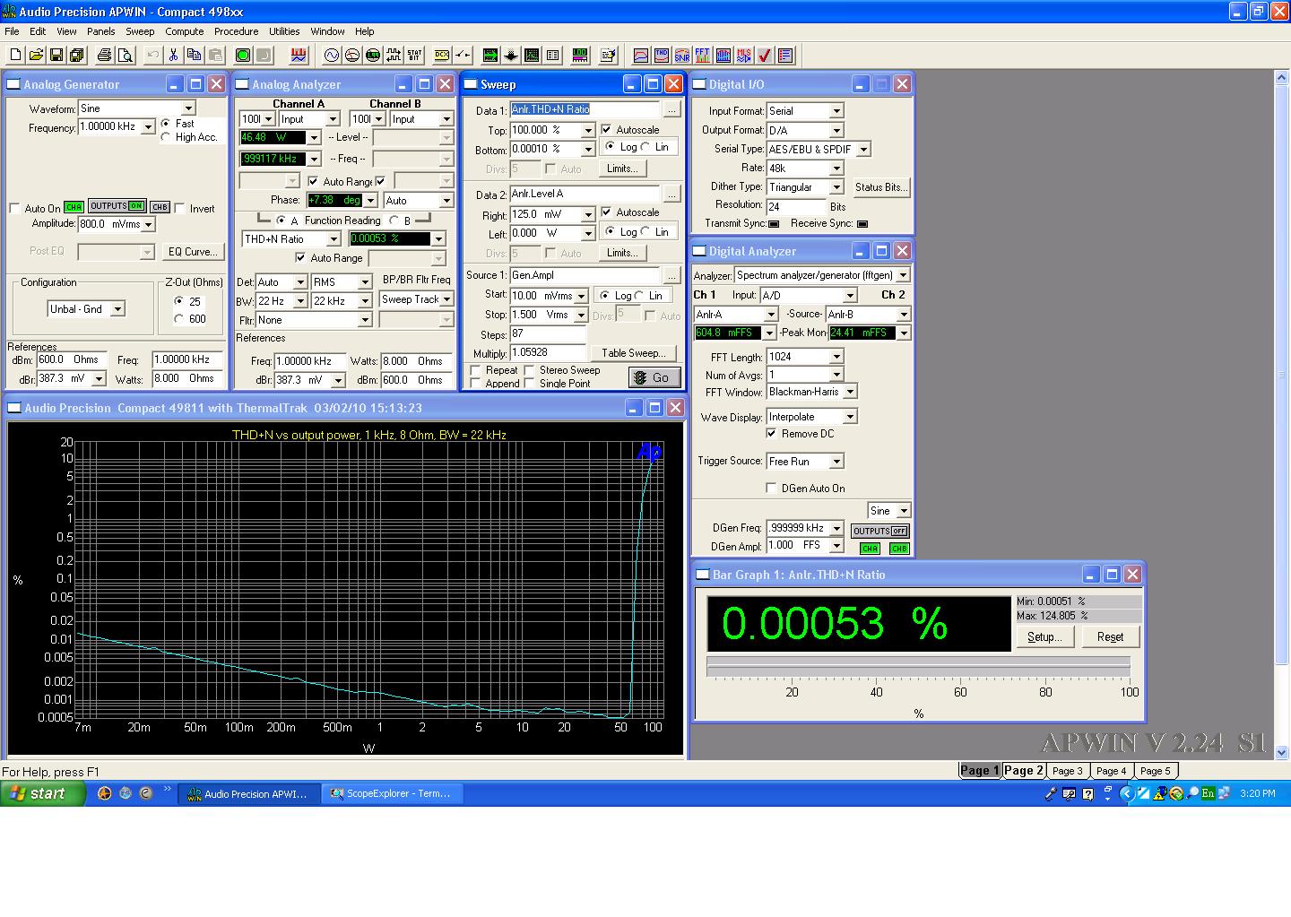

New boads back and tested. Super performance!!!
The new boards are back from the PCB house today. I just assembled one for LME49811 with single-pole cap = 22 pF. The performance is super!!! The THD+N for 1 kHz 50 W into 8 Ohm is 0.00053 %.
