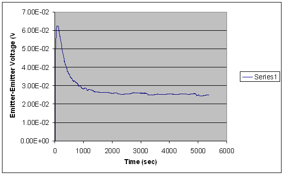

Thermal tracking exercise

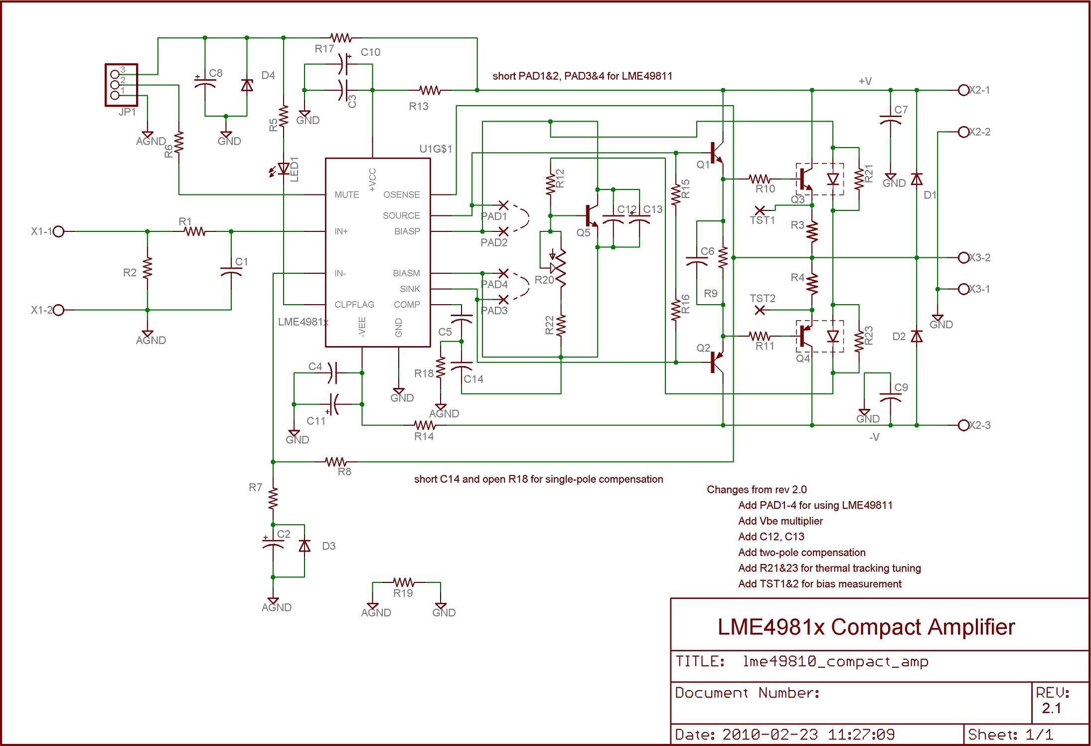

Here are some data collected recently for thermal tracking. The schematic is shown below for reference. Middle picture shows a TT with package removed. How thermalcoupler attached to the heatsink is shown in the right picture.
Initial bias target was 22 mA (~5 mV across Re R3/R4). NPN side was measured. For Case 3, both N and P of TT BE and diode were measured. The P side is consistent with the N side.
Case 1: R12 and R22 shorted.
Over-bias is due to driver Vbe decrement. We might increase the TT diode tempco. Here, I take another approach by tracking the driver temperature.
Case 2: a MJE15030 "diode" inserted at R12 and mounted on the driver heatsink.
Over-bias issue is slightly mitigated by using the "diode" to partially compensating the BE tempco.
Case 3: two MJE15030 "diodes" inserted at R12 and mounted on the driver heatsink
Over-bias issue is further mitigated by using two "diodes". Further improvement is still needed.
Comment please.

Panson: I agree, having the bias shift by 7x from turn-on to fully warmed up is an issue. My LME49811+STD03 amp changes from 27 mV across 0.44R at turn-on to 42 mV across 0.44R at fully warm. So 30-ish % change. Attached shows a bias measurement I took on a commercially available amplifier. This amp uses three pairs of output devices with 0.22R emitter resistors. I'm measuring from emitter to emitter from start-up of the amp and 90 minutes out. Just for reference.
The ON Semi devices, as you have verified, contain a separate diode and transistor mounted in one package. From your measurements, it seems the two have quite different tempcos. From your data (case 1), I calculate:
TT diode tempco = -2.59 mV/deg C
TT Vbe tempco = -1.63 mV/deg C
As the STD03 supposedly uses a diode that's integrated on the same die as the BJT, I would expect their tempcos to be identical but I haven't measured this. The STD03 is also 3~4x the cost of the ON Semi devices.
Anyway.... What to do about your circuit. You have three tempcos to keep track of: Drivers, output stage, and TT diodes. The drivers work out to be -1.54 mV/deg C - about the same as the output devices. But the TT diodes are quite different. Off the top of my head I don't see an easy way to change the tempco of the TT diode to match that of the output device. What would be interesting to try, though, is a Vbe multiplier using one of the driver devices mounted on the main heat sink. That kinda defeats the purpose of using the TT devices, but you should be able to get good performance, I'd think. In any event, your thermal sensor (TT diode or Vbe multiplier transistor) must be connected thermally to the main heat sink as the main output devices are the ones that need protection. Unless... Unless you use a CFP output stage (see Douglas Self's amp design book).
~Tom
~Tom
~Tom

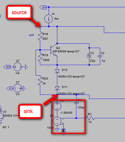

Tom,
Yes, I will try Vbe multiplier later. Thanks for your advices.

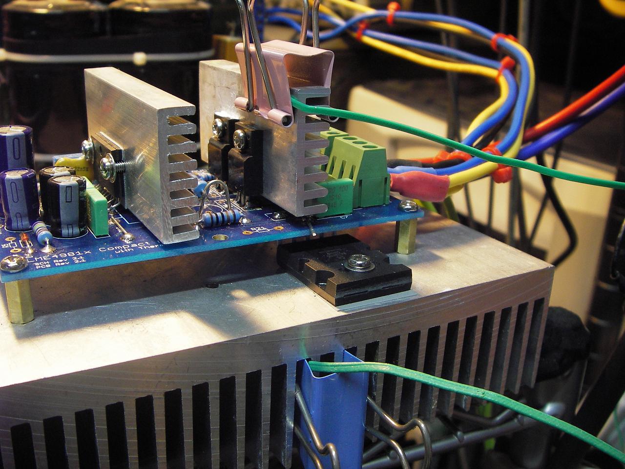

Out of curiosity, I put the two 15030 diodes on the main heatsink, similar to your suggestion. Since the main heatsink is hotter than that of driver, I can effectively increase the overall bias tempco. It results in a very stable system. The Re drop varies from 5.x to 6.x mV.
Panson,
I keep going back to Cordell's solution to this issue. If you vary r19 and r20, you can tune the tempco of the TT diodes to match that of the output transistors. He has a chart for appropriate values for r19 and r20. If you're interested I can dig that up for you. Cordell suggests that the Vbe transistor be mounted on the same heat sink as the driver transistors to add a level of thermal tracking to the driver transistors. The mur120 diodes in the schematic represent the TT diodes for the amp.
Ken
Ken
Panson,
Ken

I measured my voltages as follows for the Cordell bias scheme with the 1.52 sensitivity - 3k/2,213 resistor combination:
Re resistors are 0R2
Main 30C
Re 5.5mv
TT diode 510mv
TT BE 594mv
Main 59 C
Re 6mv
TTdiode 465mv
TT BE 565mv
