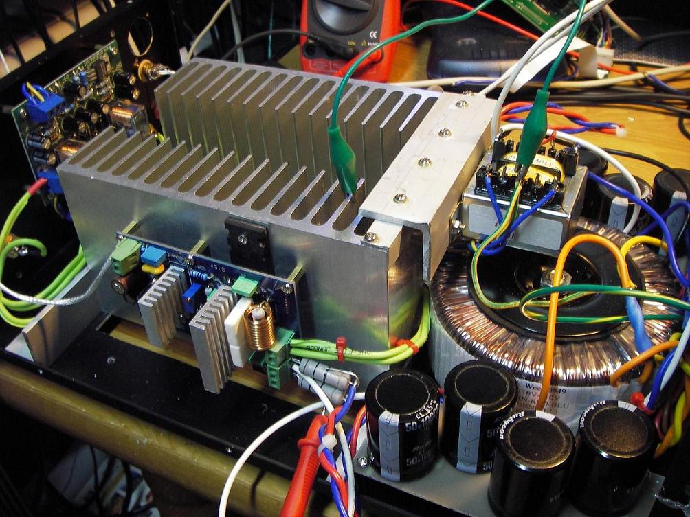

Janneman,
Thanks for the help. I ended up rebuilding it completely and am now getting bais, this time too much (0.93v emitter to emitter), but, have worked out with the simulation what my resistor values should be. I will try the new resistor values this evening. I'm trying to implement Bob Cordell's Thermal Trak bais scheme.

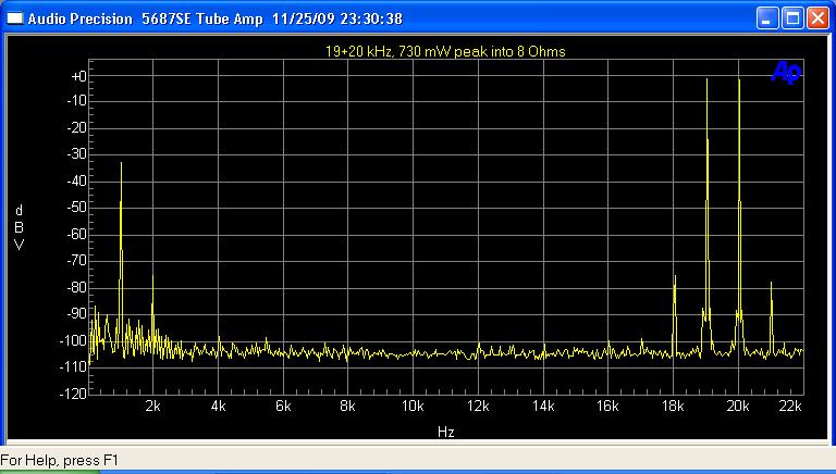

19 + 20 kHz IMD spectrum
IMD is said to be more important for indicating sonic performance. Here is an FFT of 19+20 kHz at 80 W peak into 8 Ohms of the Compact 49810 with ThermalTrak. The corresponding IMD is 0.001 %.

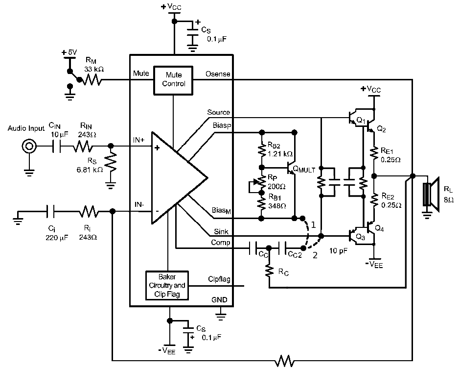

I meant something like this:
attachment.php
The value of Cc would be as in original design, Cc2 should be 5 to 10 times Cc, and Rc is determined from R=1/(2*pi*f*(Cc+Cc2)) where f is the frequency when the circuit slowly reverts to a conventional and safe scheme.
I have drawn two ways to apply this compensation. The first way (1 in schematic) is more conservative and includes VAS only, where the second way gives less THD, because it includes the predrivers also, but can have more problems with local stability.

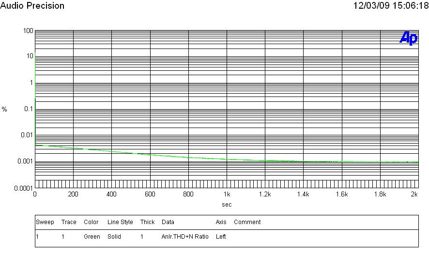

THD vs time from cold start
Output at 18 W into 8 ohm. THD vs time from a cold start. It takes about 20 min to reach the min. THD level (optimum set point).
Bias scheme: Two ThermalTrak diodes in series with a 1 k pot.

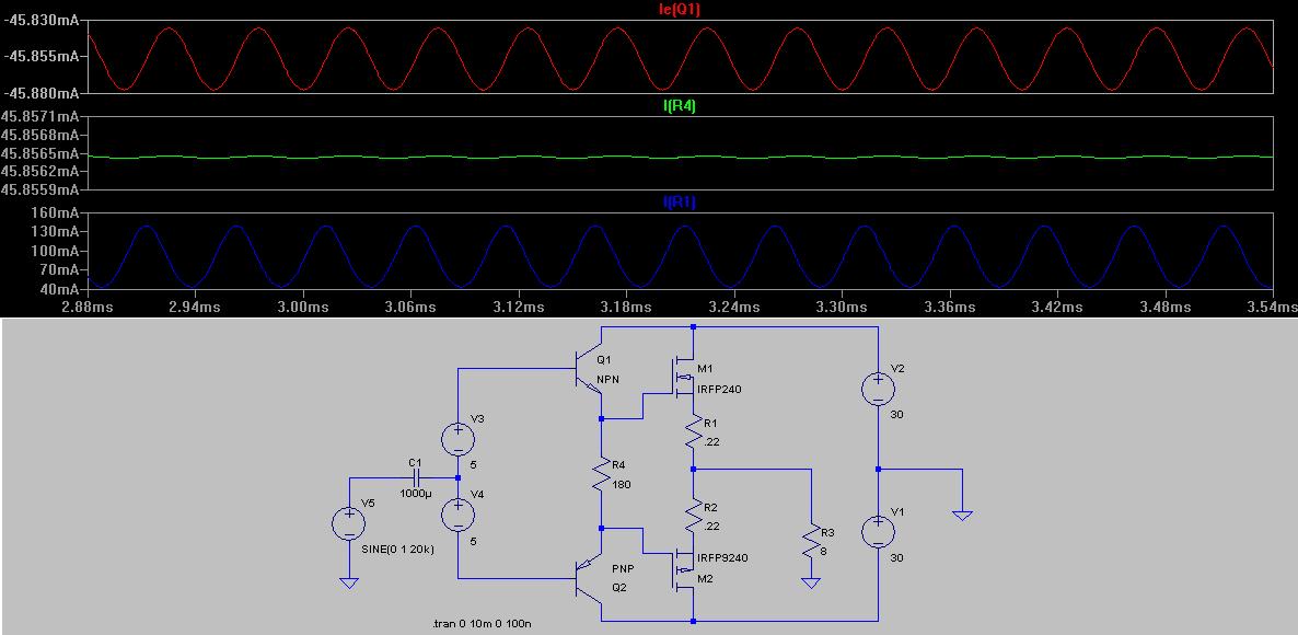

When using a driver like mje15030/31, in my case pushing 3 set of irfp240/9240, is there a rough calculation of how much the drivers should be biased to? Or is it an adjustment by monitoring a scope ? With 53volt rails, and 400 ohms strung from 15030 emitter to the 15031 emitter get 7.39 volts for about 18mA. Seems that voltage is fixed based on how much biasing the output stage, ~150-200mA I am using. Then the bias current through the driver just manipulated with that resistor since the 7.39 for me seems fixed based on that power stage bias choosing.
Just wondering if there is a rule of thumb...
Hi traw,
We shall bias driver in class-a, i.e. the current never stops. Since you are using MOSFET output, you don't need to worry about the current value for class-a operation. The driver is always in class-a mode.
The simulation confirms that gate current is so little to pull driver output of class-a mode.

I guess the thing i wonder is how much current should I run through the driver? Your sim seems to show 45mA. I am currently using about 18mA with 400ohm R4. I started with 200ohm R4 and was at 36mA and mje1503X devices were getting quite warm (have slip on to220 heatsinks on them). Not sure if should drop down to even lower mA by increasing R4 or need to have more current running through - ideally little as needed to do the job and most performant of course. thanks
I do like the sound using driver with the IR mosfets better than driving straight off lme, using lme49830 though.
45 mA in the sim is just an arbitrary value. The main point is that the current is practically constant. You can set it according to sonic performance and heatsink requirement.
